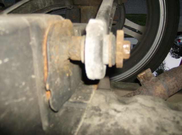

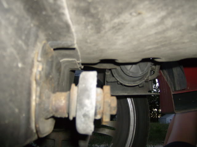

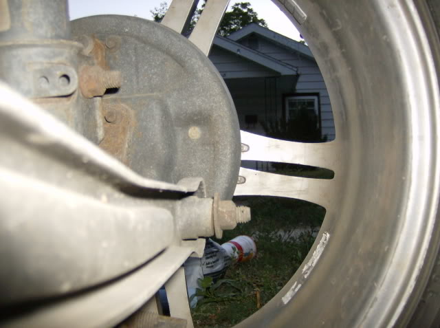

Ok, I finally crawled under the ride today took pics of the bushings:
Size:  34.8 KBInner Left side
Size:  32.1 KB Inner Right side
Size:  44.0 KB Outer Right side
Not really sure what to look for, whats good/bad/missing?

quiet hupcaps....wait crap, you got rims....ok fine, quiets fancy boy. j/k izero. Not sure ricerchick, my guess is that they look ok. But i truly have no idea

They look ok to me, although it doesn't hurt to replace them with the urethane ones if you have 170 bucks laying around. How did the struts look?

Struts look fine. Don't really have 170 laying around tho seeing as how I will probly need to replace my slave cylinder now and still need to fix the transmission axle seal.
in this pic here it looks like the plate that holds the bolt might be seperating from the unibody. i would check that to see if it has play. you will have to jack that side up and grab hold of the tire and have someone else look under there to see if it moves when you move the tire up and down.
also. check to see if theres something rolling around in the spare tire well.
also. you might wanna pull your drum off of that side to see if somethings loose.

Fun, fun and more fun XP
Well I know the plate is loose on that side and needs to be welded on better. Its scewing up my alignment on that one wheel. I'll try the other suggestions tho, thanks!
