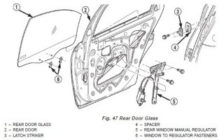

Hey i need help!!!
I had to break my rear passenger glass out recently. I found a replacement glass for 25 dollars at a local salvage yard. Can somebody please give me instructions on how to remove the glass and install the new glass in my car?
Old Oct 30, 2009 | 06:48 PM
neisg1's Avatar
neisg1
Joined: Jan 2007
Posts: 401
From: Canada
Default Rear door glass
REMOVAL
(1) Remove door trim panel and inner belt weatherstrip.
(2) Lower the window to 50 mm (2 ins.) from bottom
of travel.
(3) Loosen bolts attaching rear lower run channel
to inner door panel (Fig. 47).
(4) Remove rear run channel from door.
(5) Loosen screws attaching window regulator
channel to glass.
(6) Slide channel rearward to allow screw heads to
pass through key hole slots in channel.
(7) Remove glass from roller channel.
(8) Lift door glass upward out of the opening at
the top of door.
INSTALLATION
(1) Lower door glass through opening in top of
door and into position in the window regulator.
(2) Position door glass onto roller channel.
(3) Slide roller channel forward to allow screw
heads to engage key hole slots in channel.
(4) Tighten screws attaching window regulator
roller channel to glass.
(5) Install inner door belt door trim panel inner
belt weatherstrip.
(6) Operate window and check for interference.
Adjust glass as necessary.
