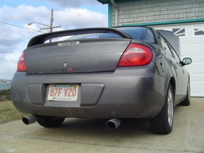

My SRT exhaust never touched my bumper on my '03. Never melted or discolored the paint either. I did have to bend one of the hangers to make the tail pipes sit even though.

Wow, interesting!
