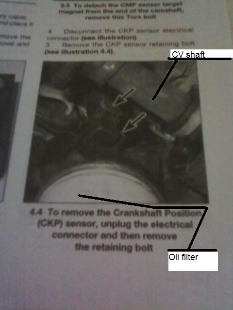

Straight from the Haynes manual.
1. Disconnect the negative battery cable.
2. Raise the front of the vehicle and place it on jacksatnds.
3. On 2003 and latter models, remove the structural collar.(i have no clue what that is is say reference oil pan removal and installation I'm assuming some type of skid pad or brace.)
4.Disconnect the ckp sensor electrical connector.
5. Remove the CKP sensor retaining bolt.
Seems easy to me, I will try to add the pics in a minute.
Old Feb 2, 2010 | 11:30 PM
The Black Stig's Avatar
The Black Stig
Joined: Jan 2010
Posts: 85
Pic's

Thanks for all the info everyone, the pic helped out alot and with the sencor in hand i figured it out and saved myself 80$...again thank you.
