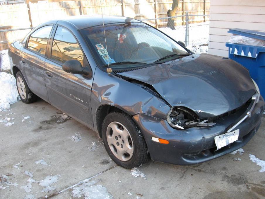

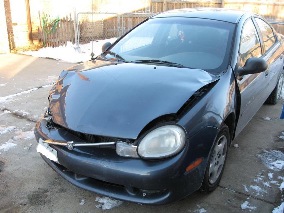

My Daughter's car a 2001 Neon SE was Crashed into By a Jerk with No License or insurance . Thank God She is ok . I would Like to Know what Year Front End's will Fit this Car ?

they all will fit, but if your putting on a new SX style front you will need
hood
headlights
bumper cover
which is no big deal as i see the hood, bumper cover and 1 headligt are already mashed
fenders are the same no matter what year or style

And what Year did that SX Front End Come out ? I just want the Stock Looking one . I know there are some 96-99's out Here in our Local Junk Yard in IL .

I Popped the Hood on this car Today . The inner Fender was Smashed into the Power Steering Pump and also Broke it . Waiting on some warmer weather to start at it For now I yank out the Battery and Covered the Front of the car .

you can use the front from any neon 2000-03. If you change the headlights you can use 03-up. Since you have to change one light anyway, you have some options. The bumper covers have different styles depending on the year, options, ect.

anything from 95-99 wont work in your daughters car

yea, I think the Canadian guy confused him...unless he is also from Canada
there is no SX here in the states... he just needs any front clip as long as it's from a 2000 to a 2002 model..any model
I thought the Canadian SX was equivilant to the U.S. SXT...which wasn't named that untill 2003.... which down here, wouldn't work

up here they started calling them SX or SXT's when they went away from the chrome bar grille (03 I believe).
they arent even called dodge's up here as of 2000 in Canada they tried to call all the cars Chryslers(didnt last too long), think by 03 they were back to calling them dodges again
