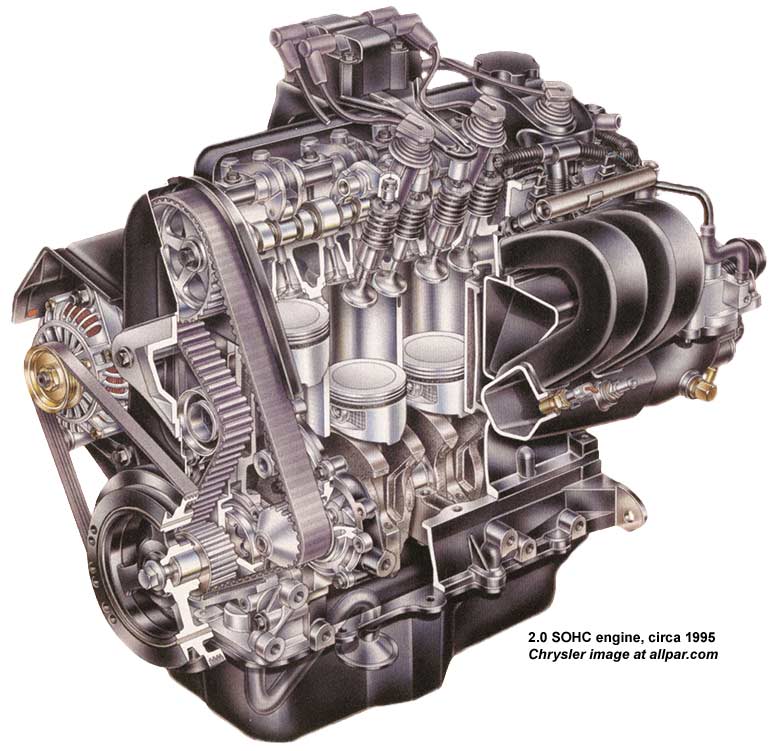

Looking at this picture, the rockers are roller, so I can't see a cam lobe wearing down in such a short amount of time.......
well, I'll know tonight.

I took off the valve cover again tonight and removed the rockers. They all look good, they are roller and look great, the cam is fine too. All of the valves look closed, no damaged springs, everything looks good on the top side.
I picked up a compression tool and simply pumped up the cylinders with air, 1 2 and 3 were fine, help 150 psi. #4 however would not hold any air, clearly a leak in that chamber. The air continously flowed out.
If I had to guess, sounded like the air was maybe going in to the intake which means a damaged valve on that side.
I'll pull the head tomorrow and see what the problem is for sure.
