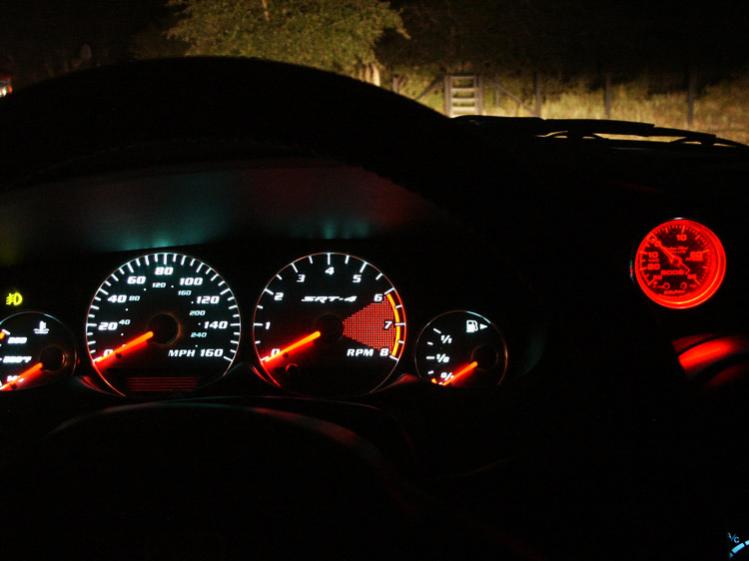

This is a picture of LSP's car with the cool white WLED-x5 bulbs in it:
I can't ever get a picture of mine to come out correctly, color-wise.

HVAC controls require a neo-wedge bulb. Size depends where you buy them from and what LED it is. Shifter, glove box (if you have one) and license plate light are just a straight bulb change; the bulb sits in a socket. Some dome lights have a regular bulb and others have a festoon. There are three different dome bulbs that I know of. Why three for the same thing? No idea. To change the mileage requires a translucent film. The downside to adding a film to the mileage is it makes it difficult to see during the day. As you can see in the picture, it's fairly dark even at night.
