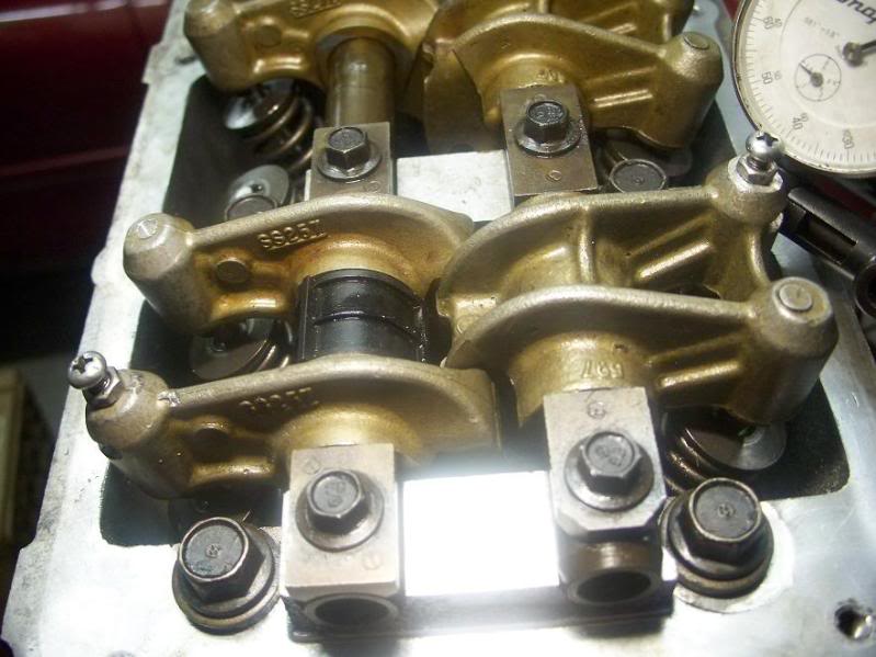

Check this out
http://www.youtube.com/user/CuzIAmTh.../7/dwv5WRrpmPc
So basically he was simulating a very high lift and duration cam.
Doing this required 2 1gn valve covers welded together for clearance reasons
Old Nov 19, 2011 | 09:41 AM
brhodes's Avatar
brhodes
Joined: Oct 2011
Posts: 195
Looking at the rockers he's...modified...that's pretty rudimentary compared to what I have in mind. I've bored out both of the sockets on the exhaust rocker I'm experimenting with and have cut down the top so it's level with the top of the rocker arm itself. This took out the two oiler holes, but I'll re-drill these at the same angle, but at a lower position. I'll machine a bolt (round and polish the bottom, and cut an oil passage around the top) to use for a lash adjuster, and this should keep me from having to build a valve cover with more clearance. The only problem I foresee is finding a locknut thin enough to use on the bottom side of the rocker...I don't want it on top. I may find it necessary to cut some material from the bottom of the rocker so the nut will recess enough to clear the valve when properly adjusted.
I have no clue what that guy was attempting. The video didn't explain and it really didn't make much sense.
