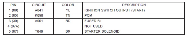

check the attached pic for reference (you may already have access to this info, just covering bases)
next thing i would do is dismantle the PDC, and start checking the wires of the start relay pinout (per attached pic) for continuity to verify there are no breaks. beyond that, i would double check the wiring related to the starting circuit (ignition switch, start relay, starter solenoid, etc) if all else fails, yeah i guess it may be time for a PCM. i got mine off ebay, provided my vin and they programmed it, including shipping was like $160. works like a champ.
Thanks again for you replies!
Ordered a new PCM, should be here soon. I'll let y'all know.
