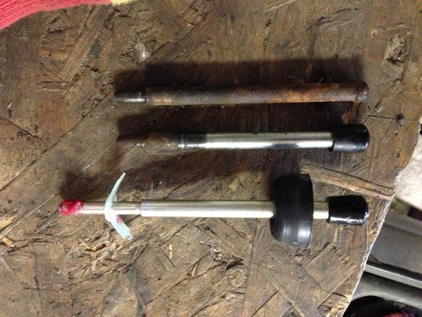

It is obvious to me that the slave is pushing on the fork when it shouldn't, but why? I used the slave mount/spacer/bracket from my '02. By checking part numbers (Autozone, Rockauto, etc) the transmission, slave, master, clutch, axles are all the same '02-'03. Is that stupid little slave mounting bracket different? The clutch was fine with the old trans.

The new slave push rod was waaay too long. Put in the old one and it works fine. FYI the new slave/master was a RhinoPac/World Car PN PS0519.
