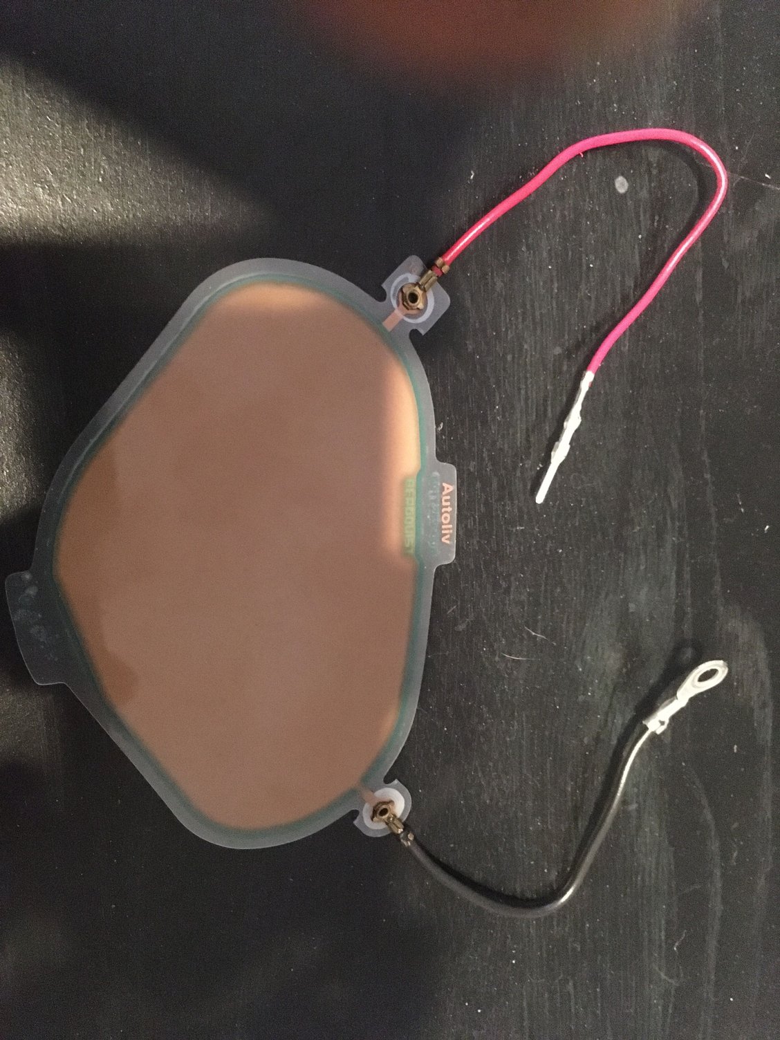

Old Feb 21, 2021 | 08:45 PM
Richard Feury's Avatar
Richard Feury
Joined: Feb 2021
From: North Carolina
Default Horn switch. Help!
I finally got around to troubleshooting the horn stuck on problem.
I removed the airbag, removed the horn switch and installed the horn fuse.
Horn does not blow!
Checked by grounding wire to steering wheel and it blew.
Does anyone have an old airbag that they can take the switch out of and sell it to me.
I can’t find a new one anywhere without purchasing a complete airbag.
Help
Thanks
