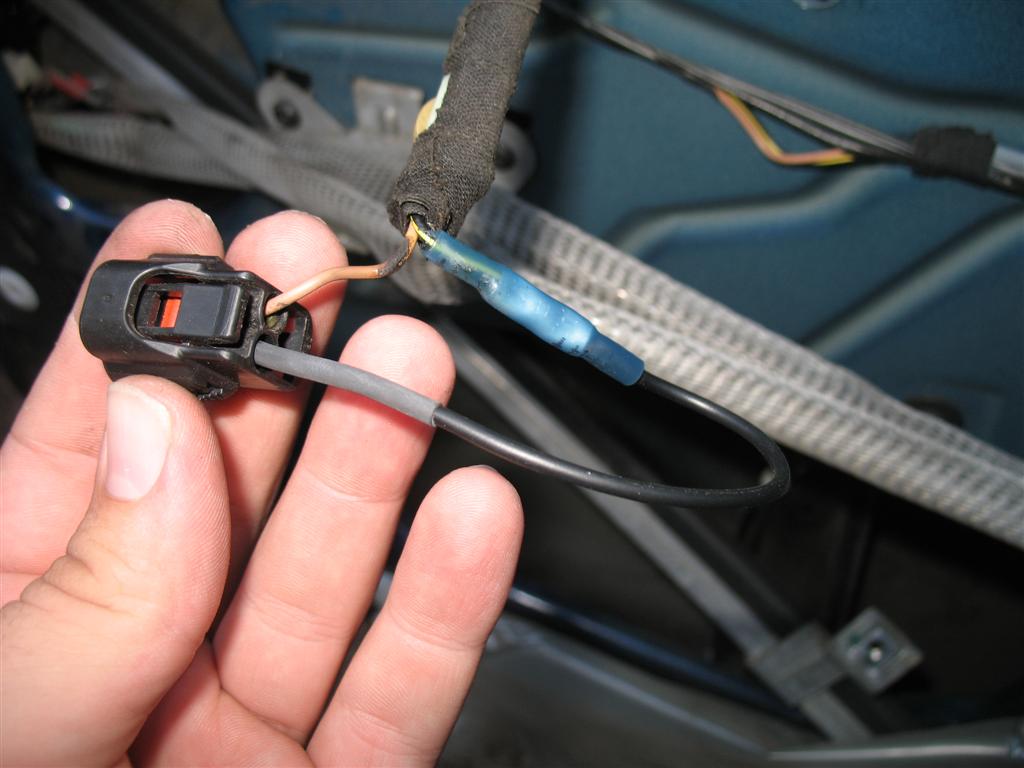

The wire on the door check strap might be broken:
The connector comes off of the actual door jamb latch mechanism:
Fixed:

Well I'm really wishing I would have taken pictures. But I took off the panel, and was surprised to find a plastic, barely transparent sheet covering the entirety of the door, not on the panel. Because of this, I couldn't actually see the sensor that was in your pictures. I cut the sheet where it looked like the sensor was, and found it. It looked in tact, but I wasn't able to get a good look at it, because it was connected to a small black box above it, and it wouldn't pull out. The box and the sensor would move maybe a fourth of an inch up and down, but not out of the lip of the door edge and into the opening.

First a correction: the door check strap isn't where this wire is. It is on the door jamb latch. But yeah, that black "outline" on my door was where I pulled back that sheet. The sensor is attached to the door jamb latch.
If you remove the two T30 bolts holding the latch assembly to the door, you can move it out and easily get to the switch connector.
