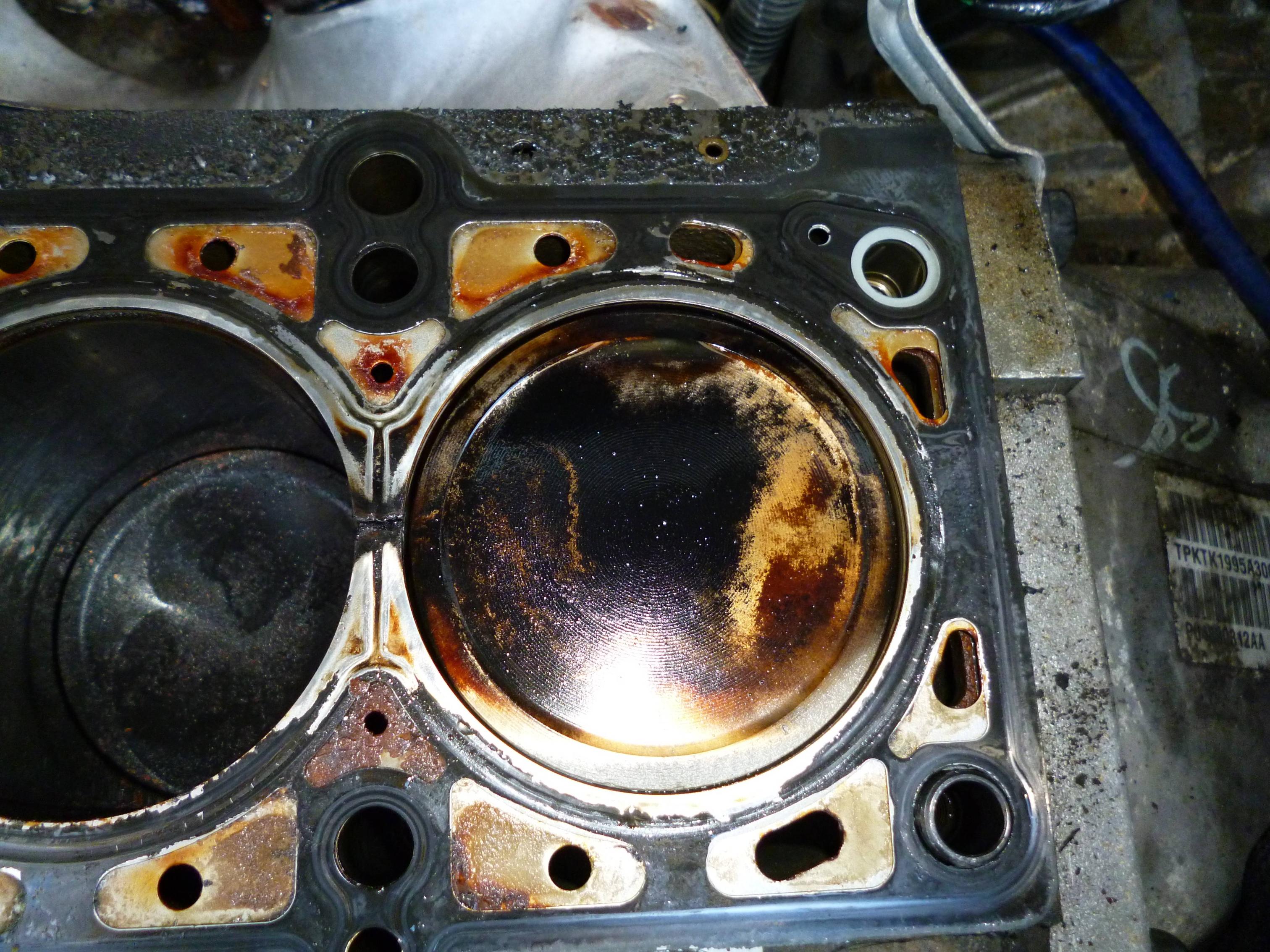

I've been experiencing almost exactly the same issue you seem to be describing here. Tapping/knocking noise, couldn't find exact source of it, eventually checked compression and had about 50% compression in cylinders 3 & 4. Also an '05 SXT.
Been working on pulling the head for the last few days after work, and finally got the head off earlier today. Found quite a bit of scoring between each cylinder, with a clear breach between the problem cylinders 3 & 4.
Here are some pics:
Here are some pics:
Thanks for the note SecuritronX. I got my head off last night and my break looks exactly like yours. Did you figure out what caused your break? My head had some pitting:

Not really sure what caused the break, but based on what I've been reading about Bosch Platinum spark plugs and Neons, I'm wondering if maybe that could be it. I had put Platinum +2's in awhile back and didn't change them until after I first noticed the symptoms. It seems some people have had issues with the platinum plugs and misfire/detonation issues in Neons.
As for pitting, I had nothing as severe as that; that really sucks.
I just had a burn mark between 3 & 4 that was fairly rough and scratchy. It may have developed into pitting eventually though.
No EGR on my car that I know of. Just PCV and make-up air hose coming off valve cover, I think.
For the block, I mostly used alot of brake cleaner and a brass detailing brush. Then I went over it very lightly with a machined steel sanding block (for guitar fret leveling) using wet/dry 1000 and 1200 grit paper and some WD40.
Probably not the wisest of ideas, but seems to have worked out okay. Checks out with a straight-edge and .004 feeler gauge, so should be alright. Definitely looks better than it did.
Probably won't know for sure until next weekend, as nobody around here seems to have the proper valve spring compressor tool needed; and I would like to change the valve seals and grind the valve seats before reassembling.

Very interesting on the spark plugs. I haven't read that. I put in Autolite double platinum 3923's at 97k miles (now at 122k. started knocking at 116k). So maybe that was my issue too. I cleaned my head and block with scrubbing bubbles and a brass pad and they both checked out with a 0.004 feeler as well. So my best theory is just that my head gasket blew and created a sharp edge in cylinder 3 that would pre-ignite the chamber it got so hot. Then the detonation caused the pitting, because I didn't find it fast enough. I knew it was cylinder 3, because I could replicate it with a torque stall and had someone pull the injector connectors one and a time. The test showed the knock stopped only when we pulled cylinder 3 injector connector.
As for the EGR, i figured out starting in 2000 they stopped putting EGR on that head. If you had an EGR, it would be mounted down and to the right (toward the rear of the car) of the cam sensor.
I get my new head Tuesday or Wednesday, so we'll see how it goes. I guess I buy some new plugs too
Any recommended plugs you found in your research?

It seems copper core is most recommended; most often NKG V-Power or standard Champions. Apparently platinums don't play well with the Neon's waste spark ignition system, which can cause them to wear prematurely and unevenly, leading to misfire issues. Double Platinums are supposed to be compatible, but some have had issues even with them:
http://forums.neons.org/viewtopic.ph...um+spark+plugs
https://dodgeforum.com/forum/2nd-gen...your-neon.html
Still probably a shot in the dark, but there does seem to be at least some supporting evidence.
Well I don't see anyone saying copper didn't work for them. So I'll go with that. Thanks for writing back!
