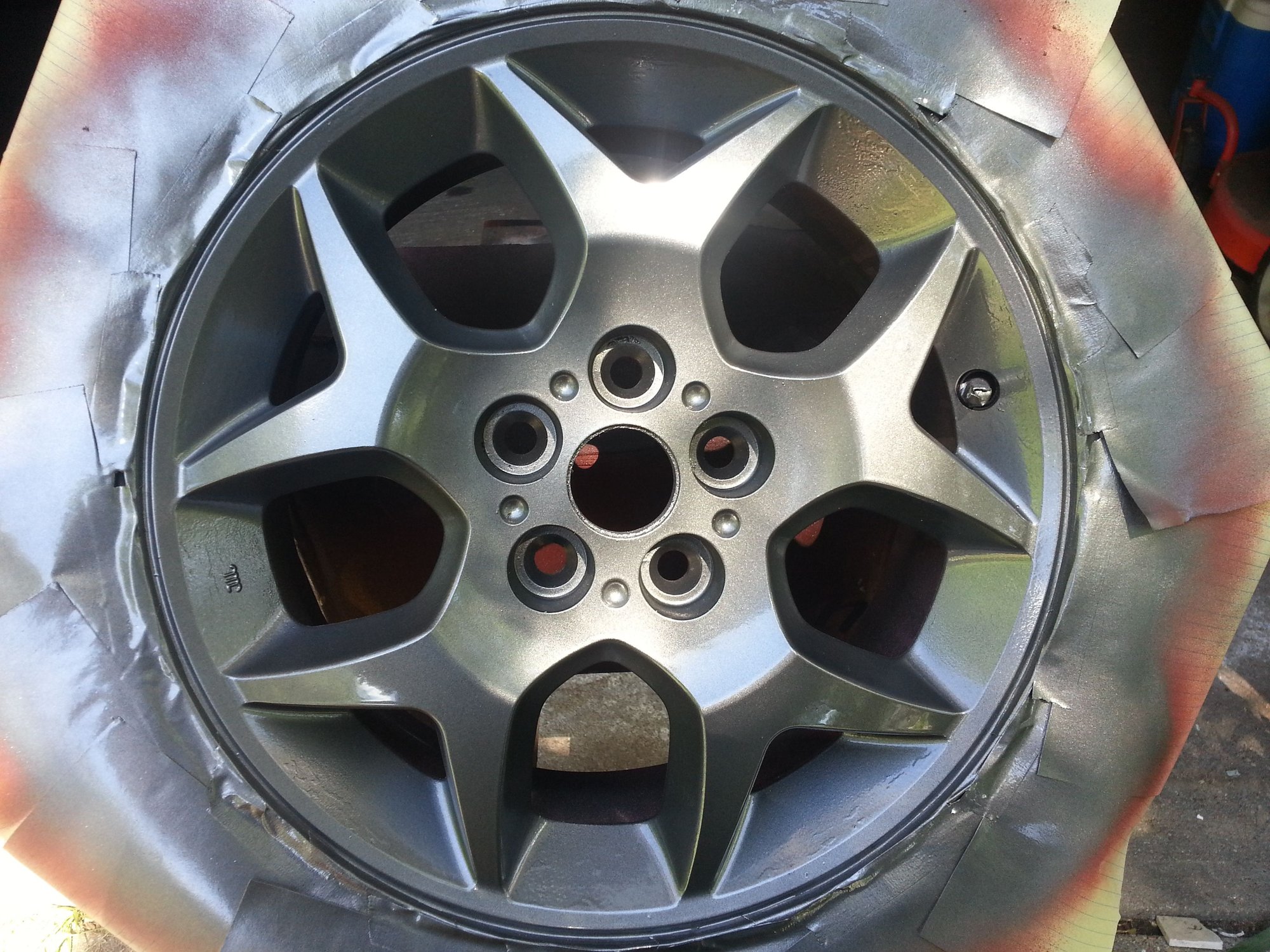

This weekend I completed refinishing my 2000 Neon wheels.
I removed all four wheels and applied paint stripper to help remove the factory clear coat.
I then sanded the stubborn areas and masked off the wheel. I left the very edge unpainted because I figure the next time tires are installed the paint would get scratched.
wheel masked off
I then primered the wheel.
Primed
After two lite coats and one wet coat of primer I let the wheels dry. I then started the graphite gray color from Dupli-color.
Graphite paint
Today I was able to shoot the clear coat on and that required a second masking.
with clear coat
Total supplies used:
2 cans filler primter
2 cans graphite wheel paint
2 cans clear coat for wheels
1 roll fancy $4.99 masking tape
1 roll $1.79 masking tape
small tablet of paper for masking the tire off
The paint directions says the paint will need to cure for 7 days. I am leaving the car on stands for the week and next saturday I will have the wheels balanced again and then I'll put them back on the car.
Just thought I would share in case anyone has tired looking wheels.

Looks good. Nice work!

It does look nice. Now it's time to tackle those headlights!

Looks good! Next time don't be afraid to paint the lip of the wheel. That's what touchless tire mount machines are for
