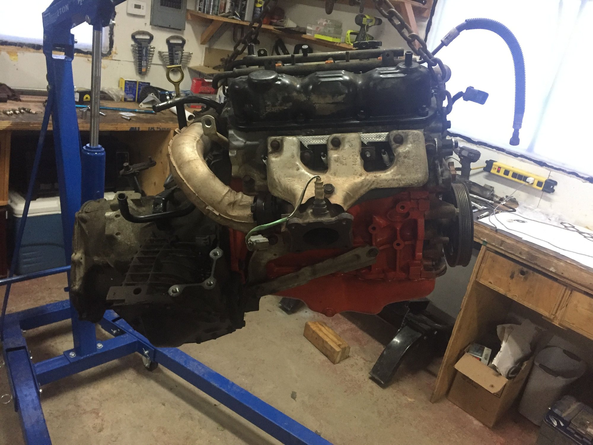

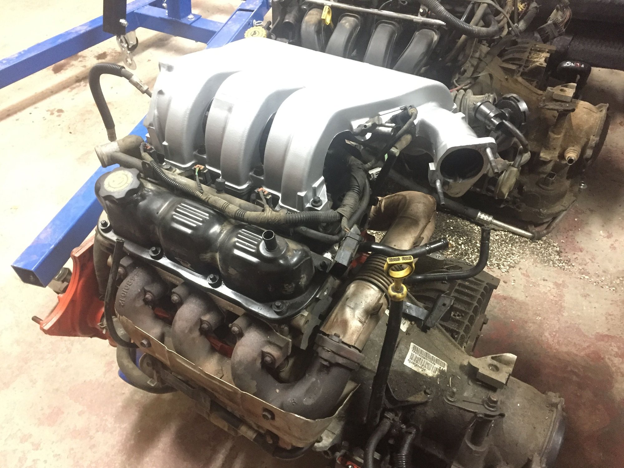

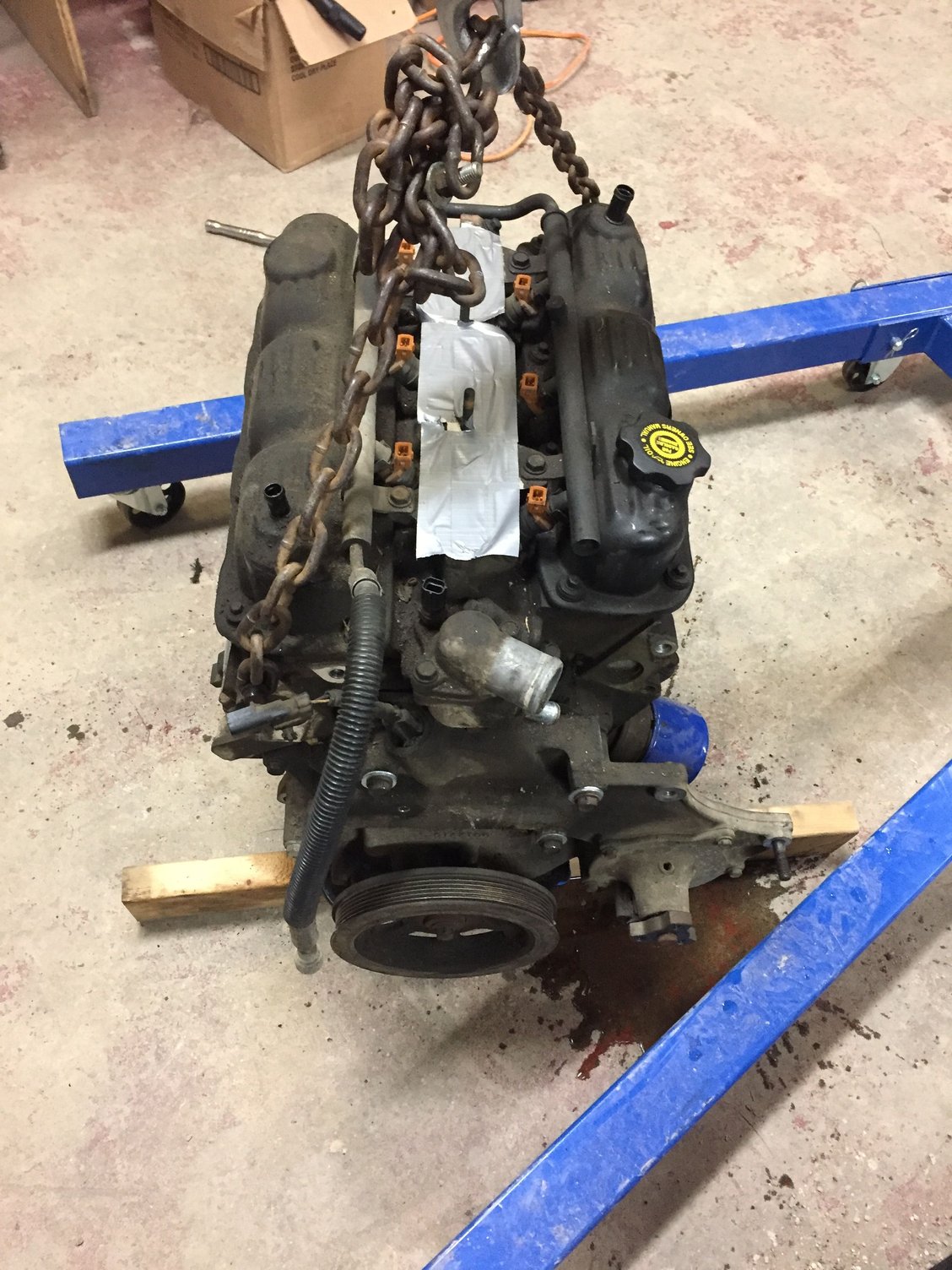

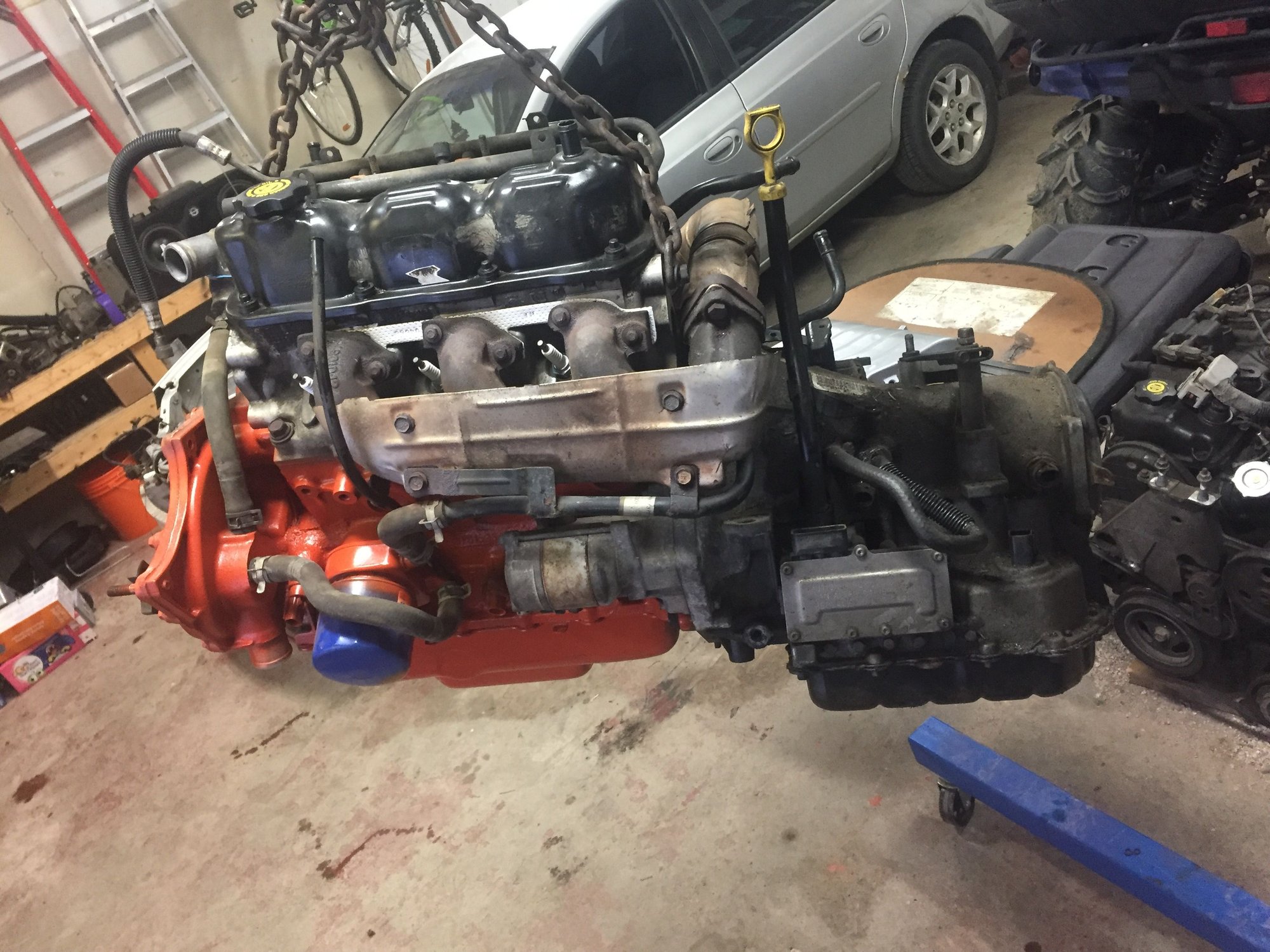

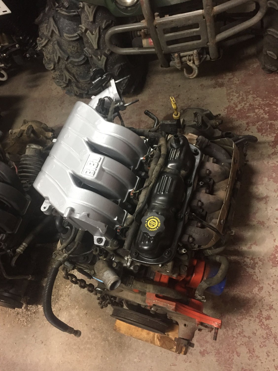

for that matter, i usually stick to trucks but i got a goofy project on my hands, i bought a 2002 neon super cheap for a commuter car to save the kms on the truck and just drive back and forth to work, couple months later water pump started leaking, so was planning on doing the water pump/timing belt and possibly head gasket over winter, so the car was sitting beside the shop for a bit and i was feeling an itch for a hot rod project, so i decided to make lemonade with the lemon i had, started hitting google and the forums looking for a cool swap for the neon, found that caravan engines can be swapped in pretty easily, found myself a good used 2000 grand caravan 3.8L that had been rolled but still ran and drove, had about the same kms on it as the neon, picked it up for $100, ripped out everything i needed or thought i might need and got $50 back when i scrapped the van, so the project is well under way and i wanted to bring you guys with me along the way, cuz in my searching i didnt find alot of V6 2nds gens many 1st gens so i wanted to post the info as i went for anyone else to try it, more posts to come! Pics of where im at now

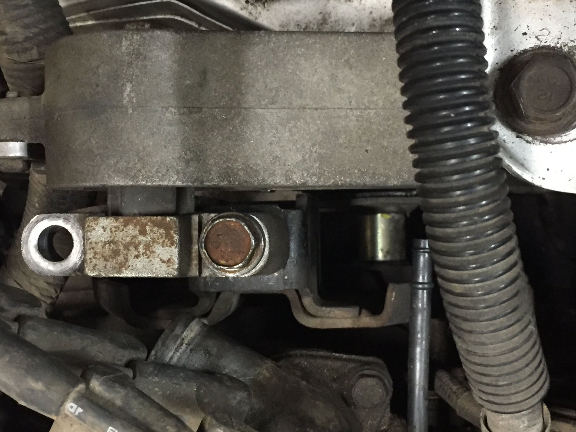

Finished final mock up, got 3 mounts holding it in so far, like my clearance and position, was able to swap over tranny mount from neon to caravan trans (direct bolt on) and i reused the front fender mount from the neon amd welded a mounting nut onto the 3.8L front bracket (will take a picture sometime), then i reused the upper front neon mount to the factory 3.8L front mount point, i have to do some minor modifacations to the intake manifold and throttle cable bracket and trans dipstick but i think i will be able to get the hood to close

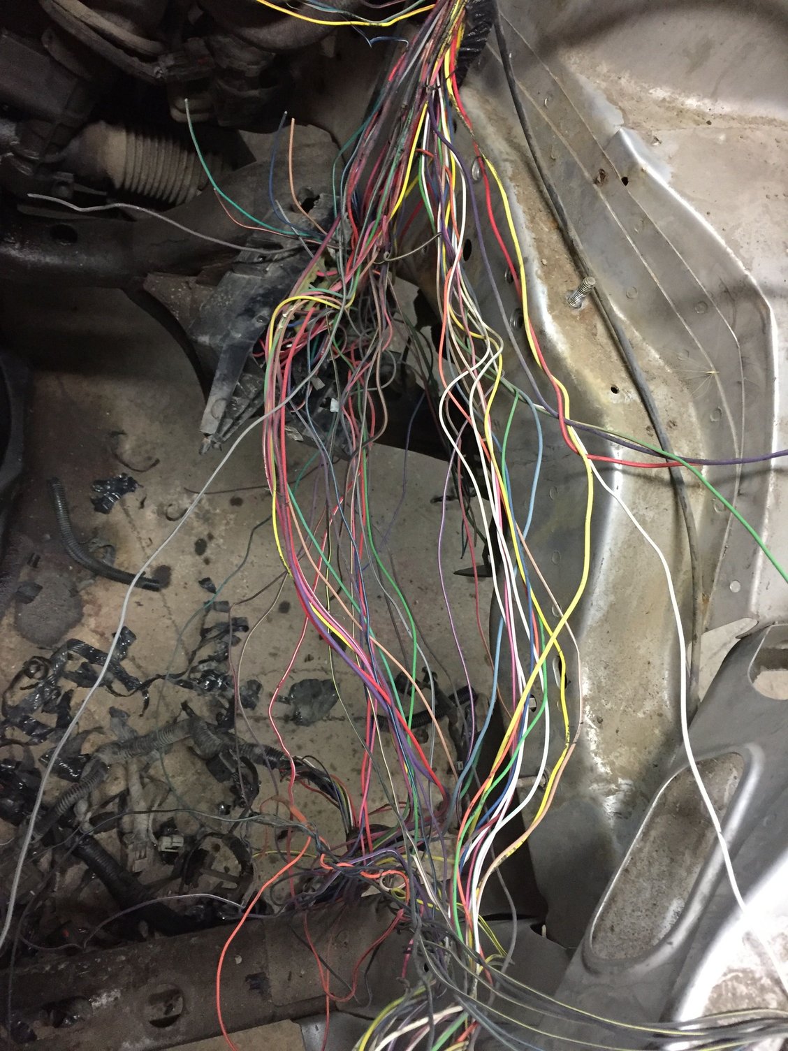

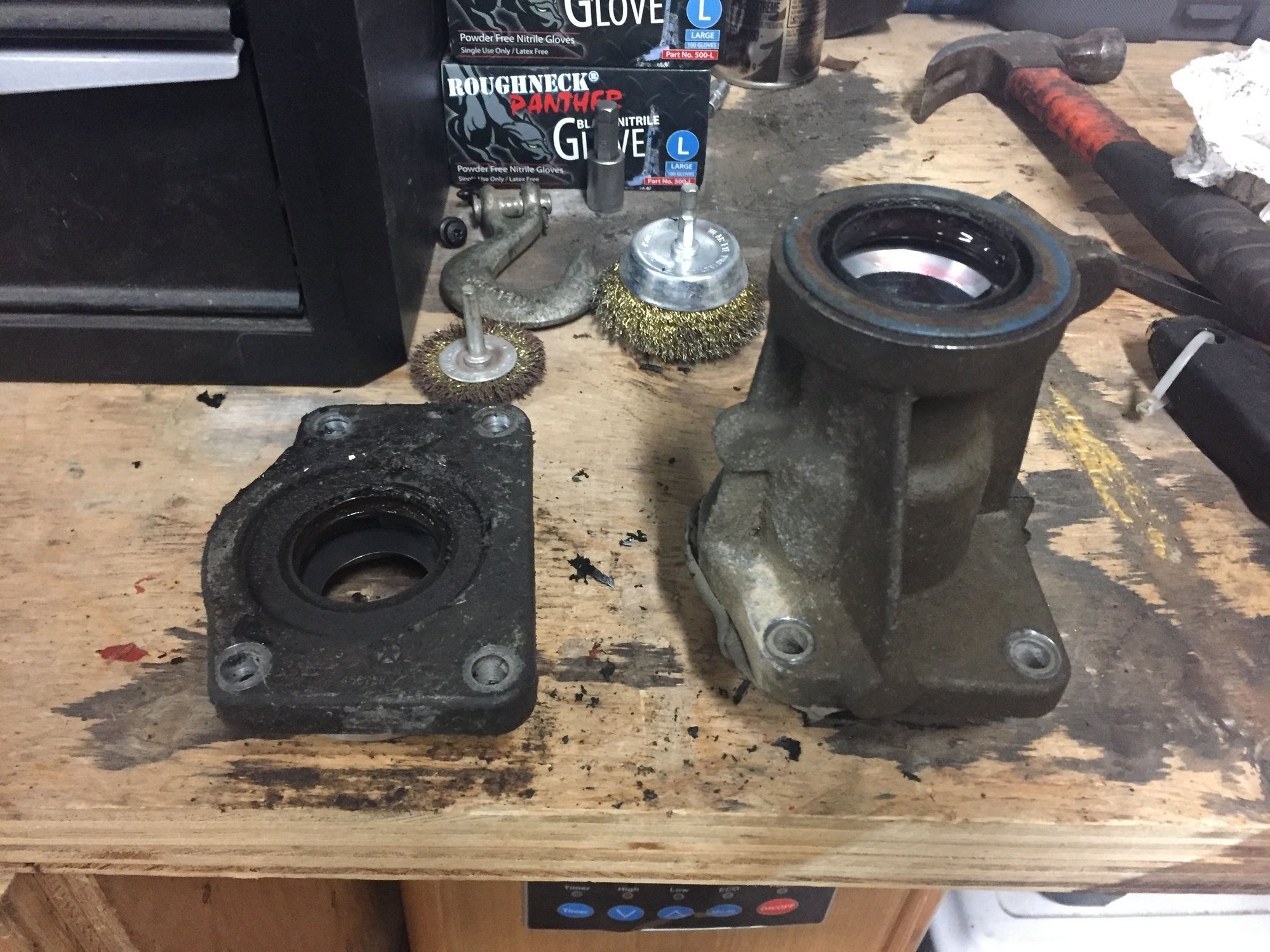

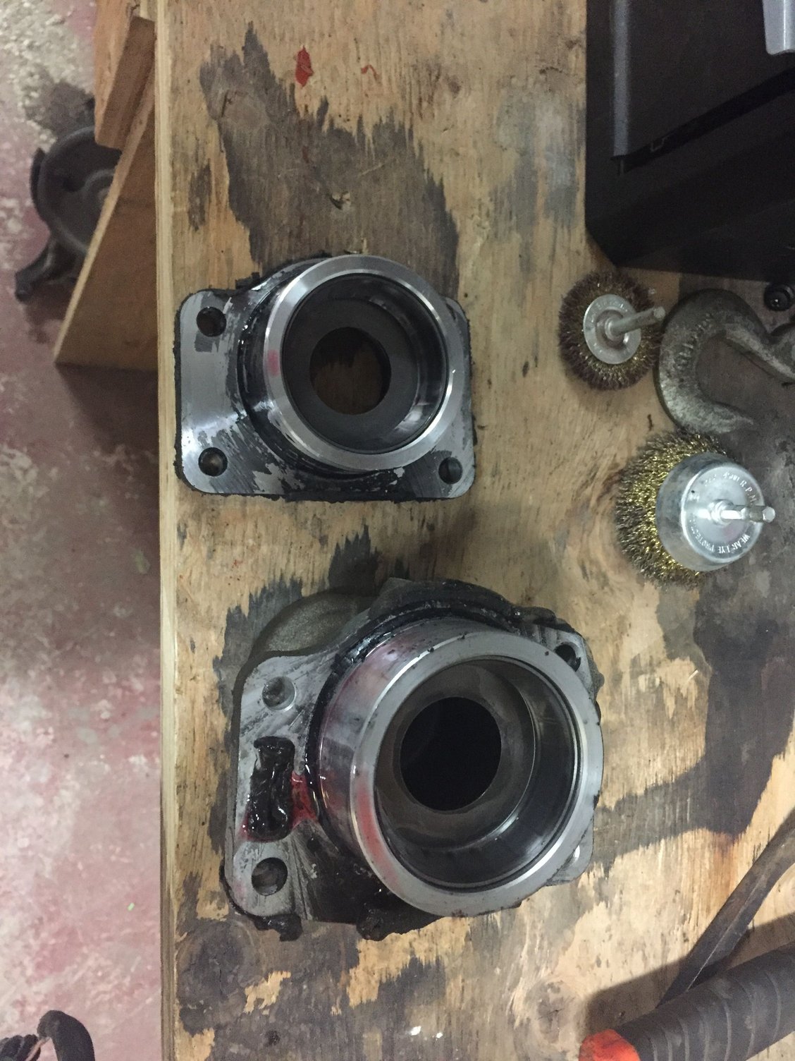

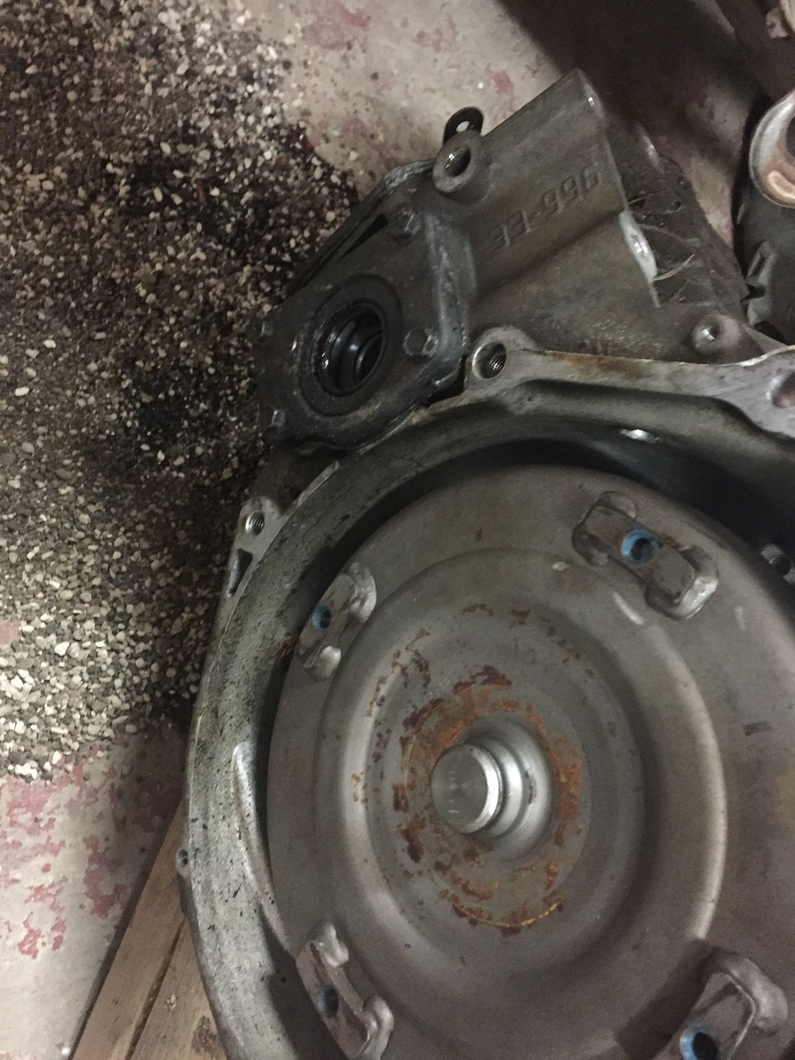

ya im hoping its gunna work really good, so now that i got my test fit and a couple mounts all figured out i ripped everything apart again for final clean up, replace a bunch of seals and what not on engine and get it all ready to go back together for the last time....hopefully....so i did oil pan gasket, intake gaskets, thermostat, valve cover gaskets, spark plugs etc...i also swapped over the right axle seal retainer plate/diff bearing race holder from the neon trans to caravan trans, now both neon axle shafts fit right in...more to come Had to go threw a bunch of wiring in the neon too because they decided to hardwire most of the engine harness directly into the car with no connectors, also had to separate the front lights, horn, washer, rad fan wiring from the engine harness

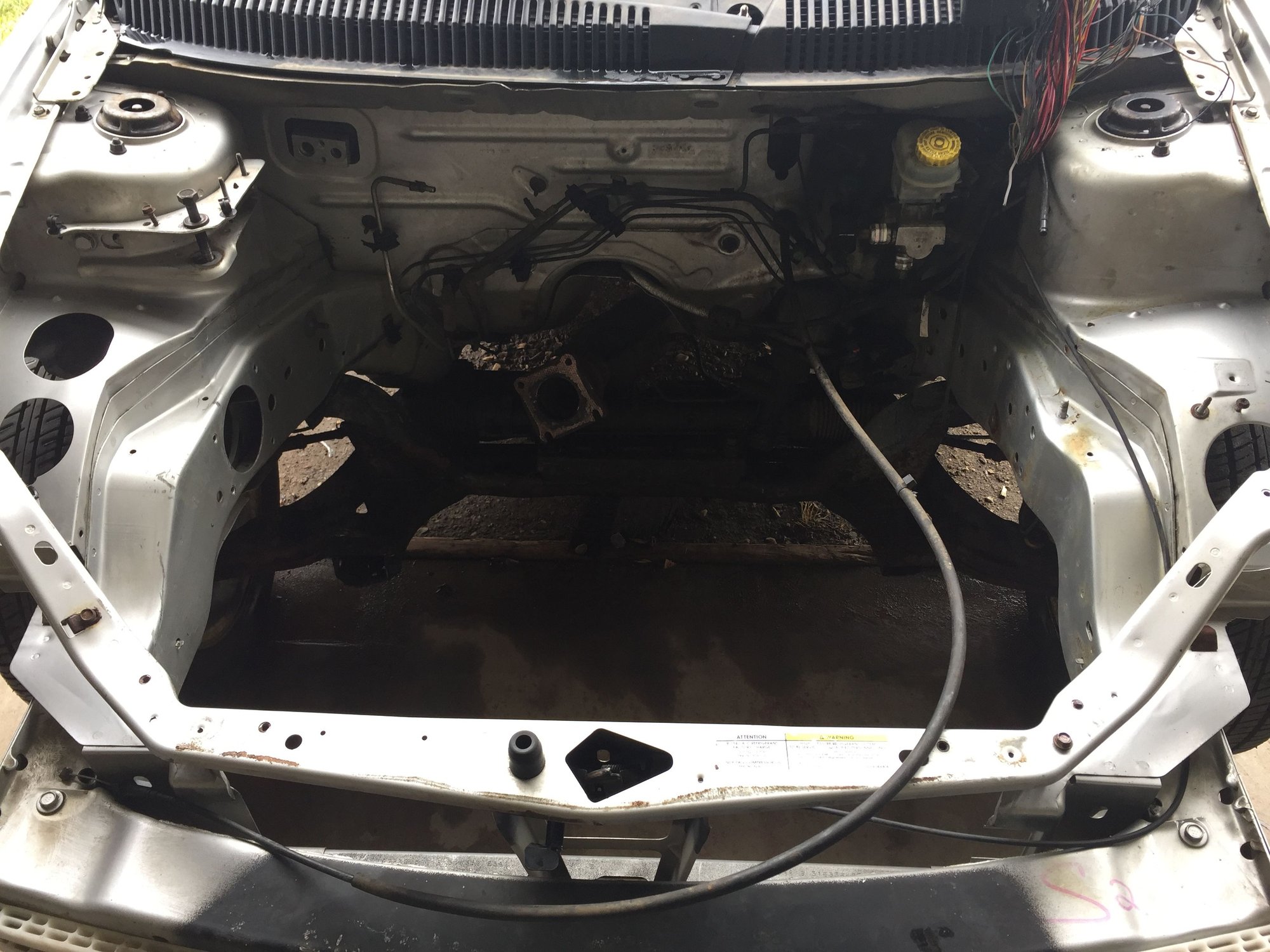

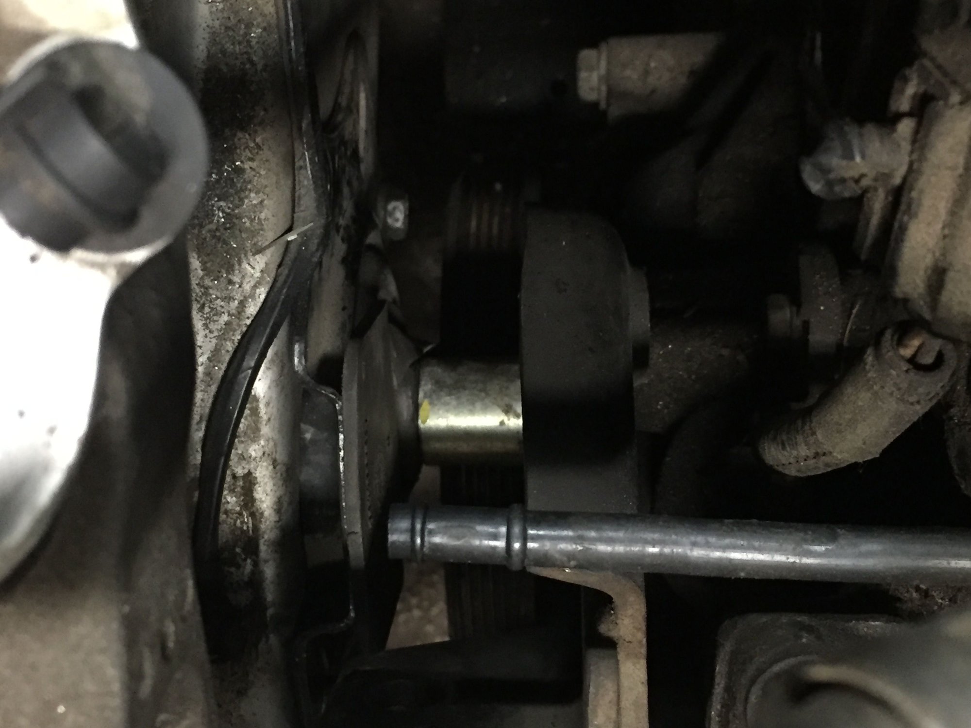

So been awhile since i worked on the car, life happens, gave up on the project a few times but after some chats with fellow V6 swap enthusiasts and a visit to moparfest, the fire is burning again and im back at it, i recently finished up the left over wiring, got my rad hoses and heater hoses plumbed and coolant system full, kinda figured out a belt and finally got everything spinning once more, found out my tensioner is shot and could use a slightly shorter belt, have a plan for a good solid engine mount to stop the torque twist, gunna use a newer van/patriot/compass idea with a fore-aft cross member and a bushing at the front of the engine by the rad, mounted and plumbed my tranny cooler (bypassing the rad to avoid the inevitable cocktail mix), and also wired my battery up in the truck as the real estate under the hood is pricey, made a new bracket to move my coil pack due to hood clearance, and commited to loosing both a/c and power steering because well...race car heres a couple pics
