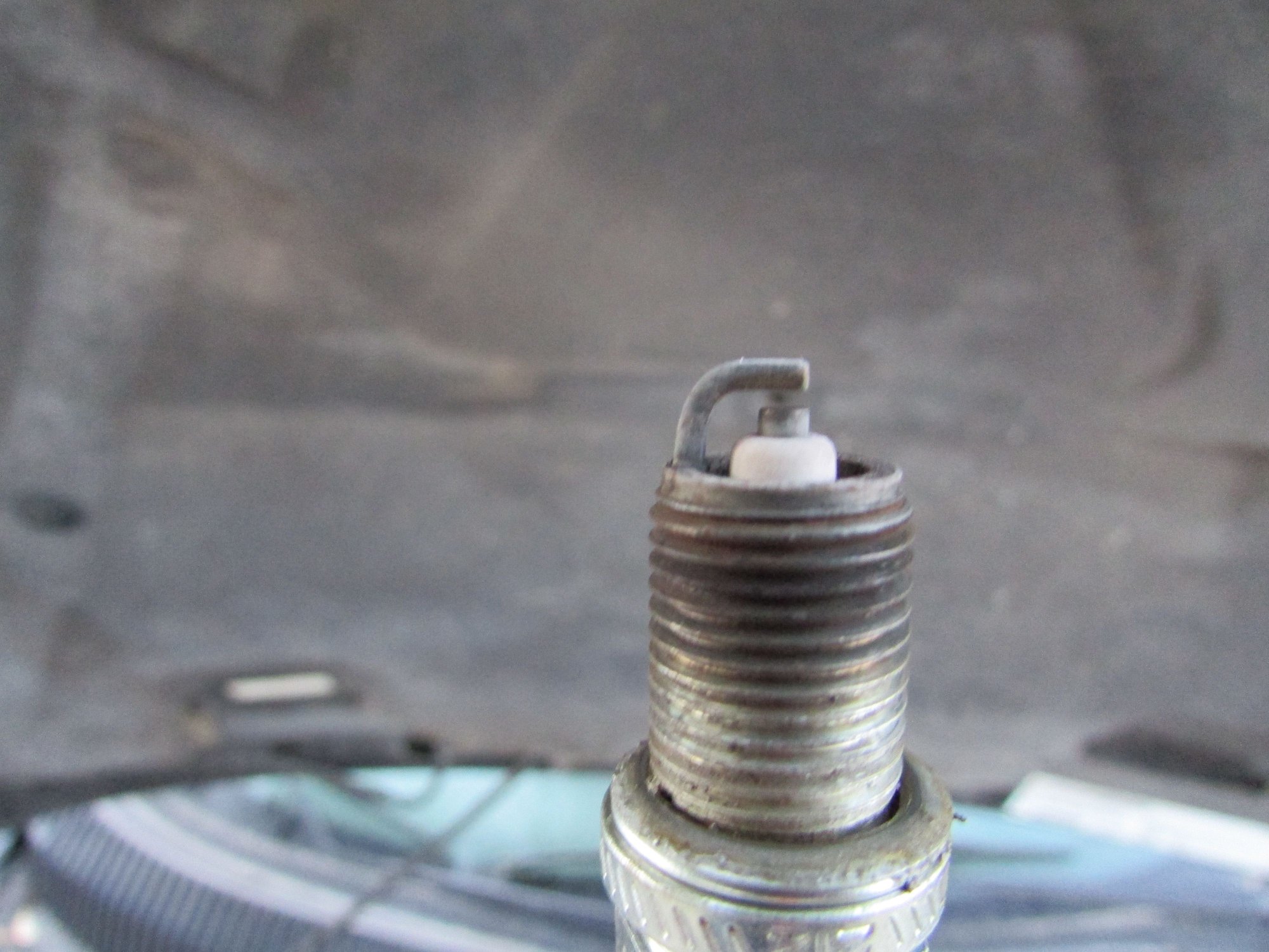

Here are photos of the plugs out of my '04 2.0. They have approx 2000 miles of in town, and highway driving on them. Photo 1 is cyl 4, second one is cyl 3, third is cyl 2, bottom photo is cyl 1. They are gapped as per spec.

Ok good idea to have posted plug photos. Photo-1 cyl 4 plug, is that a piece of carbon between the center electrode & ground lug, or just a out of focus black something or other in the back ground?
Photo-2 cylinder 3 plug, is the dark line at about the 3oclock position a crack in the internal ceramic insulator?

On the cyl 4 photo, yes, is just out of focus. I can re check the #2 plug. Bought a good coil at an auto recycler yard, I will take it on a road trip today and see what it does.

Another thought about the #3 plug photo, make sure that dark line on the internal insulator isn't a electrical break down carbon track path. If it is, clean it off if you use the plug. A metal, or paint polish & hard wooden stick will usually tidy the insulator up. Blast it clean with a brake or intake manifold, or electrical parts cleaner to get things squeaky clean If it was a carbon track & you have another miss on the road test, add that plug to the suspect list, especially if the computer flags the #3 cylinder with a misfire code.
More thoughts for consideration, let us know how it goes.

Took it on a long road trip, 142 miles total, some good hills in the area I was in. Pulled the hills with zero miss,more power than it had. Got 38 mpg for the round trip
