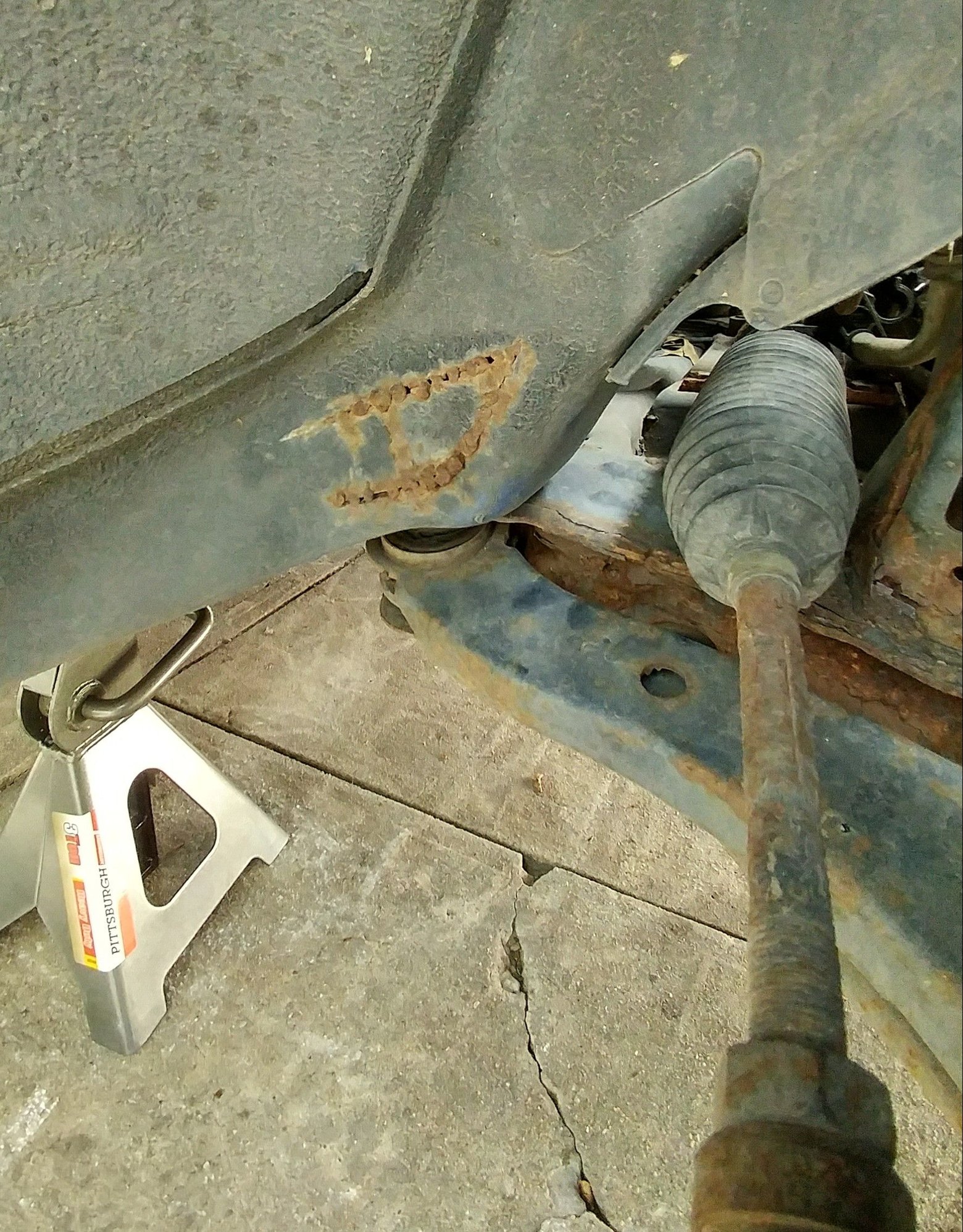

So when I replaced my tie rods, (this was taken before that) I noticed this weird looking bit. this is on the front passenger side. any ideas what the deal is with this spot that looks like it was cut and then welded back or something? should I be worried about this at all? neither the dealer or the tire/alignment shop seemed to make note of it, so I'm guessing it isn't some sort of critical issue, but it seems peculiar.
and is the rust on the bit under and forward of the tie rods something to be concerned with? the driver side isn't as heavily rusted.

Love the car, I have the same car but the previous owner ordered it with the rear spoiler. Love the color! Is your spoiler in your rear view, I'm 5'-10"?
99% sure the rear light gasket are leaking. Gaskets are a stupid set up. The only way I could get it sealed was to use home 100% silicon on the gaskets. What a mess, use rubber gloves. If you park downhill in a storm it will fill up your floor boards too, look under the rug.
Looks like a DIY person cut the frame open to get to the bolt behind it? It's a small hole. You could have a shop finish welding it to stop water from getting in and grind down so you can't see any weld. At home wire brush it then used auto grease cleaner ( painters use) and then use a spray can of auto metal etch primmer and a can of RUST-OLEUM oil based enamel paint. I go to Advance Auto if you have the extra cash and plan on keeping the car, also it will be easier to sell.... if not just use what ever you have on hand. I order online because they always have 25% off coupons google it. Then pu parts at the store. Just saying.

yeah, I'll definitely take a look at that. I don't think what I saw before is a huge deal, but definitely sounds worth having on the list to tend to.
yeah, I showed that picture to someone I know at work who is a bit of a car person and they figured similar.
I was thinking that maybe just grinding down the worst of the kludgy welds, polishing up the rust as much as possible, then JB Weld to fill in the gaps and smooth it over? I had been thinking of maybe doing some cleaning up and going over the wheel well with Rust Reformer and rubberized Undercoating type stuff. seems like it might be just the thing for this sort of situation.

Sounds good about with the weld repair. Do it at nite, or less humid day. That stuff drys real fast when it's hot, kind of drys up like Bondo.
