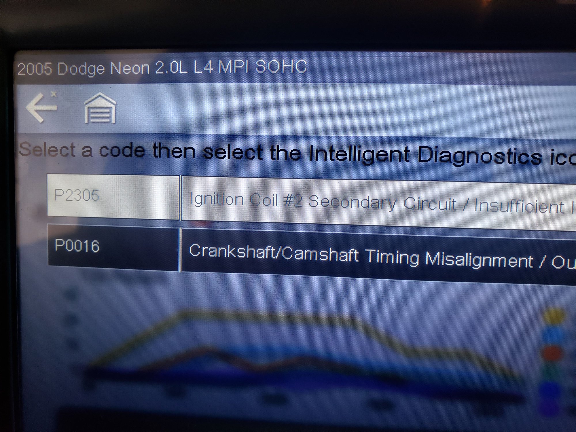

Took the car in 7 months ago for head gasket replacement. Upon getting it I got code p0016. Shop kept dodging me on getting it back in, in a timely manner. 1 month later it dies. Now has p0016 and p2305. They finally took it back, 6 month later they still havent figured out what's wrong.
Following parts replaced.
Pcm
Crank sensor
Cam sensor
Magnet on cam
Coil
Plugs
Wires
Shop has check wiring on coil, cam and crank sensors.
When it died, it wasnt a sudden die, it was struggling to stay running.
P.s it's a 5 speed.

Ok, no start no run condition. Only those codes show.
Shop replaced head gasket awhile back, upon leaving shop it had code p0016. Car was in limp mode. About a month after the did the head gasket, the car died. Code p0016, p0300 and p2305 present. After months of them not working on it when it. Took to another shop, this shop fixed the timing. It was 2 notches off. Cleared the codes. Attempted to start the car came up with p0016 and p2305.
The shop replaced all parts after it died.

As my post stated, the car only had p0016 prior to it dying on the road. After it died I had p0016, p0300 and p2305. Shop fixed the timing as it was off 2 teeth (dealership). Now only has code p0016 and p2305. The cat is not plugged as it happened over a matter of 5 minutes, dying that is. The exhaust is not restricted. Also, the car only has one coil not two and the bat is new.

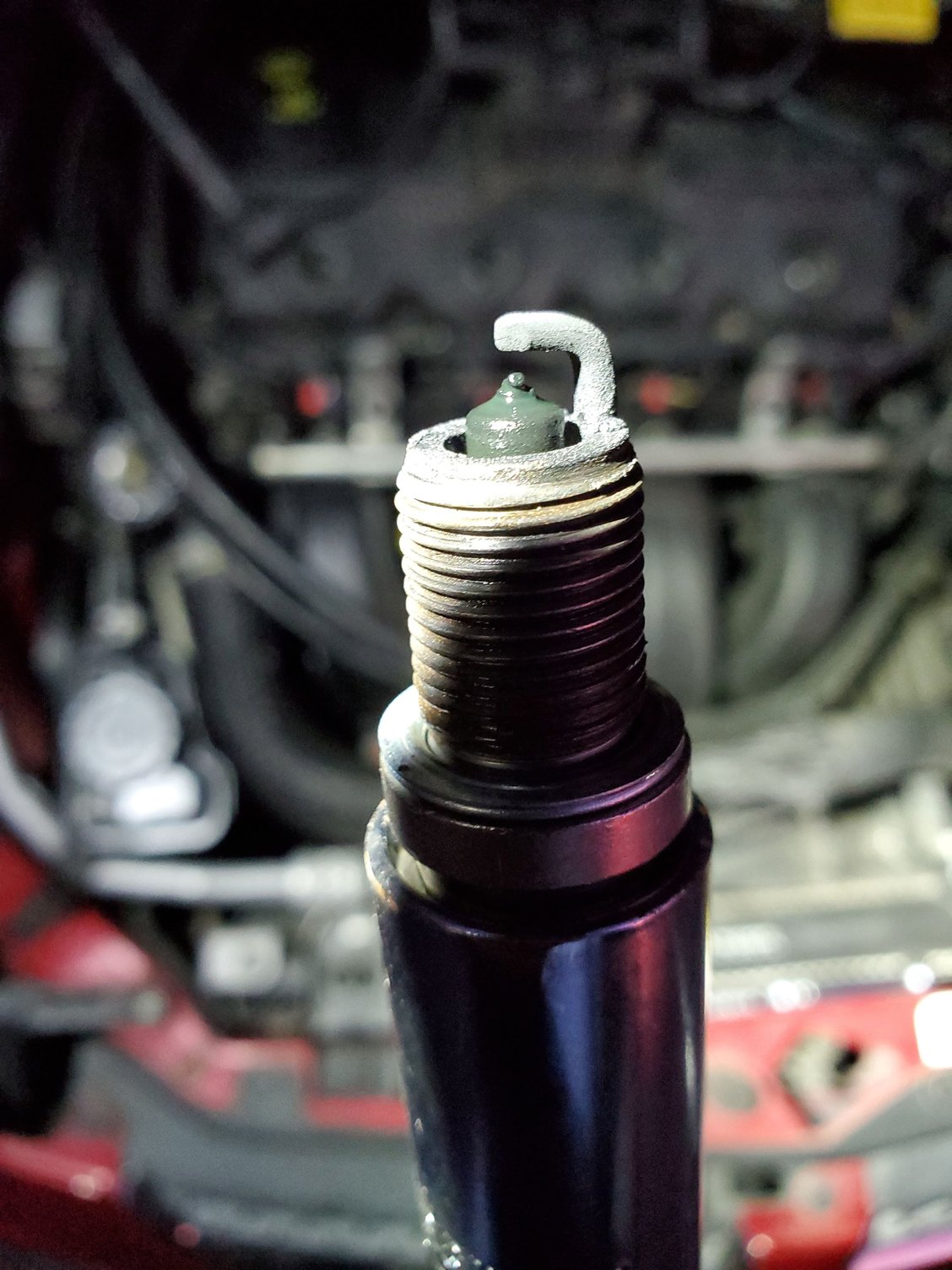

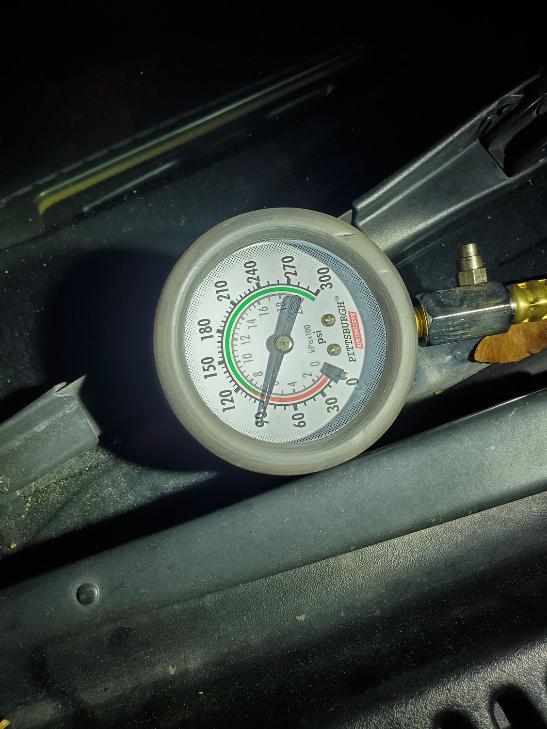

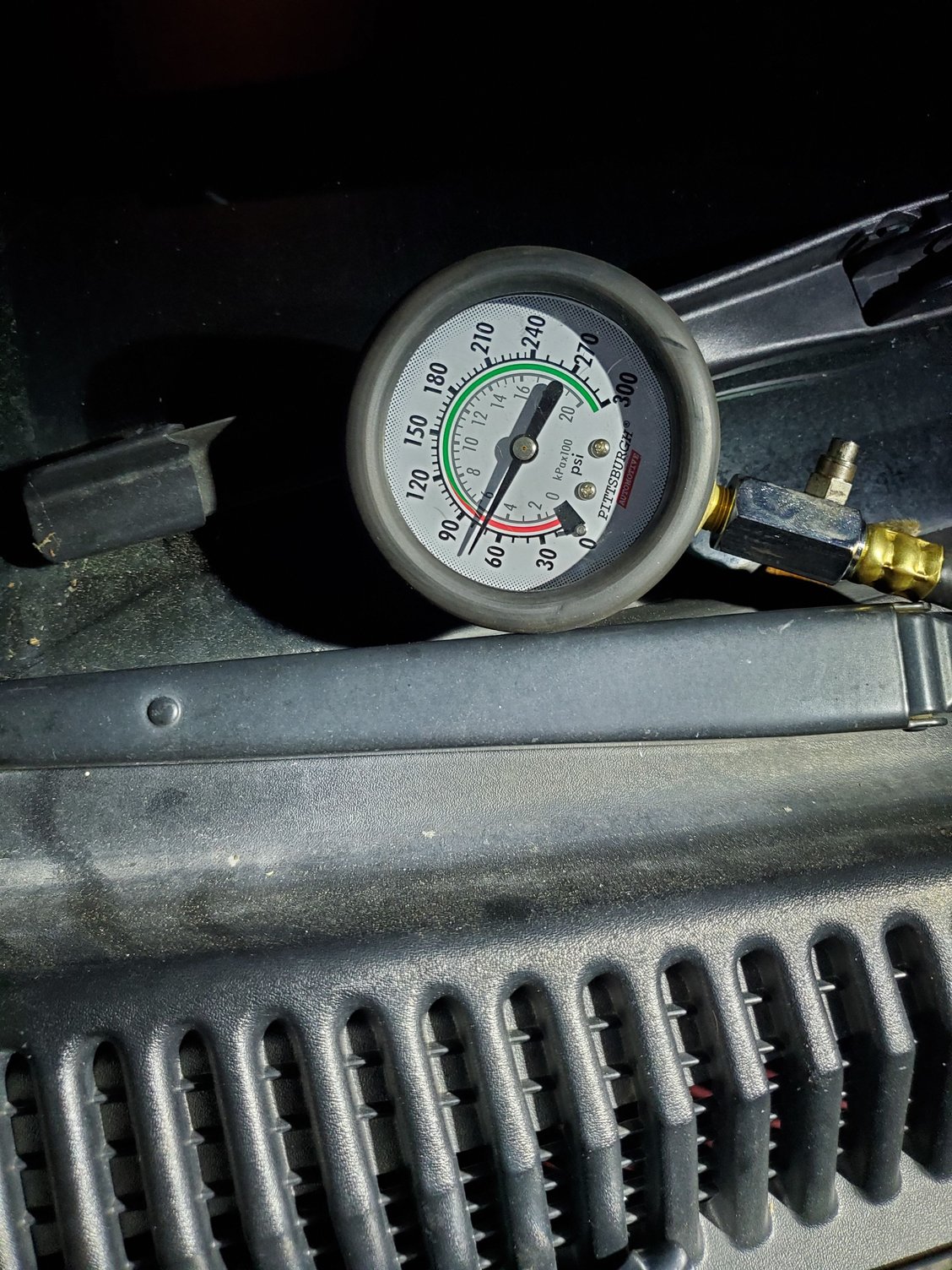

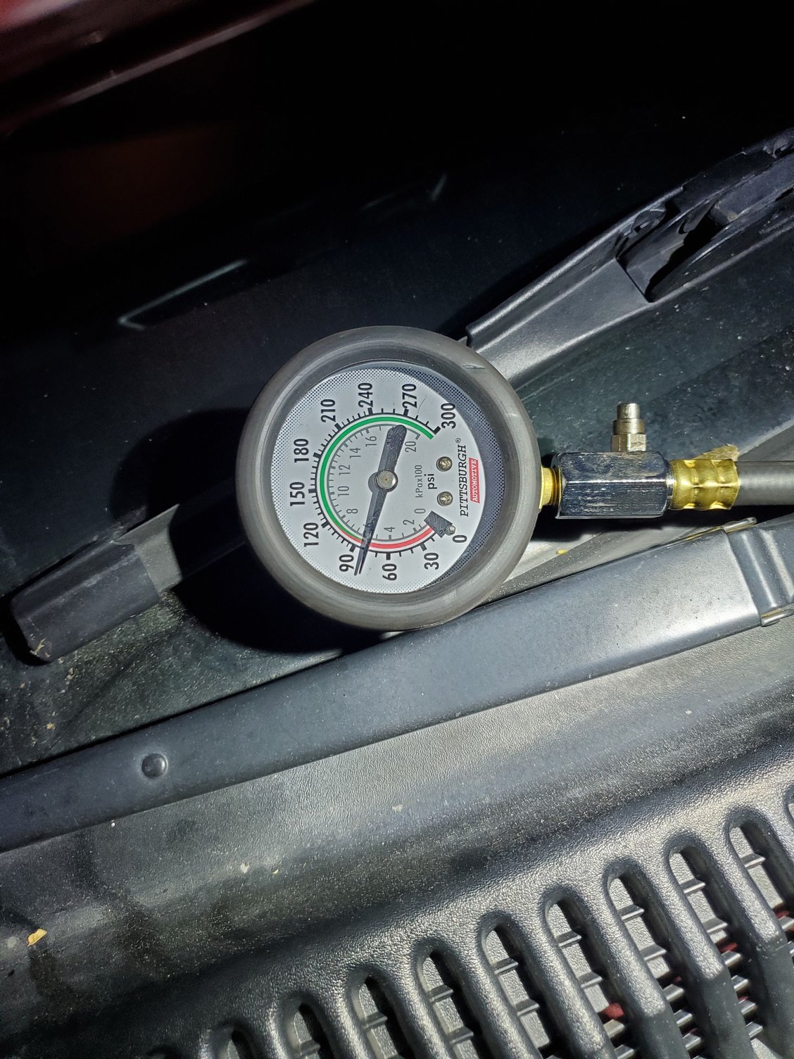

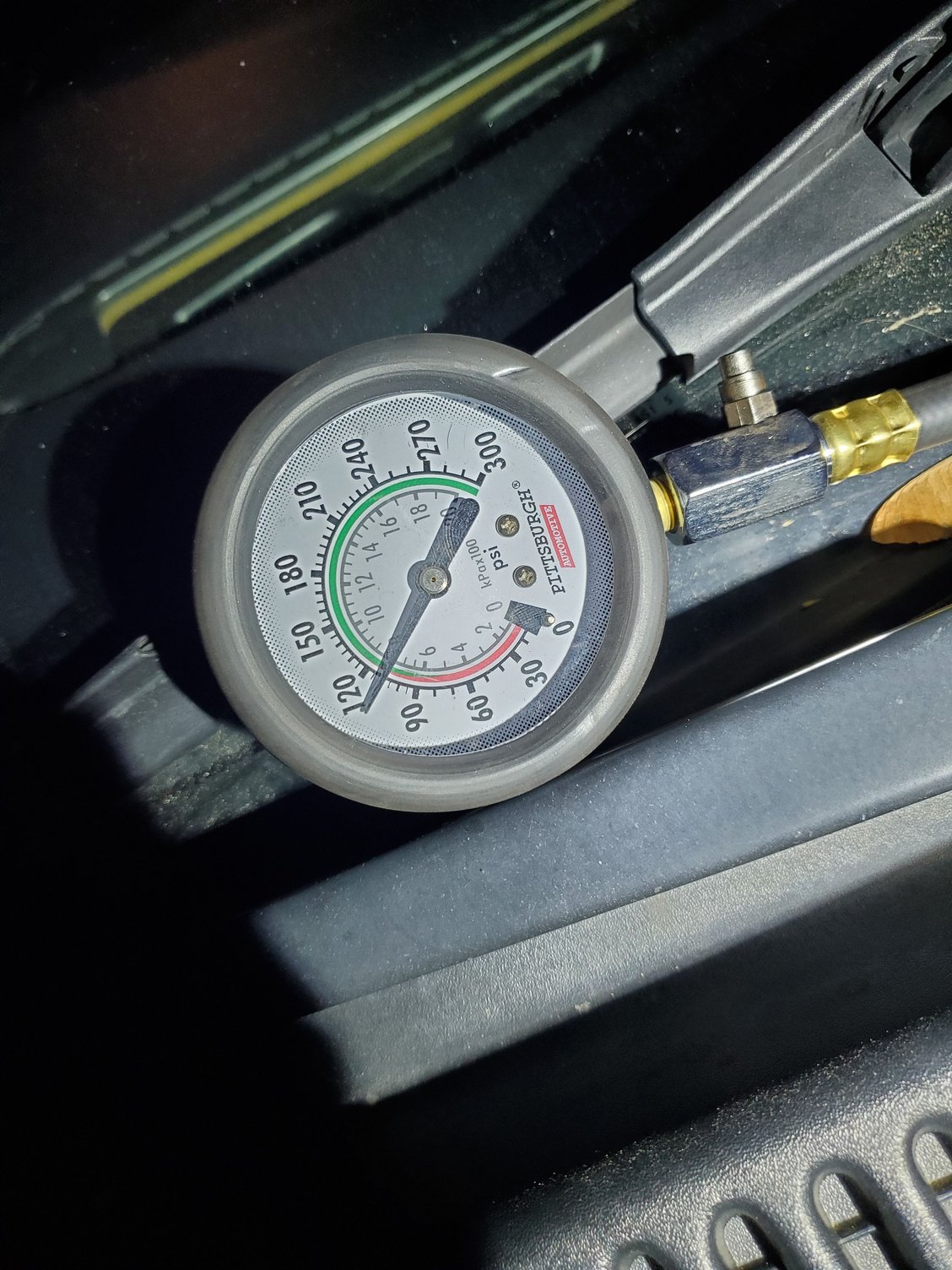

Well I finally made it to the shop to look at it my self. Take a look at what I found. Btw they killed my battery and all compression test were done with at minimum of 7 compression strokes and all spark plugs out.
Oh, i forgot to mention cyl 4 has coolant on the plug. I smell a lawsuit.
