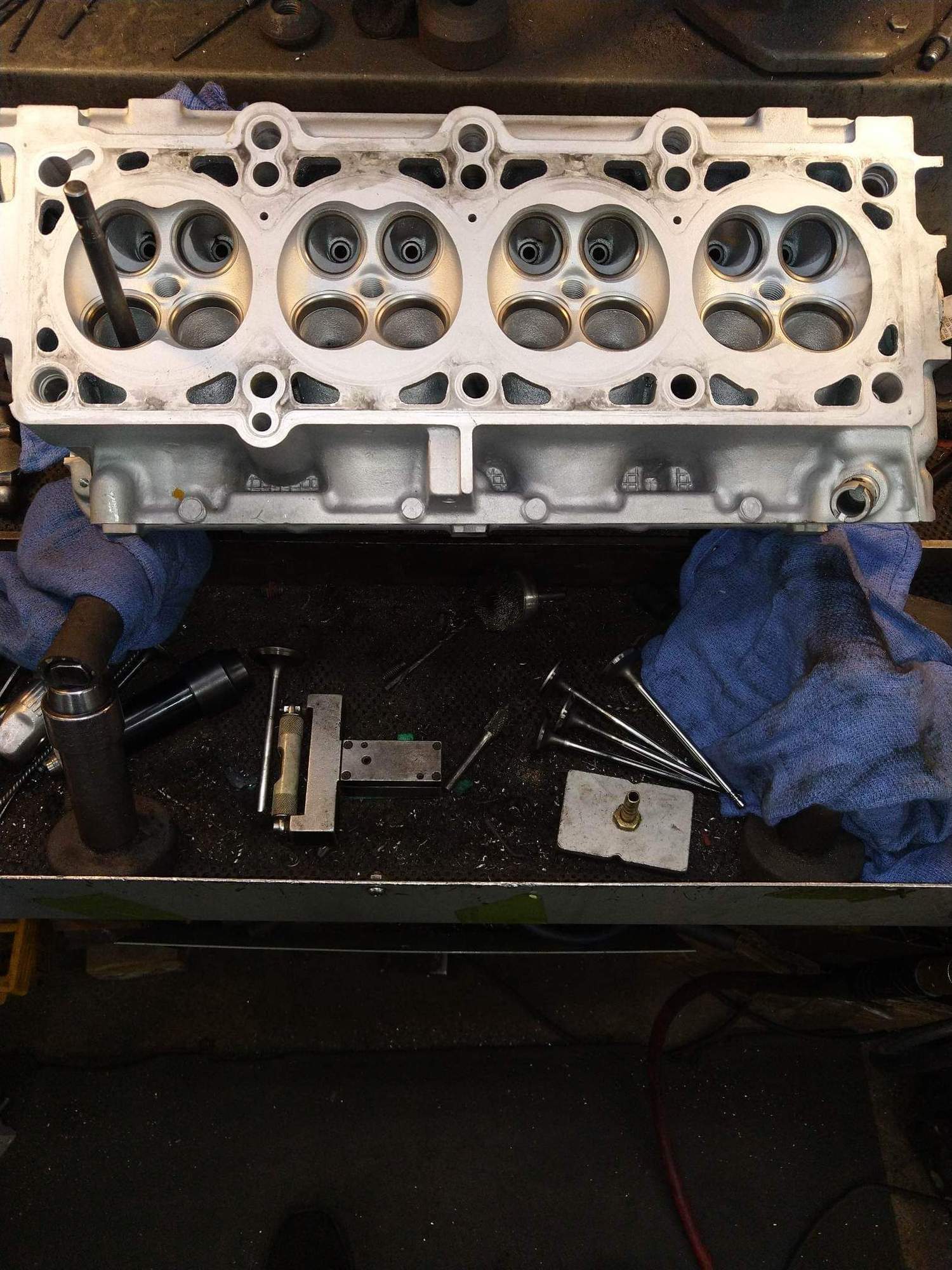

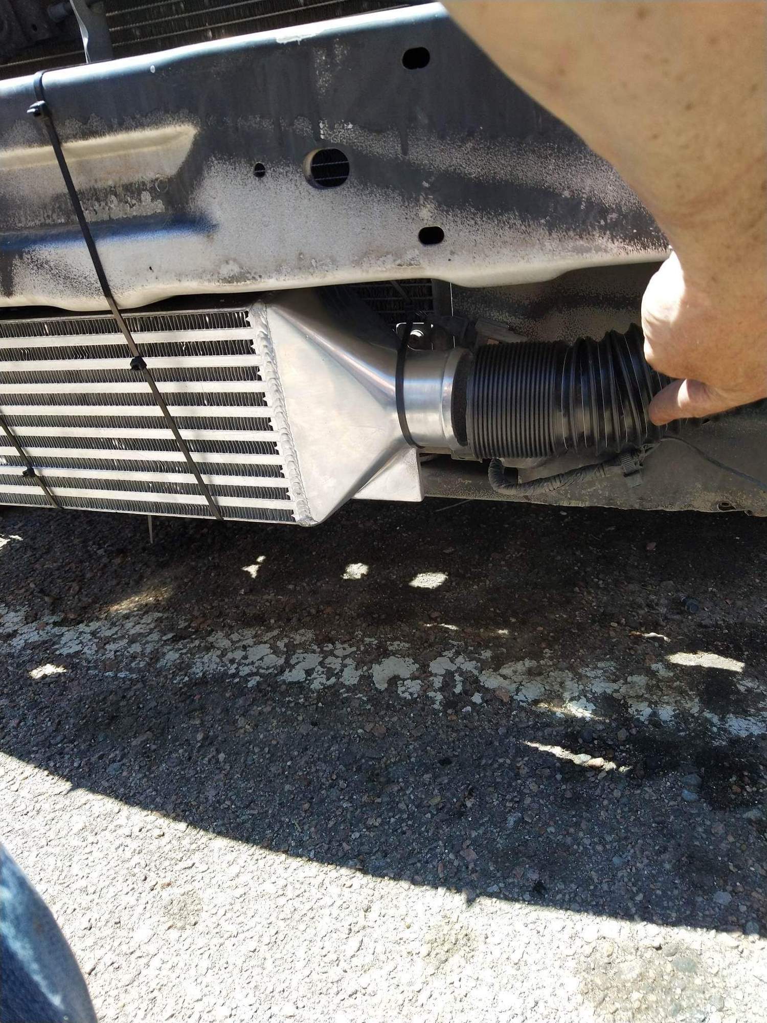

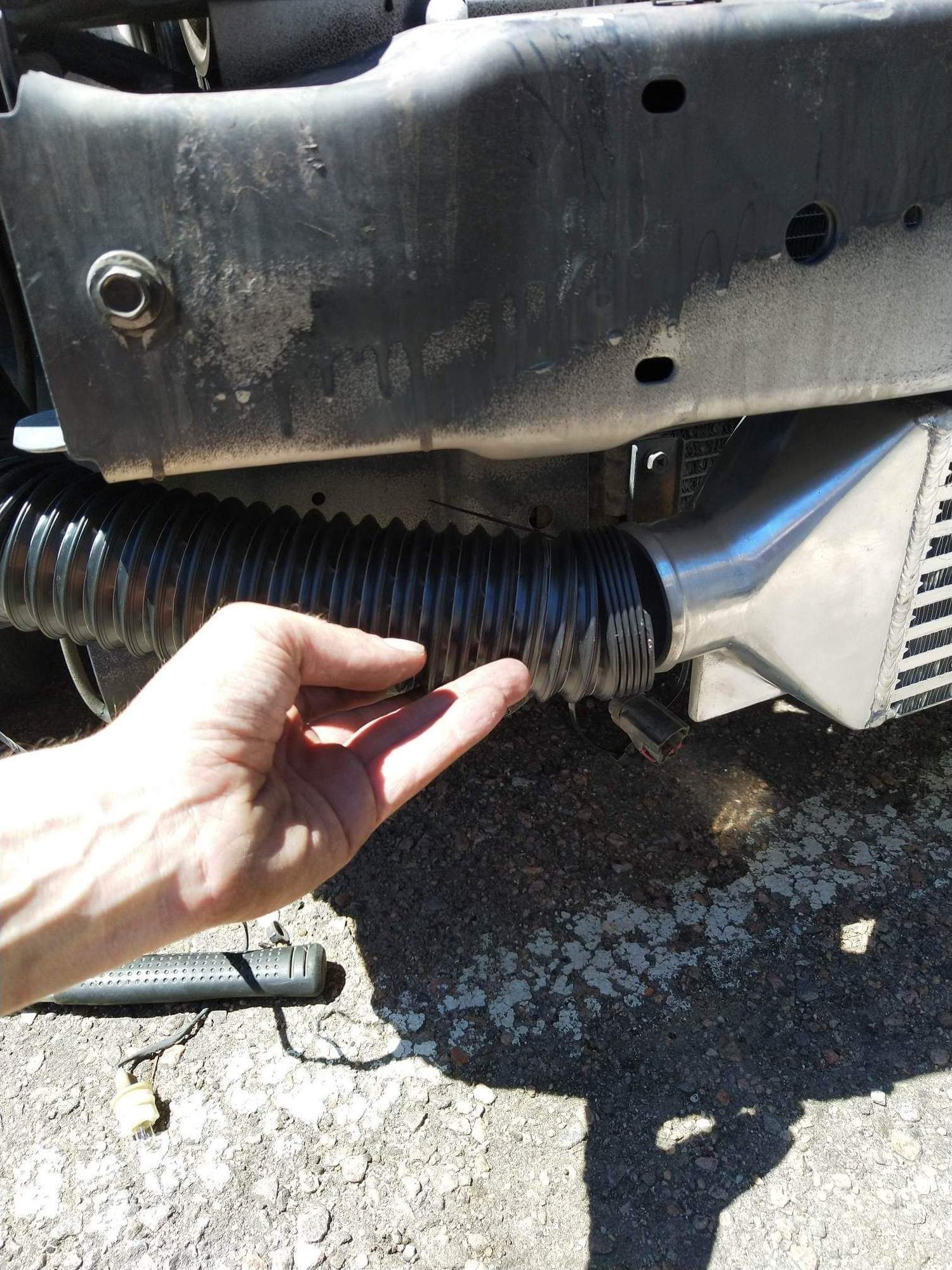

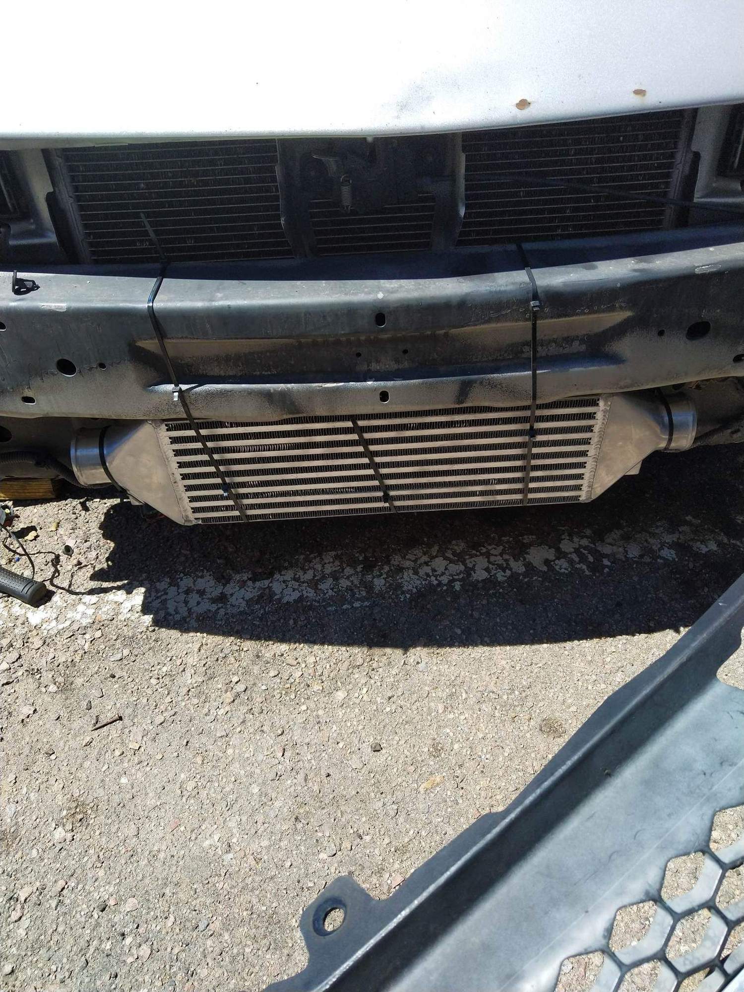

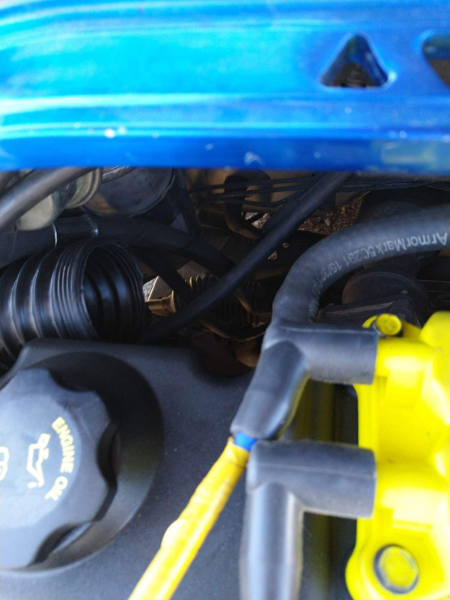

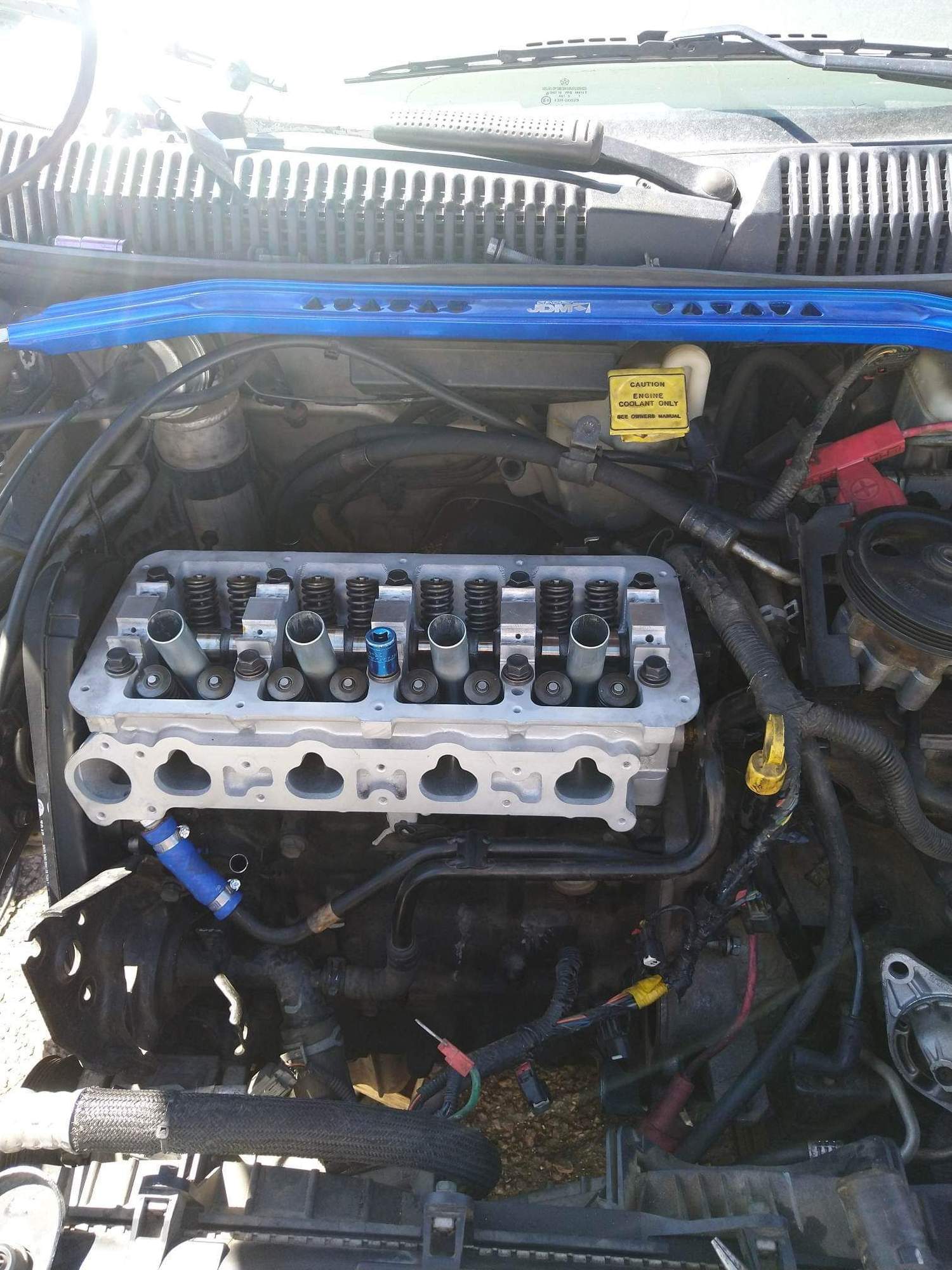

well it turned out to be the crankshaft sensor got a new one have not had any issues. till the head gasket blew. so now i have that replaced along with oil water pump and the head completly reworked going to turbo it hear real soon . i will upload some pics of the work .

Ok, good feedback on replacing the new (Oct 2019) crank sensor, has put things right & your on the road again.
Might be helpful to know if you determined for sure the then new (2019) crank sensor, was a Dorman & did you opt for a replacement Mopar, BWD, or another Dorman ???
Nice photos.You've been busy on this puppy. Will be interesting to hear how this mod scheme turns out & any dyno results, if you do that.

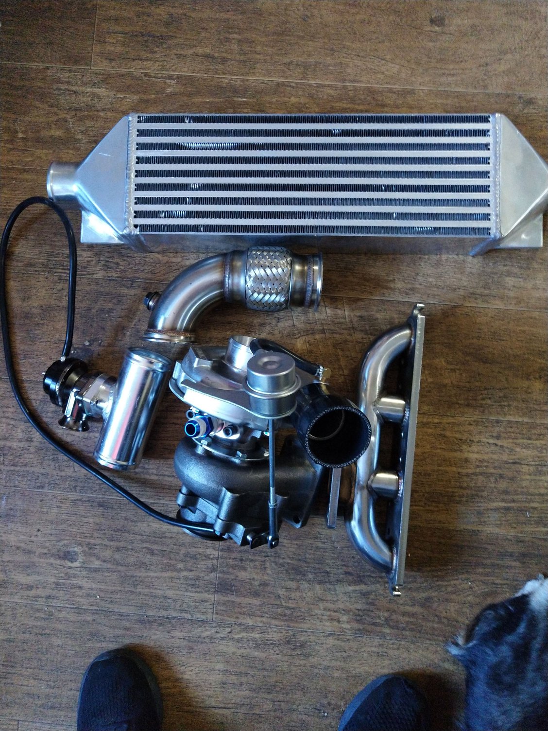

I now have parts on order going to finally turbo this neon. Updates coming soon.....

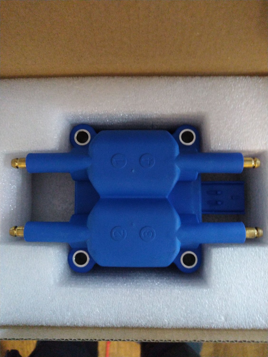

Got some much needed parts in the mail
