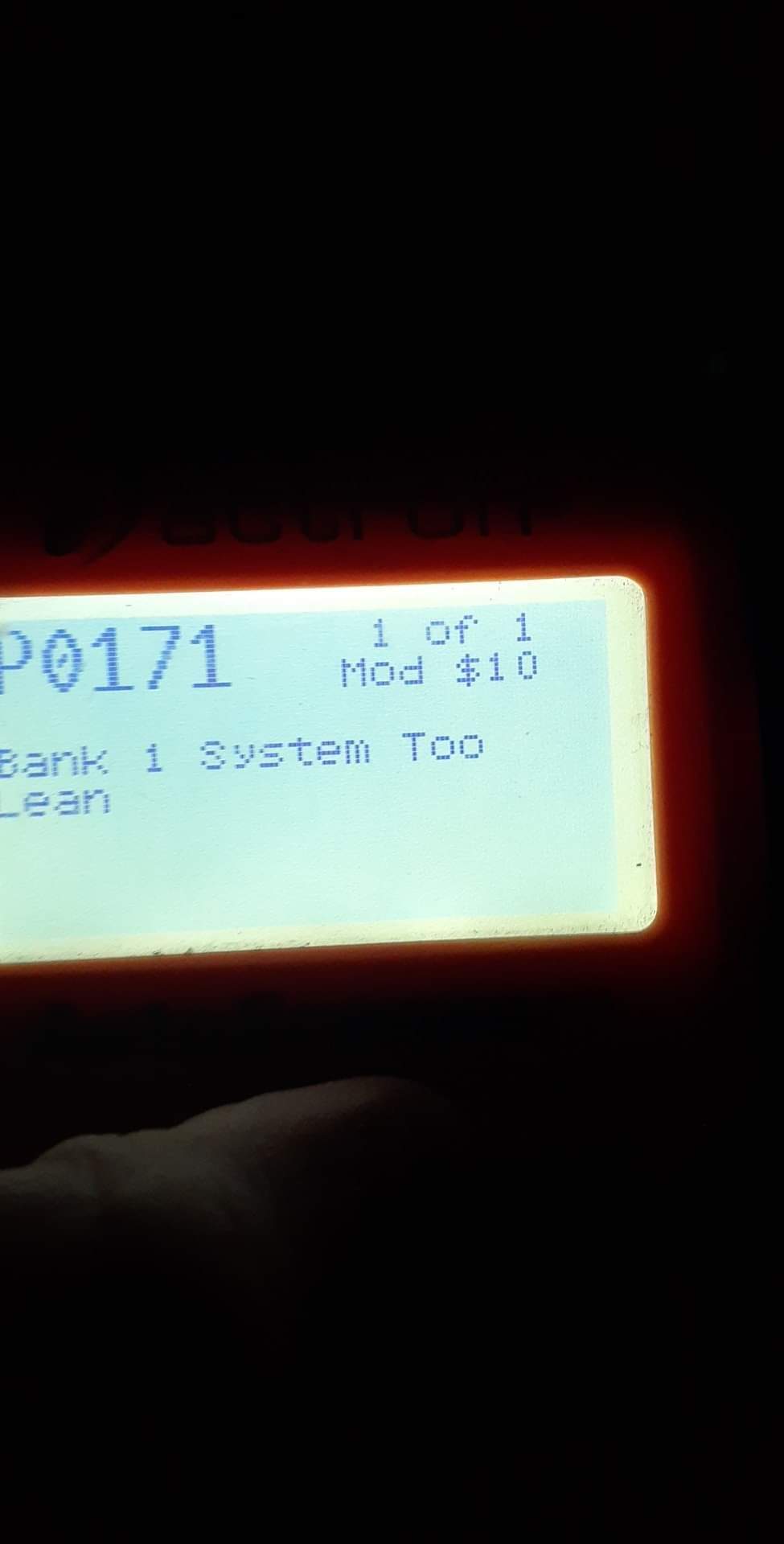

Car not running 02 neon automatic SXT. Alright it started with a idle studder when at red lights or just idling in drive or park. . Then it moves to not wanting to start and just turning over and over. It did always end up starting. I left it running while I ran in to the store and it threw a check engine light finally p0171. Next day fiance decided he's going to take off the maf sensor and clean it. Well there isn't a maf sensor and he cleaned the IAC thinking it was the maf. Anyways now the car still don't want to start but is completely not able to be driven. When you hit the gas it hesitates so bad and bogs down. So I'd assume I need a new IAC because it got worse when he messed with it. But would anyone help me assume if that was my original problem? Or did he cause a complete new problem? I drive for my job and really need my car. I need the job to buy car parts lol. I have a new IAC on the way but won't be here till earliest Wednesday.

Changed out the iac and it didn't change anything. 02 sensors are reading good.

It has a fuel filter. It's inside the fuel pressure regulator/filter assembly that mounts to the top of the fuel pump. It can be replaced without lowering the fuel tank. You can download the factory Neon repair manual for free to see where everything is located, how to test stuff and replace it. My son gave me his '05 Neon a year ago so downloaded that so I can try repairing things myself before getting professional help.
That P0171 code means that O2 sensor is detecting too much air in the exhaust. Since your car went from running bad to worse without throwing any other codes (there's codes for too high/too low fuel pressure), you just may have a vacuum leak in a vacuum line, the PVC hose or a bad/loose gas cap.
The fuel pump also has a relay that sends current to the fuel pump. I'm not sure if a code is thrown when the relay starts acting up then goes out for good. It'll be inside the fuse box under the hood. There may/should be another relay just like it for something else next to it. Those usually send power to something you can do without for awhile, like door courtesy lamps and seat belt chimes. You can swap those out to test the fuel pump relay.

I have looked for vacuum leaks but I'm going to go try and look some more today. I can head the fuel pump run when I click the key on. I've had so many idea thrown at me the past few days now broke lol. So I'm going to go down a free route today. Thank you. I'm really wondering if I could of clogged my filter bc i didn't know but the fiance ran i super low most empty the day before all this started happening. But not sure if junk got in there if I would of started being terrible that day. Anyways I really appreciate the knowledge.
