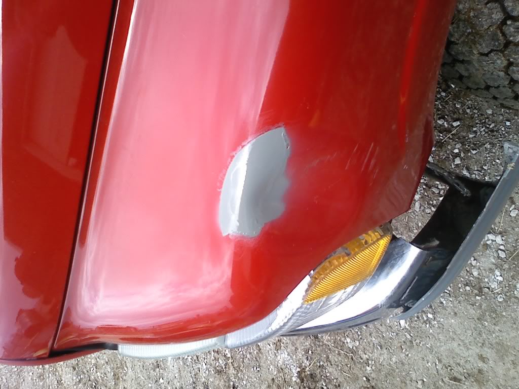

9. Once that is done, enjoy that matching splotch on your paint job that stands out like a sore thumb:
If you want to spray color on, you can do that as well, but in my case, this was just to seal the hole up so that rust wouldn't be an issue. As I said, this isn't a permanent fix as I'm waiting for spring and the salt to get off of the roads before I send her in to the body shop for the real painters to work on.
