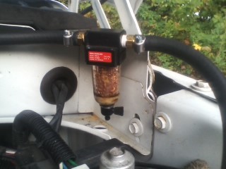

installed an oil catch can and a new mopar pcv. Been running it about 2 weeks. About 300 miles. Cant believe just how much oil the Pcv lets through. You can see a little bit of oil in the container. Im using an air tool water separator that I bought at Home Depot. Had to close off the drain cuz the original design is that it seals when it is pressurized. Well this has a vacuum pulling through it so the plug is always open. Removed the original filter and installed part of a copper scrubby for my baffle. Mounted it from the heat and is easy to access.

A catch-can is definitely worth adding.
Most of what little oil I do add, can be found in the catch-can.

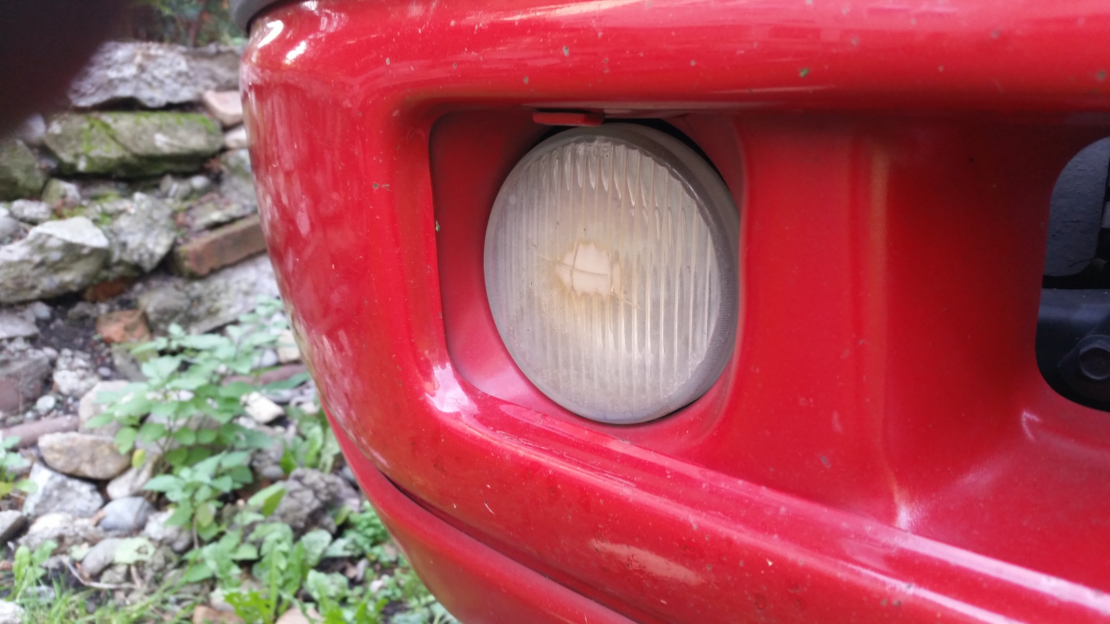

Default Swapped the fog lights
Ordered new headlights lenses and LED bulbs, installed some (supposed OEM) fog lights and stuck in some LEDs just to check them out. It doesn't seem like the LEDs are brighter than the halogens. I might switch back...
