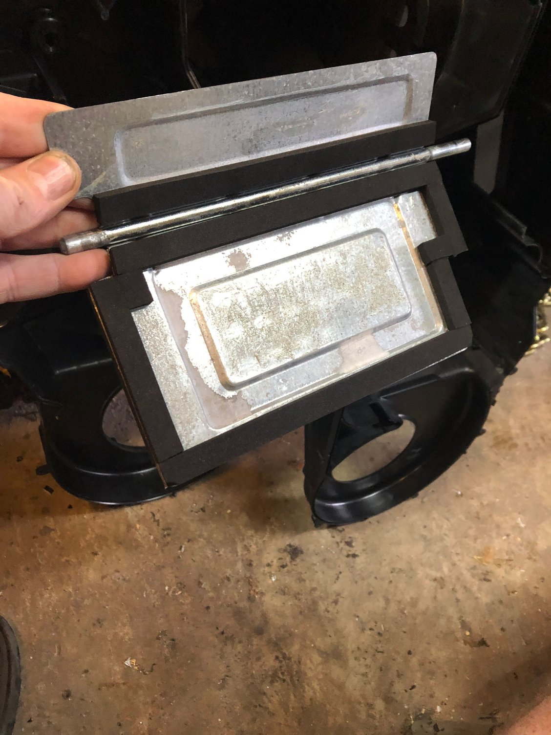

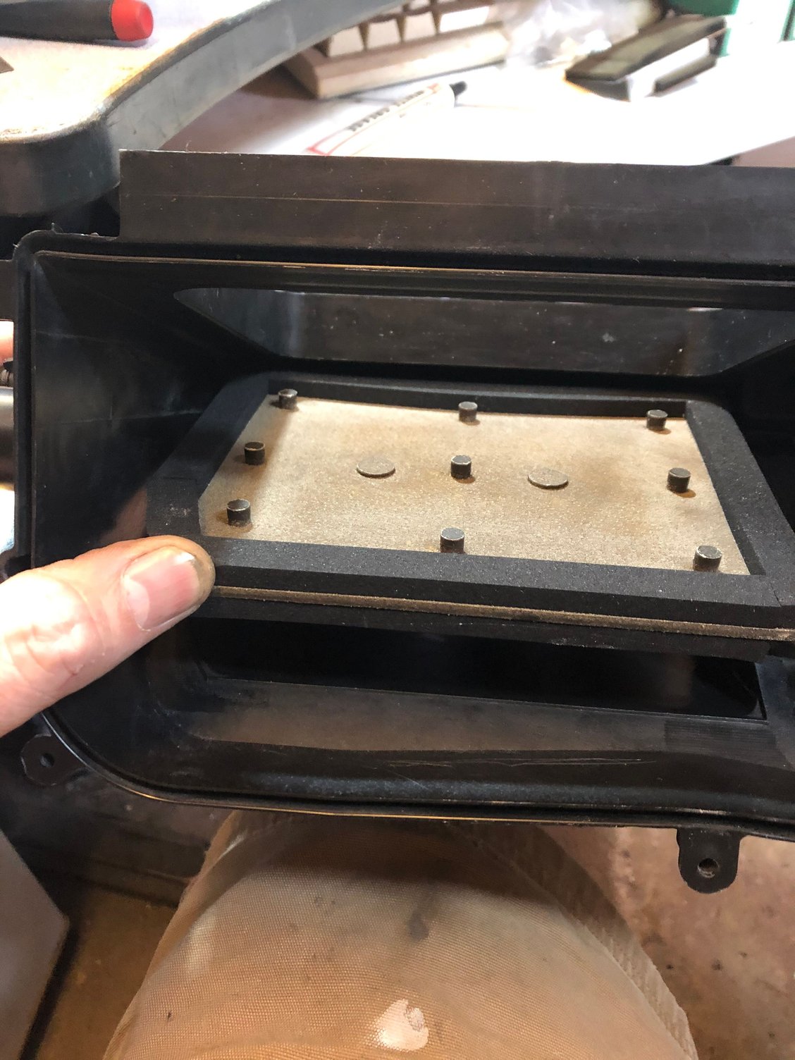

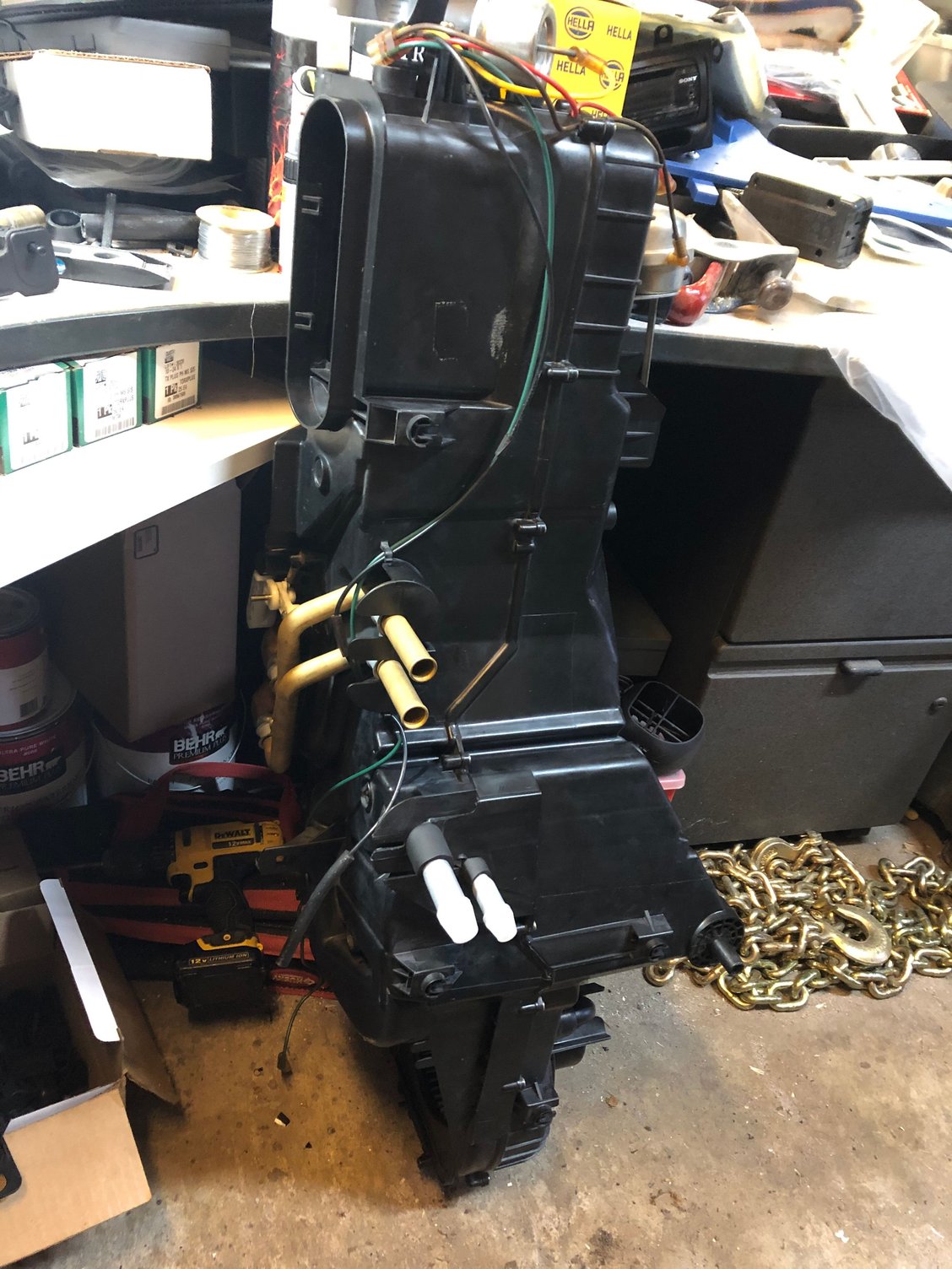

Today I cleaned all the heater box parts.
Then applied the new seal material I got (1/2”x1/4” closed cell foam)... I was pleasantly surprised how good the adhesive was.
Then put it all back together.
Just like a new one.

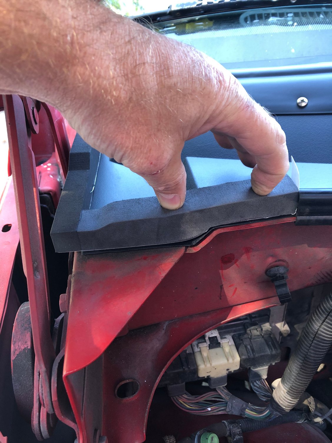

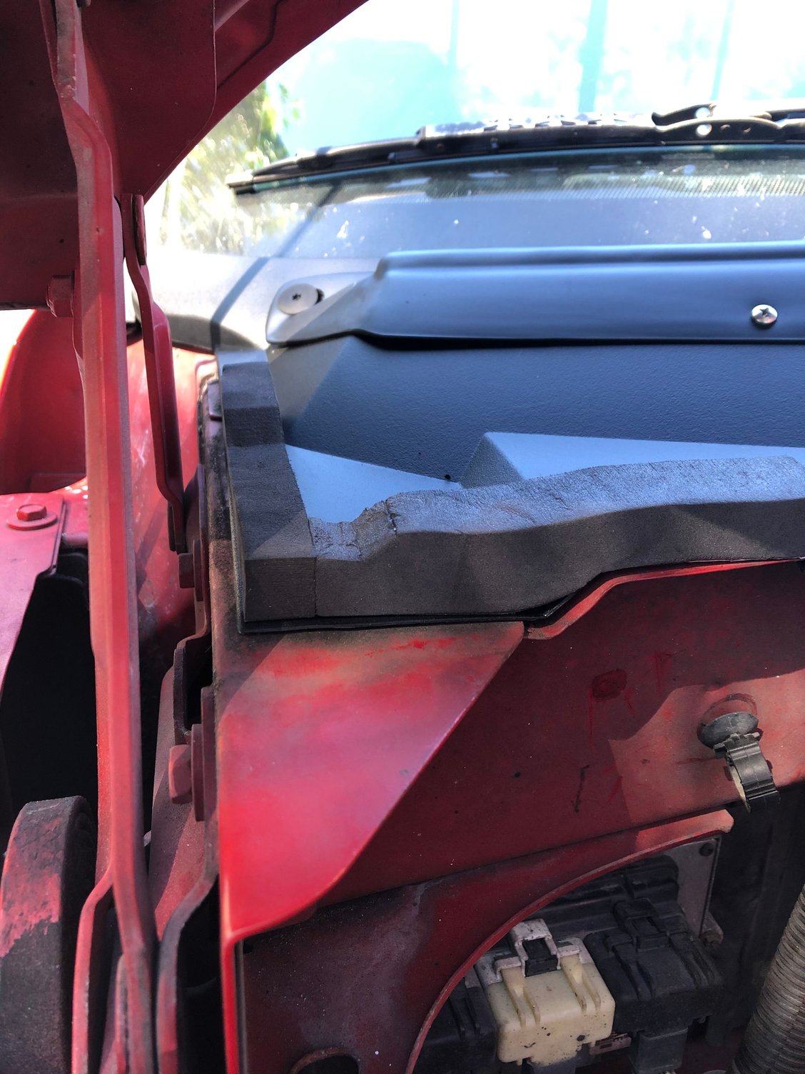

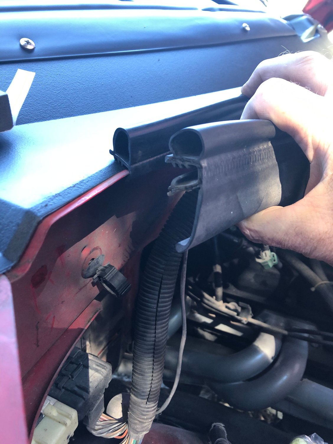

This morning I put new hood seals (LMC) around the cowl.
As you can see, the center one doesn’t have the flap that hides the wiring loom, but I guess that’s no biggie.
The driver side one was fine, but the passenger side was 3/4” long... I had to separate the pieces, cut it to the correct length, then cut back the step in the top edge... put them back together with some double sided tape, before sticking them in place.
Do you have a link to them? Was looking for them for forever!
