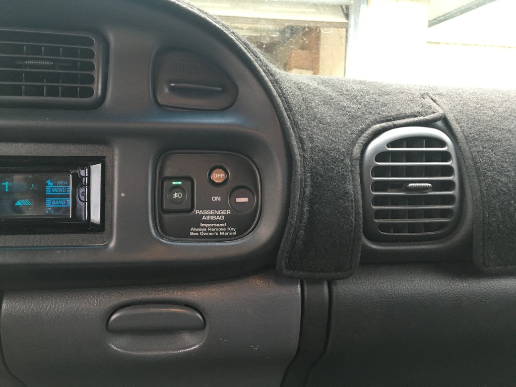

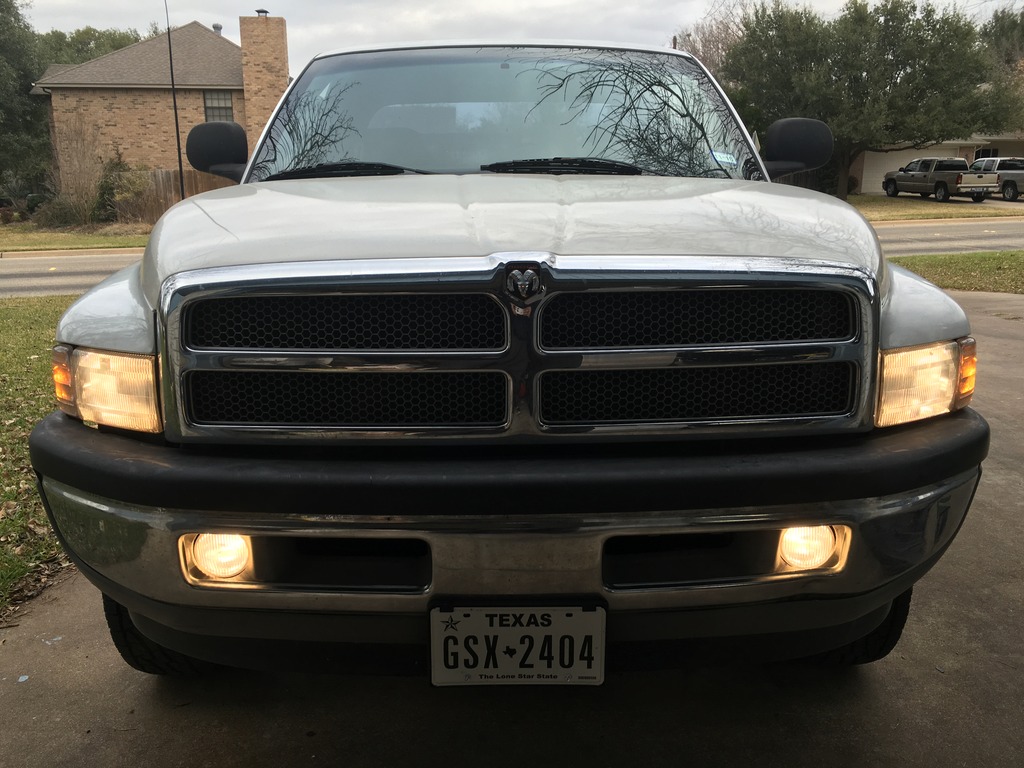

I really wanted fog lights for my truck since it did not come with them from the factory. I went to the local pick and pull and found another 98 that had them and got the switch and plate to use in mine, spent some time looking up how to wire an aftermarket set in and then pulled my plate to swap the new one on and to move my airbag key to the new plate. Boy was I pleasantly surprised to see that my harness already had the wiring! I checked the fuse box and the slots for the fog light relays had the female clips installed in the slots and wiring going to them. I ran back to the junk yard, got the two fog light assemblies and the wiring for them that connects to the connector under the fan shroud as well as the two relays. After about an hour of trimming my factory bumper inserts to accept the lights and some sanding / clear coating of the lights, I have factory fogs with very little effort!

Not bad for $18!

Yeah, it seems that dodge only used one wiring harness for the trucks, so, all the connectors for various options are already there, whether you have them or not.
