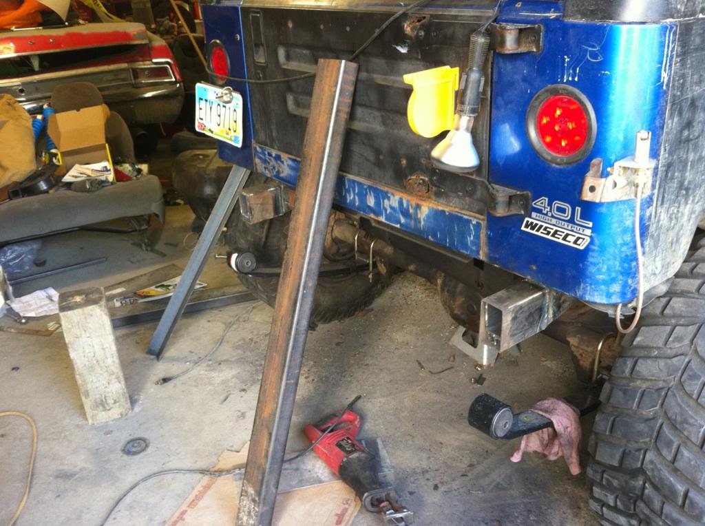

me same old same old,,,,, one cool project been work on is my buddys YJ frame rusted out back, he cut it off i weld in a frame and made a bumper and put in XJ leafs to made the wheel base longer,, also flip the fenders and welded those in,,, i will try to upload sum pics if u guys want?

this are the only pics i got,,,sorry im buddys got a ton on his iphone(lucky)
see the hole by were the bumper bolts in

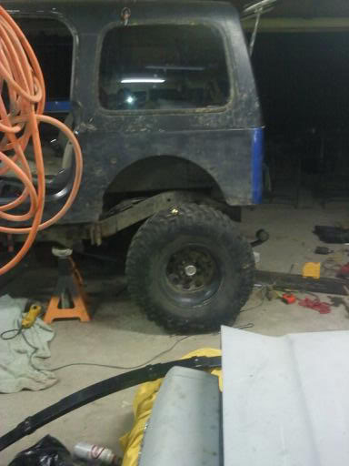

xj springs in,,,,, it moved the rear axle back

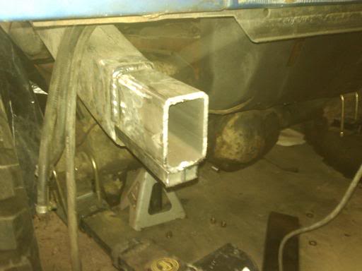

put box inside the frame,,, there bigger box on the out side
the outside box is the same size as the frame box

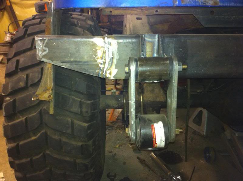

new back bumper and shackle mounts

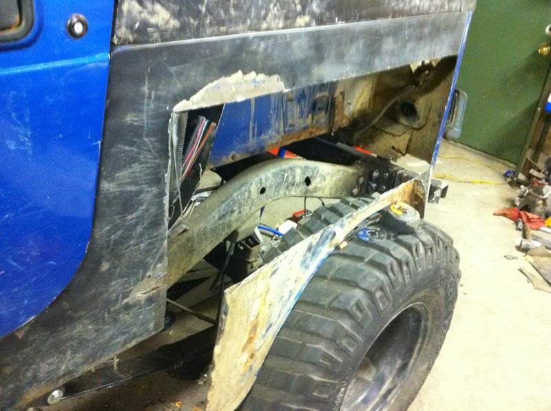

when cut off the fenders dont forget the wiring harness!!!!!lol..... we did
i thought it would be cool to flip the fenders so it would look more factory
