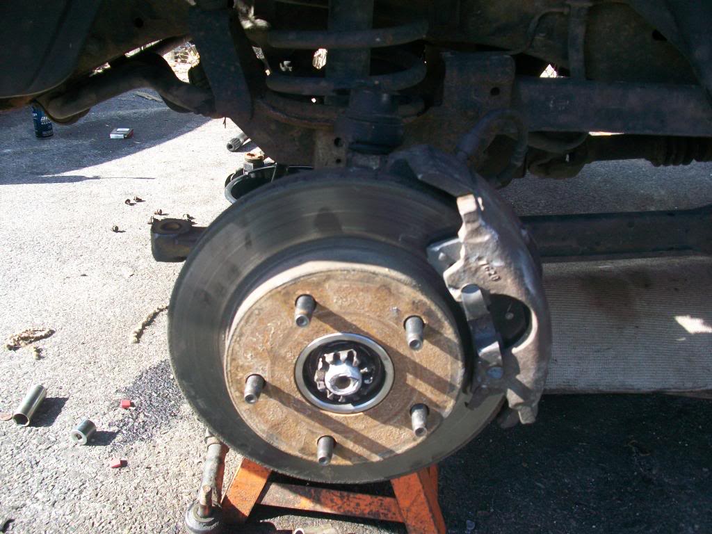

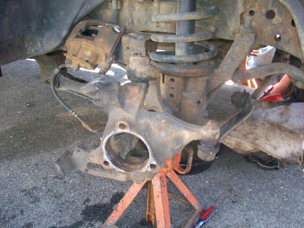

ok, now its time to remove brake calipers, and bracket, so you can get the rotor off. Once you have the rotor off, its time to disassemble the hub assembly. this will require you to turn the wheel back and forth.
There are three 12 point 14mm bolts that go in the back. You will need to turn the wheel to get to all of them.

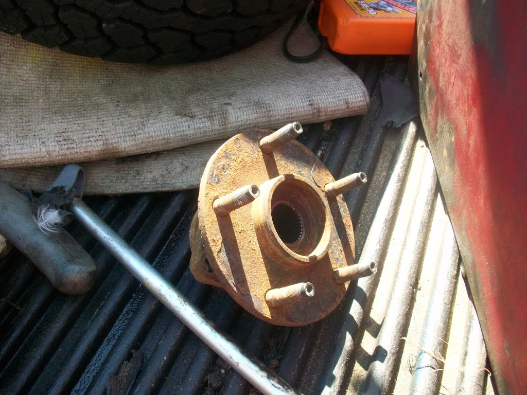

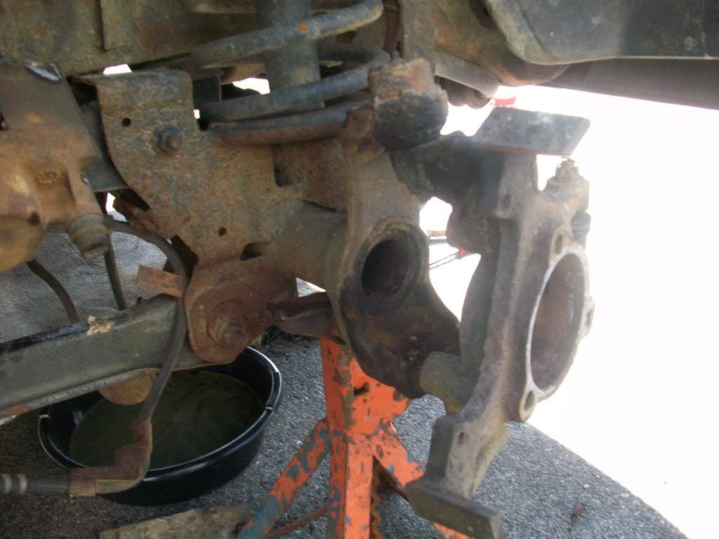

Now once they are off, its time to remove the Hub. It can be very hard and you may need to rent a slide hammer to get it off.

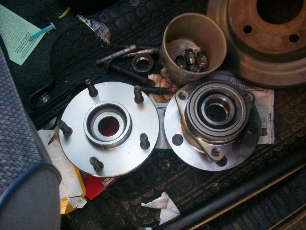

heres my old Hub assembly..

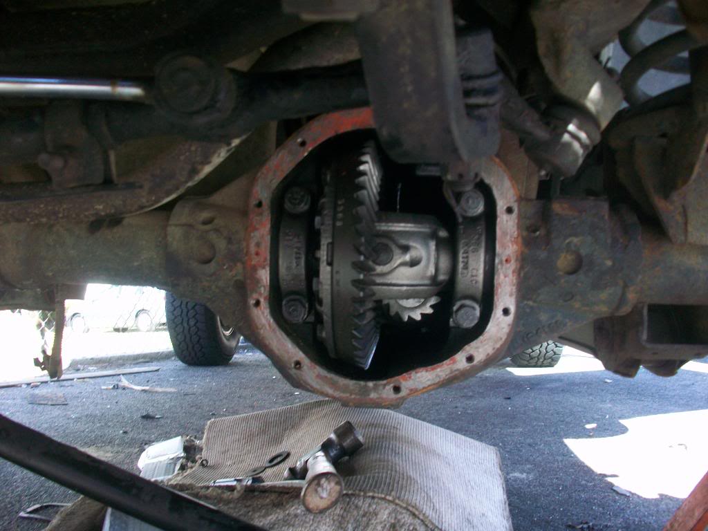

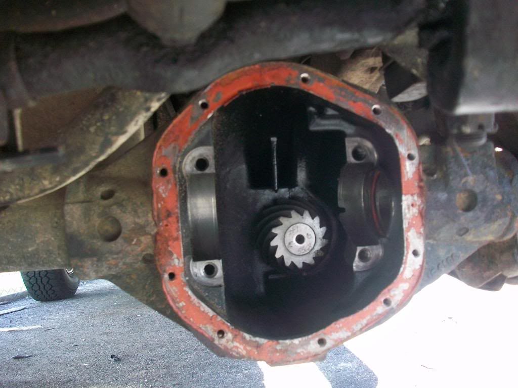

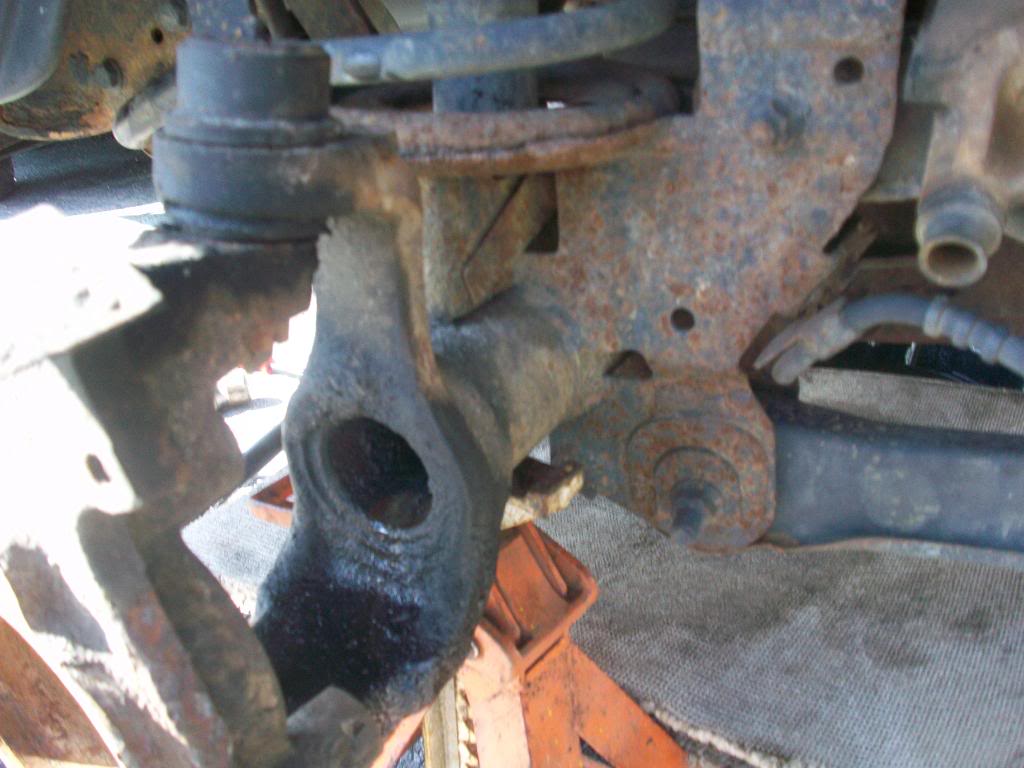

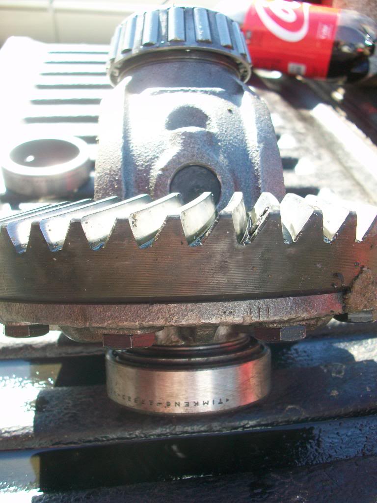

Now to take out the carrier. There are 12 12mm bolts holding it on. But first undo the tierod. Its a 3/4in socket i believe. and after you get the nut off, just hit the knuckle with a hammer and it will fall down. Now take off the diff cover.

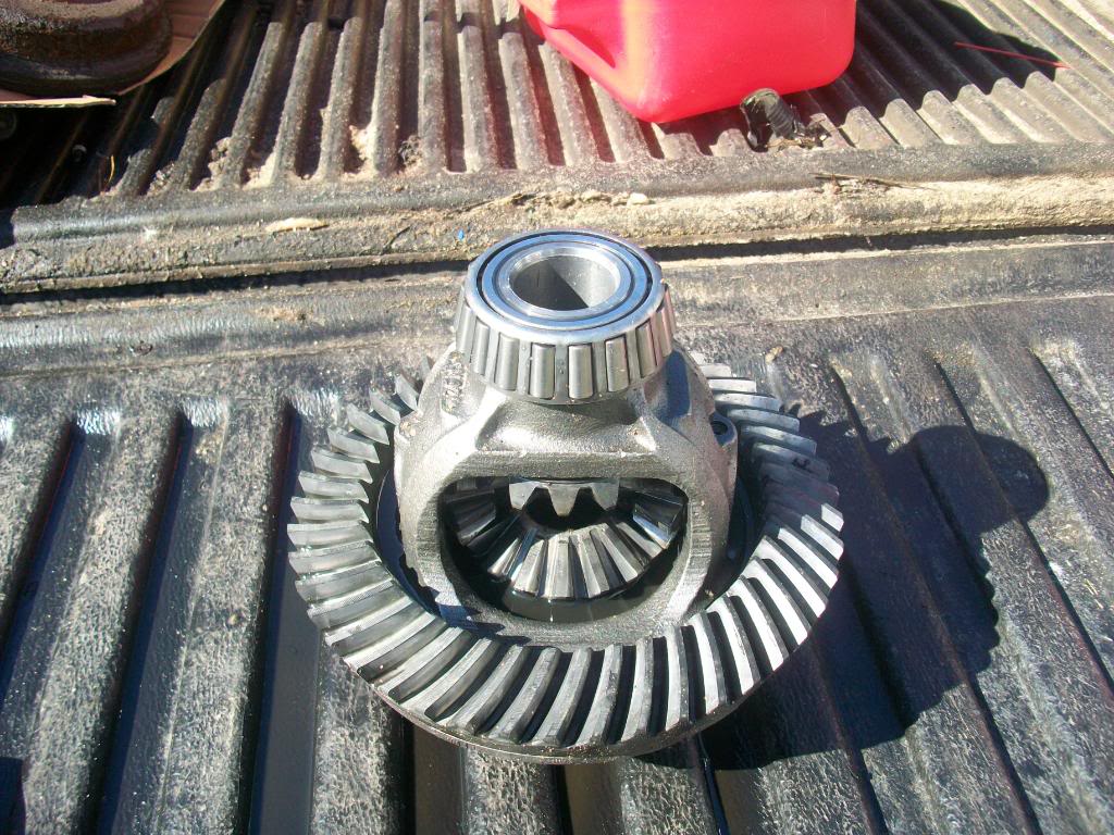

Now you need to take out the carrier. This can be a B!TCH. i had to use my 3/4 in breaker bar with a 3/4in socket and i got the 4 bolts free. they are torqued to around 80 ft lbs. so it can be difficult. BE SURE NOT TO STRIP THE BOLTS. It doesnt have a lot of bite when socket is on.
After you remove the bolts, take off the bearings races.
For the hard part. You need to pry the carrier out. Many people have had luck with a come along. I Used 2 pry bars and muscle and got it out.

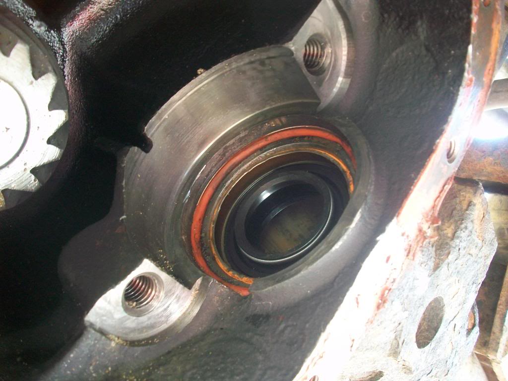

Now you will be able to see the drivers axle seal. use a broom end or something, and go through the axle tube, and knock the old seal into the pumpkin.

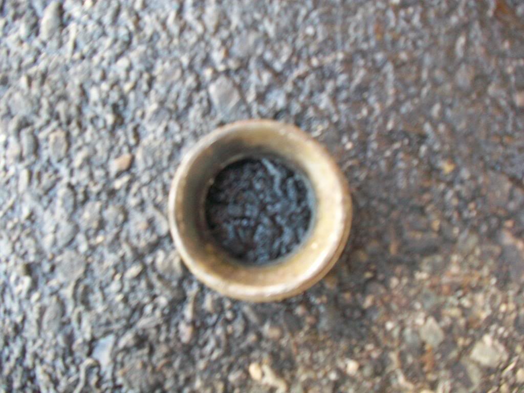

heres the old seal
This seal is easy. I put gear oil around it, and put it in best i could. Then i took my 1 11/16 socket, put it on, and i was able to hammer it in through the pumpkin.
heres the new seal
seal in truck

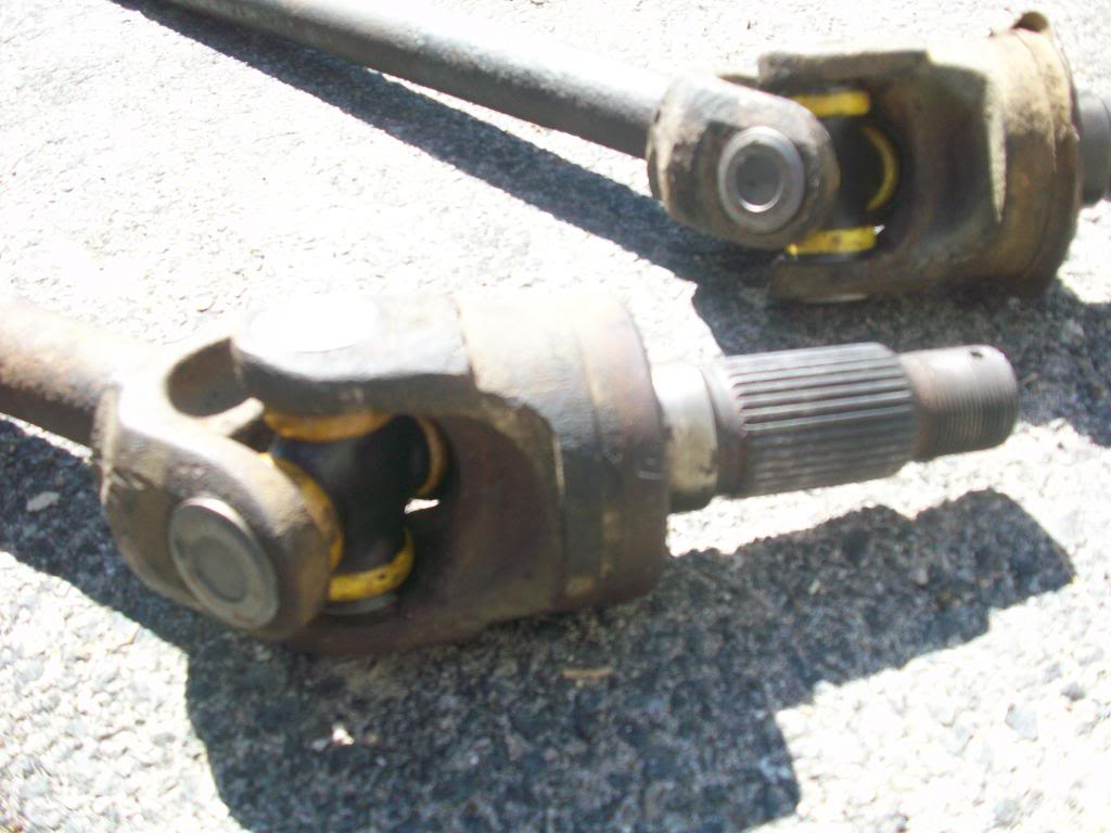

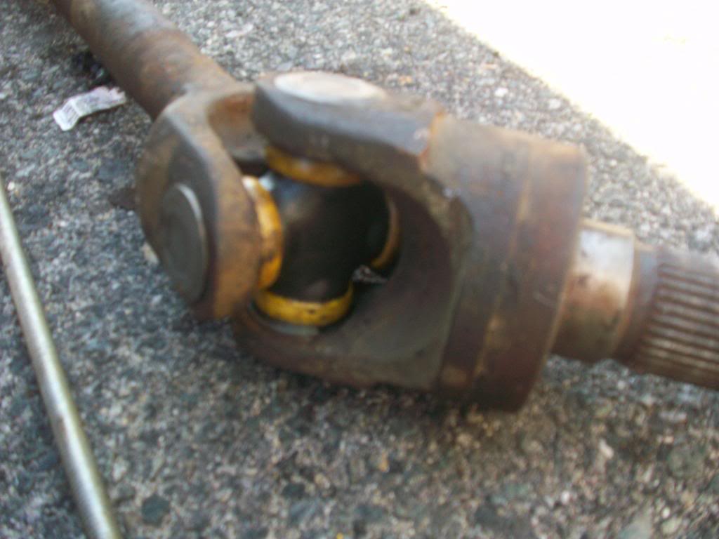

Now i did alot of extras when i had everything apart. I brought my axle shafts downto the local machine shop and they put new u-joints in. cost me around 30 bucks,

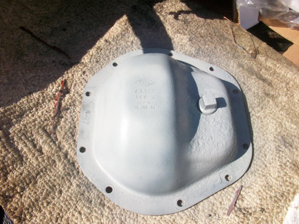

i also decided to paint the diff cover.

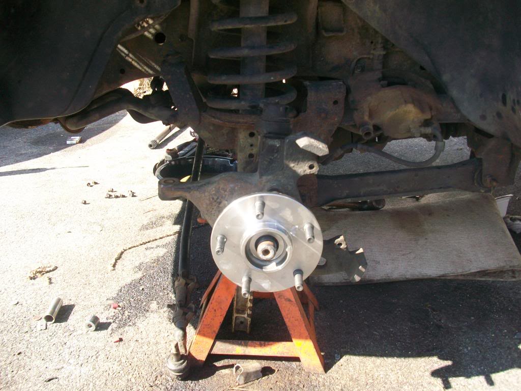

Also new hub assemblys.
Installation is opposite of removal. I hope this has has helped some of you in need of front end work. ANY questions please feel free to ask me. Ive ripped apart my front end like 8 times. I have it down.
