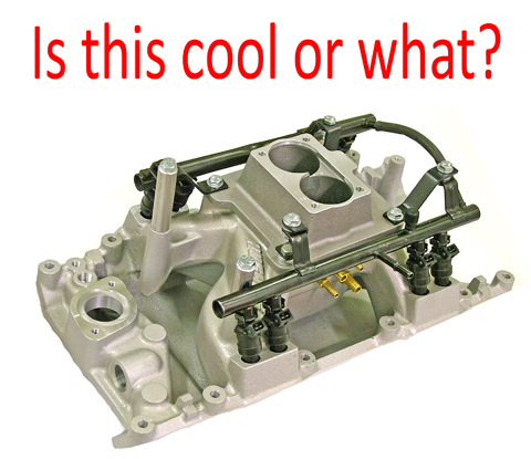

3rd place: Hughes FI Air Gap intake manifold, Hughes Engines, $600..

3- The FI got rid of any concern about a plenum gasket.. It has tentatively improved mileage.. It provides a stronger vacuum signal.. It allows passing much easier than before.. Oh yeah, it eliminates plenum gasket failure once and for all.. I needed to say that twice..
