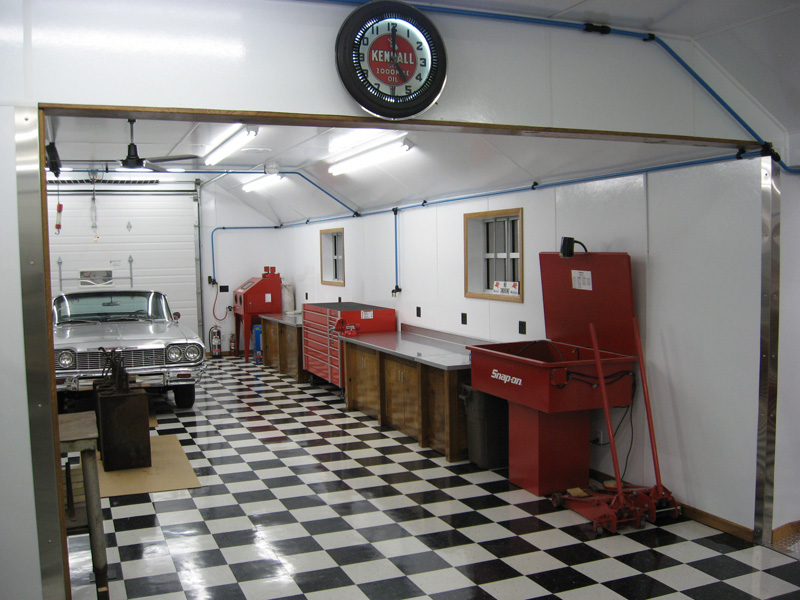

i think i remember seeing something on TRUCKS about plastic air. i don't remember what the stuff was called but remember what it looked like. it looked kind of like this. i was trying to find out because i would like to installing solid airline in my basement and one outside so that i don't have to run my airline out the window every time i want to use air tools.
lol. here is a better picture. that garage is sweet. if i had the money i would have a nice looking garage like this. lately i have been looking at vehicle hoists even though i cant afford one.

For those interested in "that blue pipe", Eastwood sells it;
http://www.eastwood.com/100-ft-rapid...arage-kit.html
Overall, I don't see the problem with dragging air hose around. I'd rather play it safe and plumb everything with black pipe. It's not too difficult to plumb a trunkline with various service branches.
