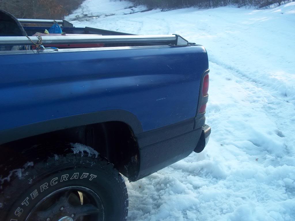

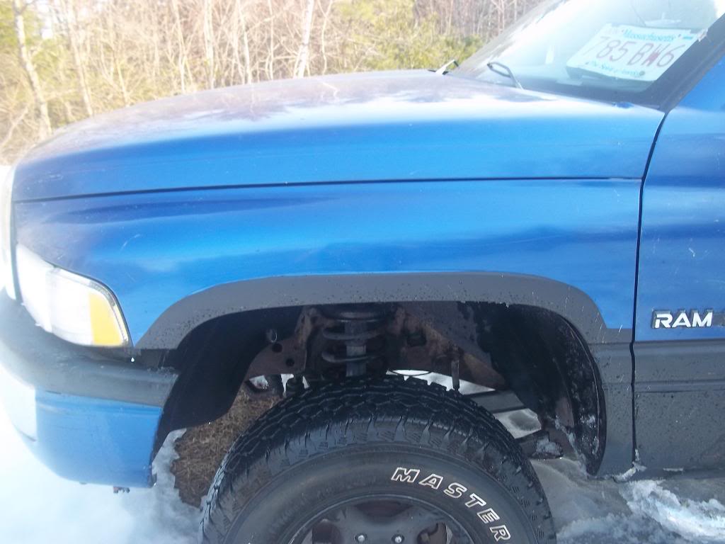

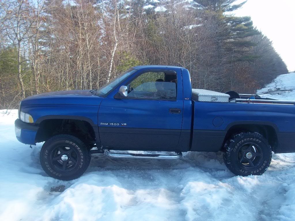

i did the whole lower half of my truck, and fenders (after i fixed the rust spots) with spray-on rustoleum bed liner........i scuffed the surface by handsanding...washed it...taped it all off...primed it with 2 coats....bed liner 3 coats....no offense to the above truck, but mine didnt come out as choppy or thick asthat truck, but it looks awesome, and ive been offroading and kicked up rocks at it and it hasnt chipped...i armor all it, and it looks brand new.....cost me about $50 so far, and half my truck is painted.
the other side is done as well.
