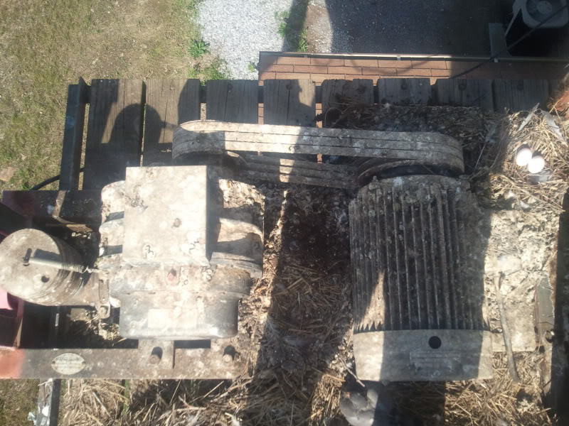

Little update on this
Saturday I was able to get the chief to pull the tower out and set it up so I could get up into the motor box (big square box). Holy **** and I do mean that literally. The thing is full of pigeon crap. There is a couple eggs in there and some small birds that were running around in there that were with a pigeon. Not sure if they are "baby" pigeons or not. You can see the one in the pic. It was all but sitting on my foot. It's gonna need a date with a power washer when it comes down. It's basically ready to come down off the poll whenever my friend with the crane can come by
