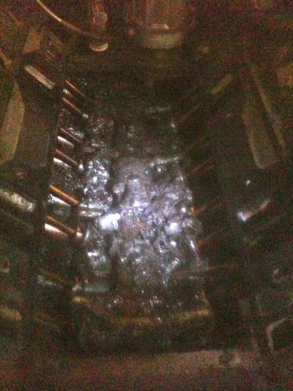

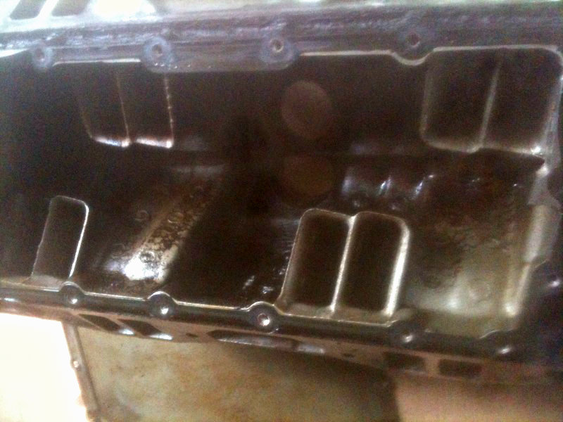

Dropped off my truck at 5 and my buddy called me at 7:30 and he said the valley is open and it was the worst sludge he has seen... Ever! He Said it was neglected as far as oil changes go. He will be popping off the valve covers and cleaning it all out for me. He will be sending me pics, I will post ASAP!
He stopped after pulling the intake, will wait to hear about plenum gasket...

Hopefully he does a good job cleaning it out, you don't want that **** working it's way down to the oil pan, it'll clog up the pickup tube in a heartbeat. I've seen it myself on my brother in law's Hemi, the screen was sucked into the tube a bit from all the sludge at the screen....

Already ahead of you! Picking up oil pan gasket and new oil pump screen. He is gonna drop it and see what else he finds... Clean it all up. Good thing is the heads/gaskets seem to be fine. Gonna go see the truck first thing in am and drop off parts. Ill take my camera for some shots!

Ok, so here is the update...
Went to AZ and AA and neither had a oil pan gasket in stock, have to order it along will the oil pump screen. That is gonna be the next project we tear into. Right now my buddy is gonna concentrate on cleaning out the valley the best he can without trying to shove crap into the cam. It is disgusting what the 2 previous owners did in regards to regular oil changes. Keep in mind engine only has 108K. The pics are rather crappy with low light and my cell, but you can get the picture rather quickly how bad things are. Fresh oil was pooled inside the manifold, so I believe I found where the oil is going.

I also dropped off new valve cover gaskets, he's gonna pull them and clean everything. I guess after we get the new oil pan gasket, we wants to flush it all out to the pan and then replace the oil pump screen, gasket, and close her back up.

Go buy a cheap shop vac and suck that S*** out as best you can. I would be getting new lifters as well.
