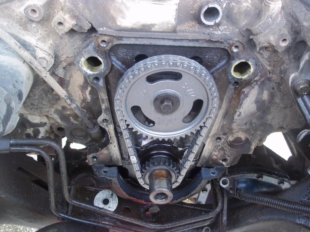

The job is very easy, dont let it overwhelm you, ive done everything your doing....timing chain is easy, you dont need to do TDC....just bfore you take the old one out make sure the Punchmark on the top gear is at 6 o clock, and the bottom is at 12 o clock, thats what i did and never had a problem. and i made sure that the silver link lines up with the punchmark on the top gear when its at 12 o clock
