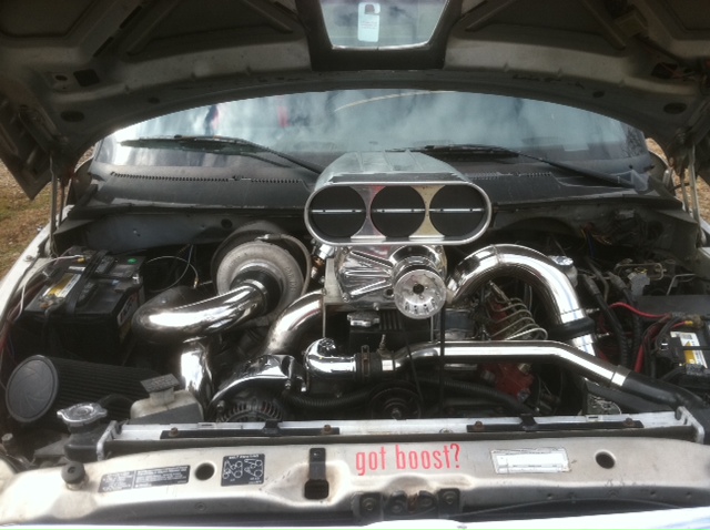

think your idea of triplets is a bit off lol...
triplets are usually 3 identical turbos or 2 identical on top with 1 slightly larger (not significantly larger) on the bottom.
top 2 pull in fresh air and Y into the bottom to re-compress the charge.
whole point is for even faster spool than twins because you don't have a large charger to get moving anymore, and you are still getting the rough if not liberal 2:1 ratio for compounds.
carl ran triple he351ve's (VGTs) on his truck for a while and it was pretty sick!
I wish I had his setup now...its ridiculous!
hes running large compounds AND a supercharger...he's also a p-pumped 24v with 6x18s and has a cam, springs, rings, etc.. his last charger idled at 5psi, think his new one is idling at 8psi lol.
says he ran 13s in the 1/4 without a boosted launch on his old mach 7 injectors.
