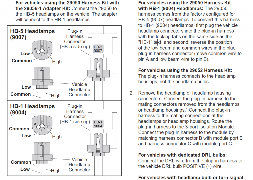

here is the fix for your headlights. i had to do this for my snow plow harness when i bought my new plow in January.

cool redneck thanks, i will take a look this weekend to see what they are and if I can fix. From reading schematic I will not need any extra adapters . i Think mine fall into the 29052 catgory. if that the case they are kind of loosing me with the written directions, i will have to take a look to see.HB-1 or HB-5 label should be on the connector that is stock with the truck correct?
thanks everyone for the welcomes and insight.
nah you dont need to go by the written instuctions there, those are for a snowplow wiring harness. just use the picture for reference. the headlight wiring should be swappable, they just use locking pins. simple easy fix.
