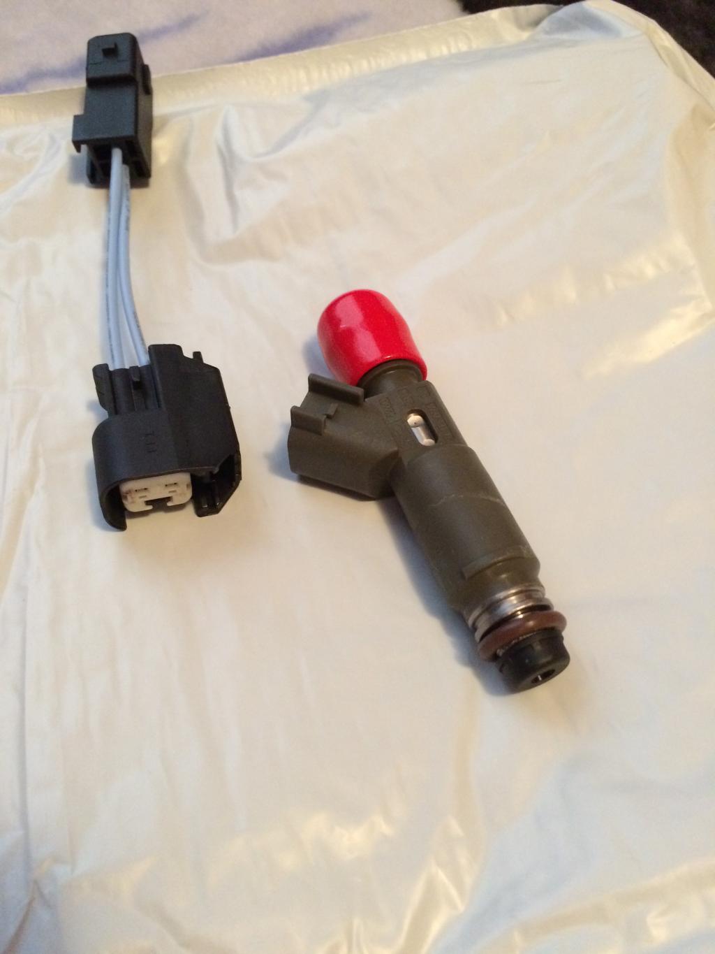

Installed some 4 hole injectors from flame thrower injectors. Seems to idle better. Hopefully they get me a little better gas mileage too.

I was happy with the change to 4 port injectors... I don't know that it effected MPG greatly, but definitely smoothed idle, and played well with the other mod's.

How much did those run for?
