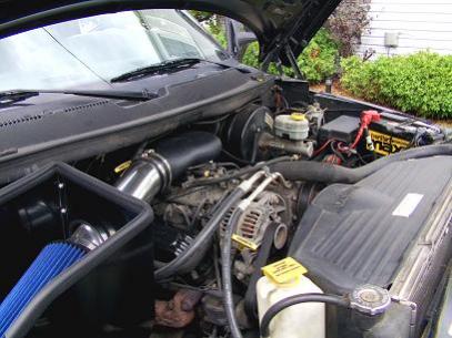

-Air filter box was cracked and in need of a new filter as well, so I just went with a Spectra Ram Air intake/filter (give the engin bay a little bling).

-In the middle of replacing all 8 fuel injectors now. It has to crank for a minute to start. I have ruled out that it's the fuel pump, regulator, relay, or temp sensor causing this. The truck smells of gas when it starts so my next guess is I have a bad injector that leaks out when the truck is turned off, Ill give an update once finished.

It's a nice looking truck, but how many miles do you have on her, engine, 4x4? Expect to have to replace the intake plenum plate and gasket at some point, as that tends to be a point of failure and excessive oil consumption (that is, if it hasn't already been replaced, as the OEM was steel, whereas the fix is aluminum and that can be told by a telescoping magnet down the throttle body to the bottom of the intake, as well as looking to see if you can see oil pooling at any point down there). For all of these trucks' faults, they are great trucks to work with, so welcome to the fam I say

It's 4x4 Sport with the 5.2. There was some discrepancy on the milage as the cluster had been replaced/fixed, the odometer reads about 107k but we estimate between 120k-150k actual. I have read up on this plenum issue, maybe tomorow if I get a break in the rain I'll go take a look. Thank you for the heads up.

They are great trucks! You can't kill the damn magnums
Anyway, fix your plenum and put a double roller timing chain on it while you're at (yes yours is stretched at whatever miles it has)

Thanks glad to be here I really am enjoying the truck. To give an update on the starting issue; I replaced all the injectors today and that solved the starting problem. Truns right over
While the throttle body was off I determined that I do still have the stock plenum in the truck. It did however look fairly clean down there, a little bit of oil stain near where the PCV valve vents, definatly no puddling or even enough to get on my magnet. I think for now I'll just leave it till I start to notice any issues, or symptoms. I'm glad to know what to keep an eye out for. Thank you DF.
