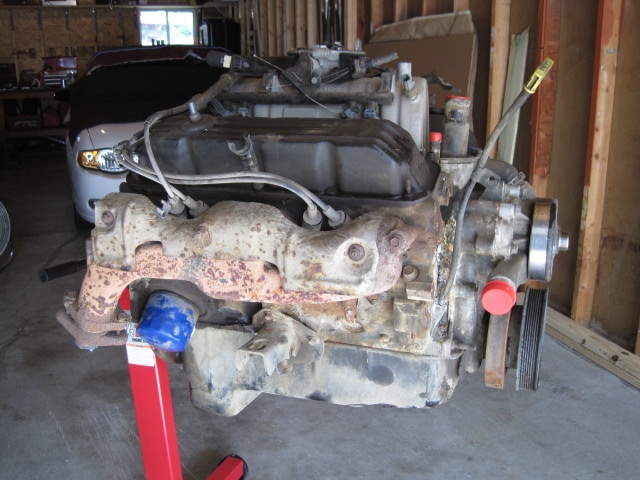

Does anybody know off hand how many bolts and studs there are on the exhaust manifolds? I have 10 bolts and studs, I'm missing two and I'm not sure which ones they are. I'd also like to know if anyone has the location of the bolts/studs also, I can't find anything on Google or FSM (maybe I skipped over them) I'm able to keep my headers on my new engine and I'm getting new bolts for them. Any help is appreciated

Stock looks like 6 bolts and 6 studs. I don't fully understand what you are doing. Can't you just use all bolts with your aftermarket headers? I thought the studs are just to hold the heat shields on. Here's a picture I dug up that shows stock:
