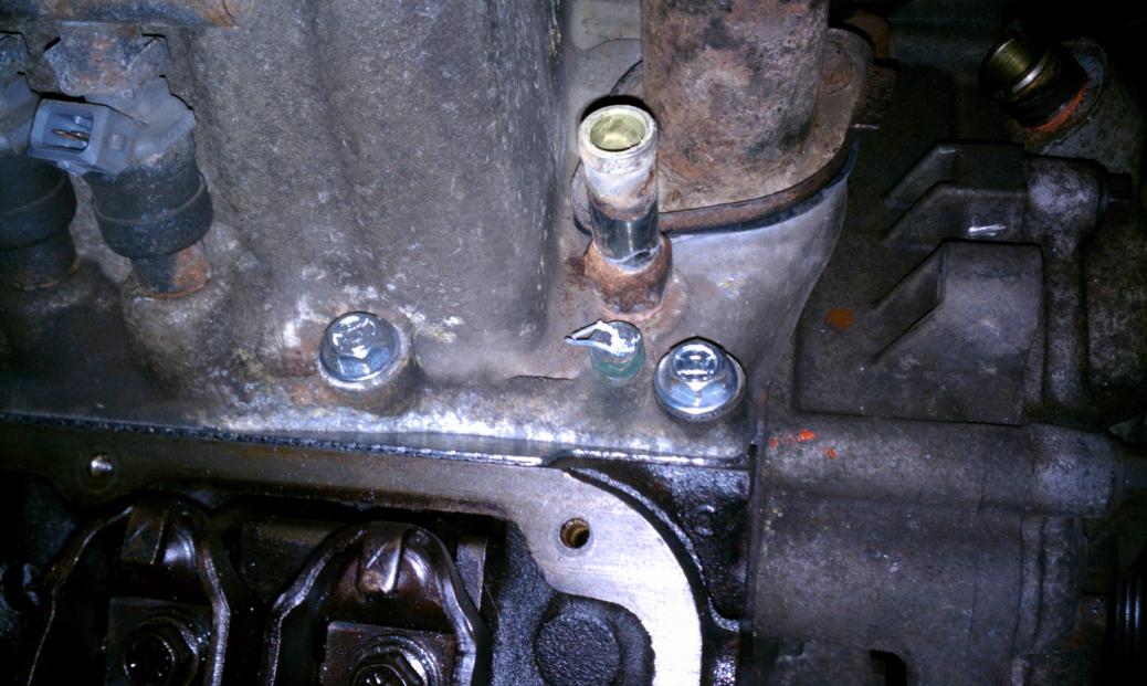

What is this broken thing on my intake manifold?
Thanks for the help!

Broken water temp sensor. Should have a small plug with two wires going to it laying around somewhere too.

yep coolant temp sensor, about 10 bucks at autozone

Thanks! I knew it was simple but I didn't know what to call it so I couldn't find it. I search for diagrams but could not find one. Modern technology... I like the old books in the old auto parts stores...
