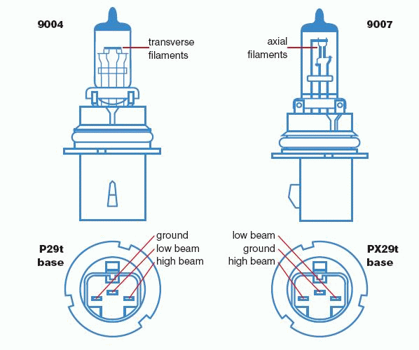

Originally Posted by Ham Bone
Relay Setup built.
Faintly lit is the dash light.
Did not replace bulbs? Does that matter? I used Jason's write up in the diy section as a Guide.
It seems very, very likely that you've got a miswire there. If you're wired for 9007 lamps but have 9004's, or vice versa, you'll get the dimly lit high beam indicator when low beam is selected. I've got to get on the road fifteen minutes ago so I don't have time to dig into the schematics to puzzle out the fog lamp involvement, but it seems a good wager that correcting the miswire will fix that, too.
A voltmeter, or even just a light-up probe, and the drawing above should be enough to get you going on the path to puzzling out the problem. You should see battery voltage from the ground pin to the low beam pin when low beam is selected, and from the ground pin to the high beam pin when high beam is selected. Don't measure from chassis ground -- measure from the connector ground pin.
Ok so the low beams are wired like a 9004. But when I switch to High beams it's running as a 9007?
So I have my high beam wire and my ground switched?
If you've managed to wire correctly for 9007's then all three are wrong, but if you've wired something else the only way to know is to measure voltages. Just moving wires around would be kinda silly -- there are six permutations, so there are five left to try.
What I'd do would be to unplug both headlamps and measure to see what's where. You can use an ohmmeter or continuity tester to find the grounds, since they're tied (or at least were, originally, tied) to the chassis. That just leaves you two wires to sort. Turn on the low beams, and see which of the two remaining pins have battery voltage, and that's your low beam conductor. Just to confirm, pop the high beams on and ensure that you find battery voltage on the remaining pin, and nothing (open circuit) on the one that you identified as low beam.
If you don't have a multimeter you can get by with a test light, if you're careful not to create any shorts that will open fuses or smoke conductors or connector pins. Again, unplug both headlamps, and put the low beams on. Hang the ground of the test light on a good ground, and find the low beam pin. Then turn on high beams, and find the high beam pin. The one remaining is your ground. You can confirm by hooking the test light ground to the one you've identified as ground, and probing the pins for low and high with the corresponding function turned on.
Though you don't absolutely have to do the final verification step in either procedure, you should go ahead and do it anyway. I would, anyway, even though I've got many years of professional experience futzing around with electricity. Ya just never know when a thinko is going to happen, and the verification step will keep you from getting bit too hard by it.

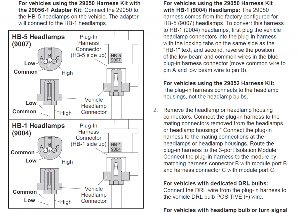

actually, that wiring diagram is completely wrong... having had to install my plow wiring harness when i bought it, i have the correct wiring diagram.
to make things easier for fisher, the vehicle light harness is set up for 9004, and 9007 bulbs, but its prewired for 9007 at the factory.
here is the correct harness wiring diagram, and what wires you need to move around.
edit: you have the pinouts backwards on the 9007 bulb.
Good catch! I didn't scrutinize the image the way I should have when I borrowed it from some random web site.
I apologize to all for my carelessness.
