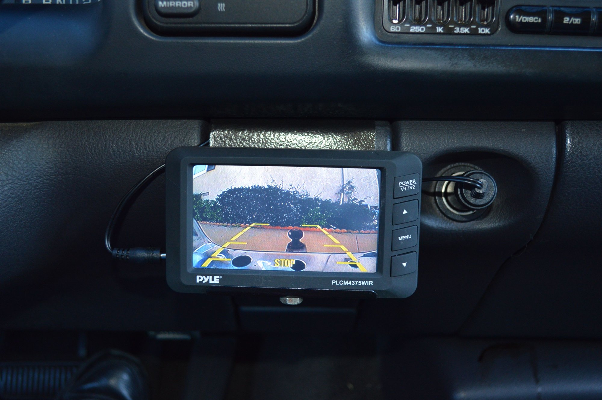

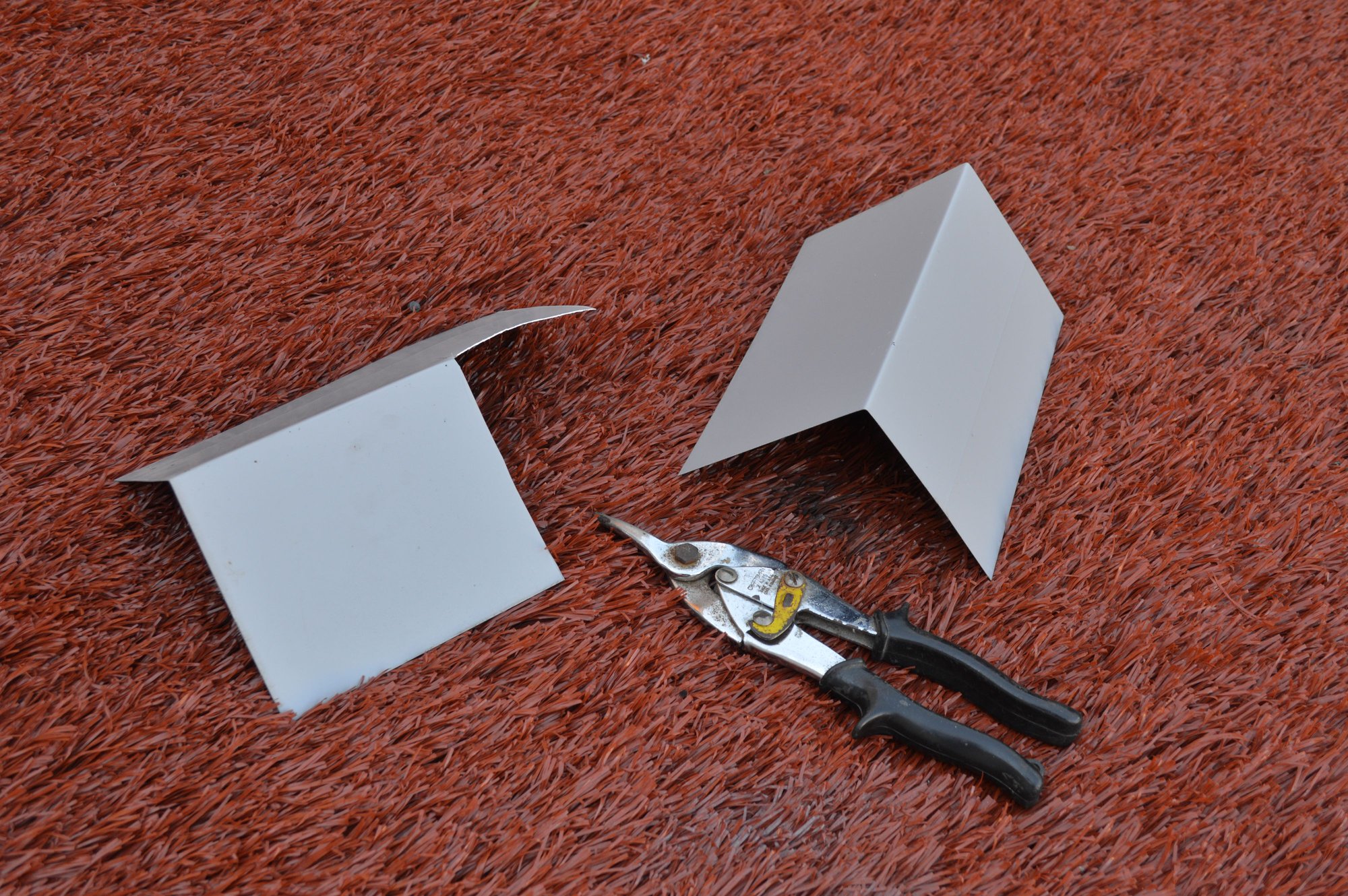

Needed camera for using boat trailer but had hard time finding place to mount the monitor inside cab, ended up making bracket fron piece of tin to fit over that whatever compartment next to lighter. Monitor mounted to bracket but bracket fits over lip of compartment door and can be lifted off to be stored out of sight.....works for me and maybe could help someone else having this problem. Just bought this truck so having some fun playing and figuring things out on it, now if I could just get some sound to come out of speakers. Oh, one more thing, I painted bracket with black hammered finish paint and it matches rest of dash.

Except for back-up camera there is no kit. Bracket was cut from a piece of Home Depot flashing, bolt was cut down from 1" to about 1/4" to mount monitor onto bracket.

Thanks, also the extra pic's help.
