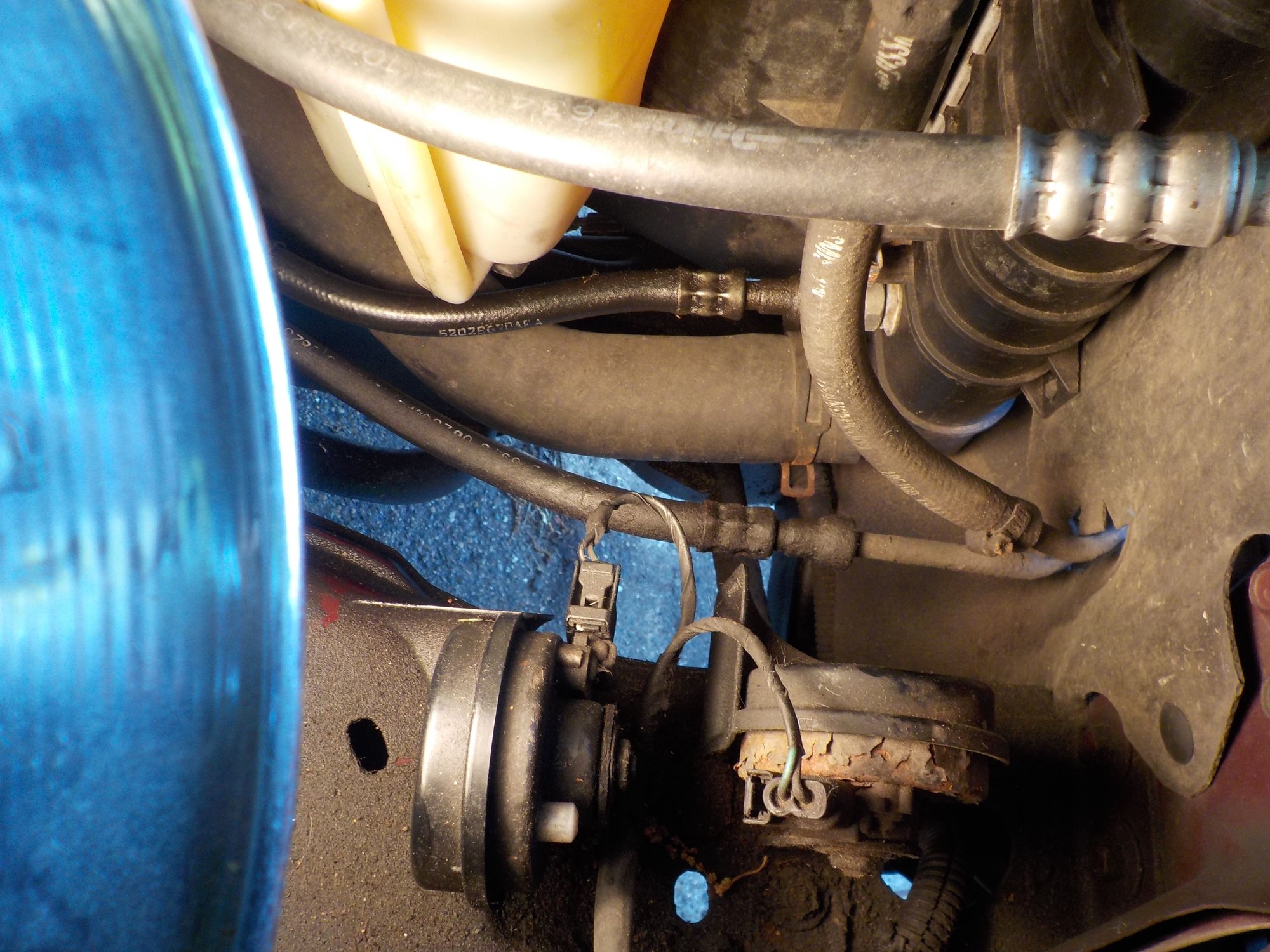

its leaking where im pointing . notice at end of steel line the line has a ring that the rubber line fitting butts up to . and at oreilly and autozone they dont carry thee exact rubber hose to replace this so im wondering if somebody could provide me a link to the part i should buy ... i can buy that top line in the top photo , but not the bottom line ...

so i decided to remove original tranny cooler line and bought new full length replacement which is L shaped and about 4' long running from drivers side of tranny around the front of engine then forward to the passenger side of radiator . now i see its near impossible to thread this line into place . so im wondering is there a certain path to thread this line along ? ive tried starting from the front threading line to side of trans and thats near impossible . also tried starting at side of tranny and threading line forward and there aint no way thats happening . so im wondering what others have done ?
