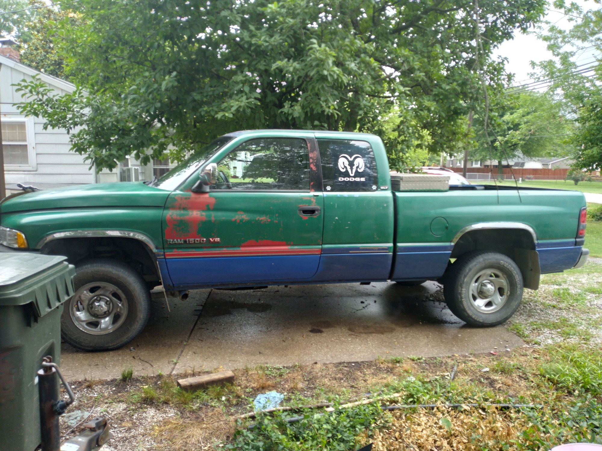

I picked up a new, to me, truck yesterday. It's a 1996 Ram 1500 4X4. The GMC will head down the road shortly. I just prefer the Chrysler layout on mechanicals. The old girl needs a lot of attention.I drove it home, then rented a trailer to get my car home. About 160 miles total. A bit interesting with some major slop in the steering, and it has a leveler kit on it. Add a car on a car trailer and my headlights were searching for possums in the trees.
It came from the factory blue, then the previous owner bought several rattle cans of green. Then he replaced the door with a red one and the green paint didn't stick. One thing about the paint job, I'm not getting cut off in traffic. I'll eventually paint it one color. It'll either be green, blue or black. Rural King has a lot of John Deere green cheap. The old girl runs great and has a rebuilt transmission. I think once I fix the front end, it'll be a good driver. The dash is one of the worst I've seen, but it's amazing what a hot glue gun, pop rivets and gorilla tape can do..
