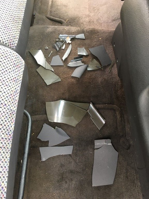

When Neighbor Mechanic was over this morning looking at my steering issues, we looked at the HVAC problems also. It blows freezing cold or Hades hot, no in-between. I plugged the broken cruise control line to make sure that vacuum leak wasn't causing the bleed door diaphragm to not have enough vacuum.
Since the dash top and instrument bezel were already loose, and showing massive amounts of clear silicone caulk around the edges, I carefully lifted the top off. It appears that skins were glued to the remaining original dashboard. I found a number of broken pieces down inside the dash, some with the caulk and some with no adhesive on them. I'm guessing that this is a common method of hiding the broken dash?
Now I understand the difference in the two dash tops and bezels, p.57 and p.59, in the LMC catalog. Unfortunately, it doesn't appear that there is enough of the original dash left to attach a new pad and bezel to. See pictures. When my wife sees it, there's going to be a massive aero-fecal interface blowing in my direction.
loose parts from inside dash not attached to anything
I'm surprised no one has made metal dashs to mount your instruments and controls to.

Having done a new dash top to mine I can tell you there is plenty of dash left to install one. The bezel doesn't support or hold any of the dash together and there looks to be enough mounting points along the bottom and sides to install one. You might need to use some double sided tape or something along those lines for the top edge, but it will mount and look better than what you have. Be very careful removing the rest of the top so as not to damage any mounting points.

Mounting points are gone, You need a new dash and not a dash cover(band aid). LMC has them but this place guarantees them for life.

Installed the dash pad and bezel yesterday 7/10 with the help of my mechanic neighbor. After dashboard assembly had been removed to replace bad AC evaporator and heater core "while you're at it," there was even more of the underlying structure was damaged, thus less to work with. See "decisions, decisions" 6/24/22 post for the gruesome/sordid details.
In a procedure akin to the process of making sausage, as the saying goes, "you don't want to watch it being made, but the end result tastes good", we pieced together the structure enough to hold the dash pad and bezel. Took us eleven hours from pulling into his garage to picking up dash crumbs from his garage floor before I left.
