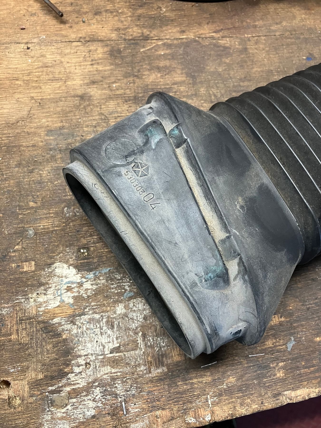

Intake tract as it connects to both inner passenger-side fender walls:
The dashed green line is where the intake tube stops against the fender wall, with the channel to the left the part that "snaps" into place. Well, that green line section, part of the molding process, is its own internal channel, which is perfect for placing some mesh to self-secure/locate.
Obviously this inner channel's dimensions are larger than the opening, which presents a sort of ship-in-a-bottle scenario. I also seem to remember there was a larger mesh here already, but I could be mixing that up with something else?

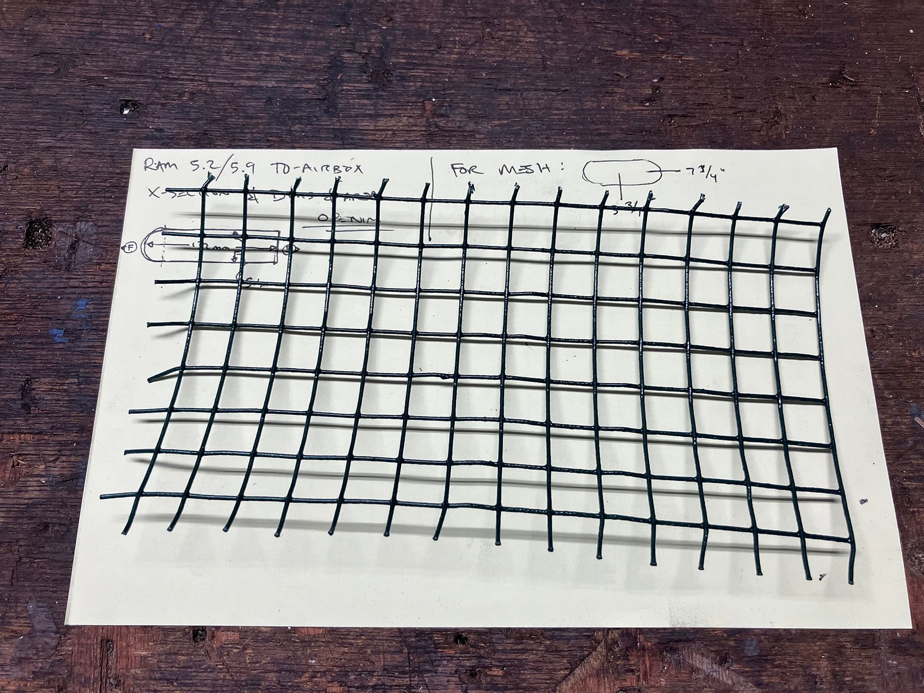

Mesh Time. For about $12, or $23 if you want the accidentally-paint-matching vinyl-coated version, you yourself can get a huge five foot roll of 1/2" steel/wire mesh. So much left over for garden and pet activities! :lol:
The absolute size of this inner channel is 7 3/4" wide x 3 3/4" tall. The channel is shaped like a track oval, with both left and right radii being just under 2".
I "over-cut" by a 1/4" or so to give myself extra material to work with:
The extra material was cut down, still slightly oversized, but with "prongs" available to dig into and anchor in the channel.
Radii are cut and everything is ready to be semi-awkwardly (yet carefully!) partially-folded and slipped into the intake tube (from where it secures to the fender wall):

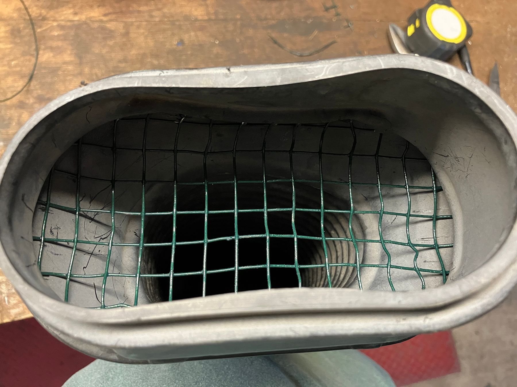

The other two tools are a bench vice for gently (gently!) holding the intake tube steady as well as a long narrow stick or shaft of some sort (end of a broomstick, 1" wide PVC pipe section, cardboard poster container, etc). My chosen implement was a fireplace poker with a 90° bend at the end, which ended up being great for pushing more mesh around at once plus working the corners/prongs of the cut mesh into the inner channel.
Let it be known that this is a fidgety and imperfect process. This was me partway through.
This is the final product, which I would argue doesn't look at pretty as the in-progress mesh, but nevertheless, all the "prongs" and mesh in general are extended to the furthest points in that inner channel, and I was able to add some (thick/gel-type) super glue to a number of points to provide additional security. Even before then, giving a decent push on the mesh resulted in that mesh simply flexing but not moving position.
The only potential issue this solution has is that there is a 2"-ish section where mice could set up a fruit stand, and that stuff could find its way into the tube. So I'll have to check here soon to see how that goes and report back. Hope this helps. Thanks for reading along!

It may not stop them. A small mouse can get its head through the squares. If they can get their head through, they can get through. The skull is the only really solid bone in their body. The rest is mostly cartilage..

I realize there is a semi-futility here, but I/we do our best. If there was a vertical access point for the air, tall enough and perhaps slippery enough that mice couldn't get in (or get in nearly as easily), that would be better. Better still would simply be having the air filter unit be the gatekeeper to the whole intake operation. I know cold air (or "cold enough air" as I say sometimes) intakes provide that solution, but the issue for me there, aside from the yuuuuuge intake box/conference center on the passenger side of the engine bay, is that the companies will just put a simple mini hat right above the throttle body, which does not make for ideal airflow IMO. Maybe the super low hat 'ceiling' is fine and I still don't know anything, but that's the next area I'll be tackling pretty soon now.

A wire mesh over the wire grate should do the trick and not reduce air flow much.

I had considered the mesh as a solution, but wondered about airflow restriction. Just checked the truck after over a day of sitting. So far so good--no trace of any mice or debris. Still parking near the field as before.
