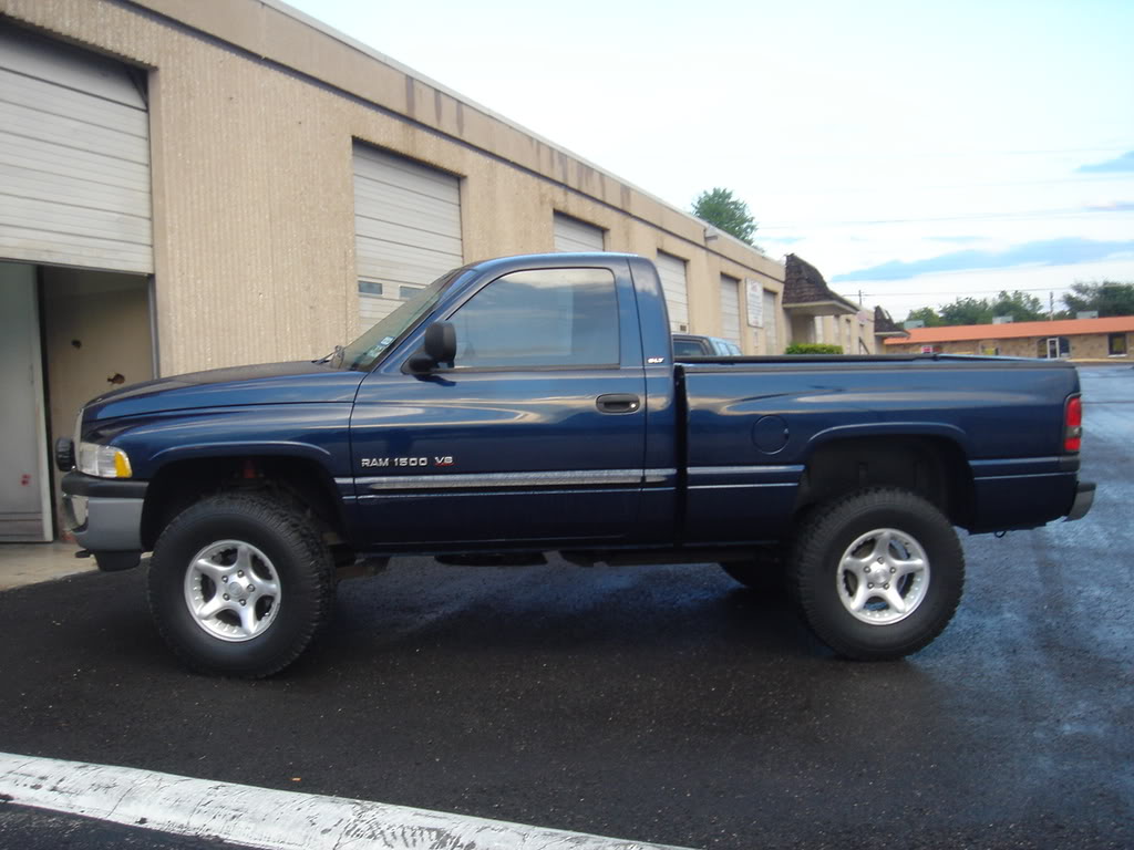

I have a 01 4x4 Off Road single cab short bed and i want the front to be level with the rear as most people do.
Should I just install a 2" leveling kit or should i run the 3/4 springs?
Right now it sits on 315/70/17 BFG ATs with KYB Monomax shocks. Its kind of a rough ride but it smooth on the highway.
Any help would be great.
Mark

2 inch spacer, unless you want a rough a** ride, 360's dont way as much the cummins

The 3/4 ton springs should be as tall as your springs right now give or take a half inch. They arn't gonna help. Some people perfer hats ontop of their coils, others prefer new springs. You would need to find1500 coils that have a4" lift if you went new coils and if you want some quality hats, I would look over here. They just lowered their price $4.

I have a 2" leveling kit already, so it sounds like i just install it this weekend when i do the front brakes.
Ill post some before and afters..
Mark
