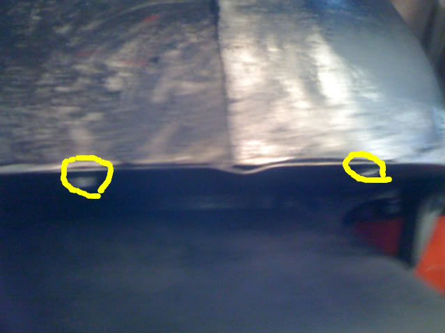

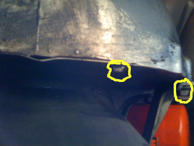

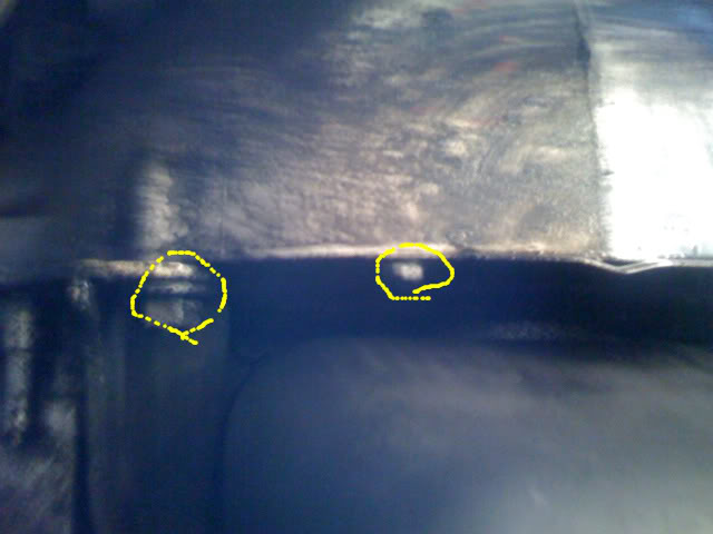

Well I didnt actually unbolt the plate here, Im not sure about how many bolts to unbolt? Im posting a few pics I took while under the truck, Do I undo the lower tranny mounting bracket to remove the inspection plate as well?
here are the pics :-)

Old Apr 16, 2008 | 03:43 AM

Old Apr 16, 2008 | 07:12 AM
dhvaughan's Avatar
dhvaughan
Joined: Jul 2006
Posts: 12,204
Likes: 10
From: Gainesville, Ga.
Default RE: Rattle Noise
yes those look like the right bolts for the inspection plate, also the engine to transmissions braces, also the starter. tranny mount doesn't need to be removed.
spark knock generally will not occur in park. it occurs under load, like when going uphill.
