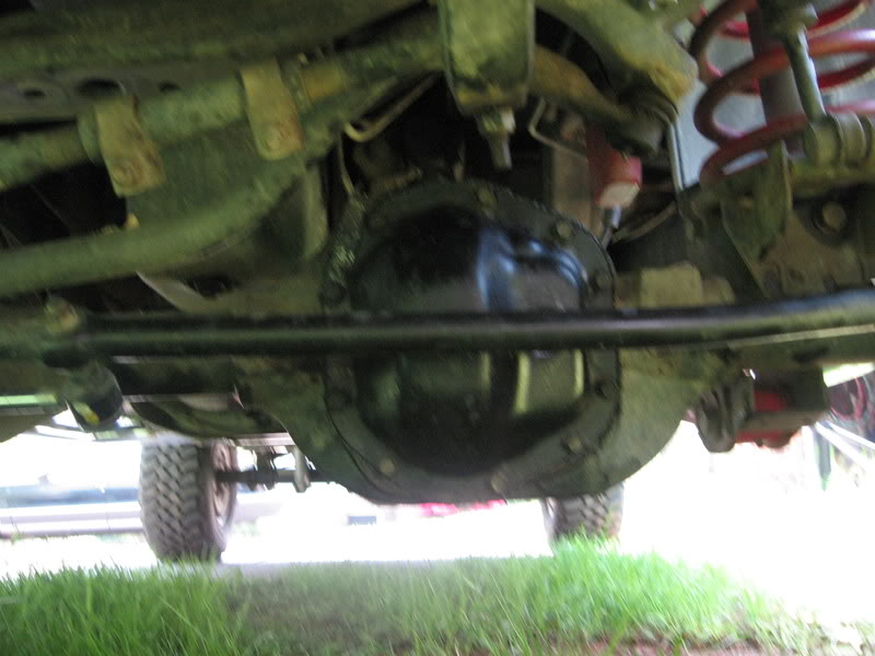

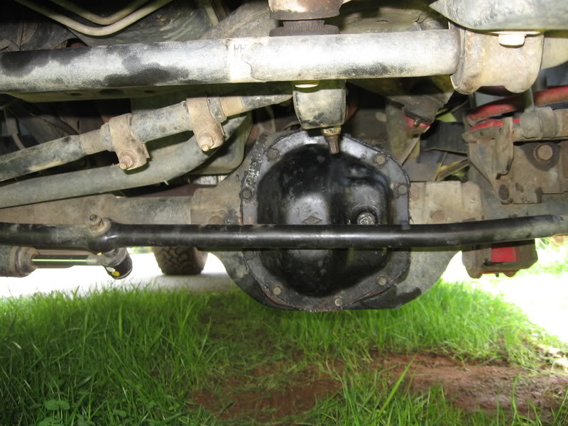

ORIGINAL: rabbler
Have you got a pic of your front axle showing the trussed up area?
I don't remember seeing that before.
Let me see if I can find one. If not I may have to go take one.
Old Apr 24, 2008 | 12:45 PM
hometheaterman's Avatar
hometheaterman
Joined: Jan 2005
Posts: 4,268
Default RE: Several Stupid Questions
Here you go. I went out and took this
Here is a comparision I found searching on Pavmentucks.com that DJ Gaston did.
Offroad Edition
Regular Non Offroad

****, I never knew the offroad editions had trussed axels. That would have been nice. A trussed dana 60 would have been nicer... but still
