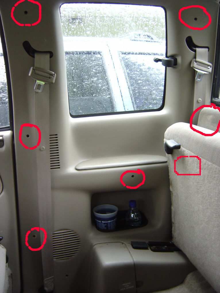

i want to change out my back speakers in my truck. i dont have back doors and i dont know how to take the panels off. can anyone help?

well i just did thing about a month ago.
1..frist take out the back seat,yes the whole thing
2..flip up the seattheretwo bolts on each side "4 altogether"
3..then theres about 7-8 screws on each panes take them out.. 4..then the screws on the threshold,just the2 close to the panel
5..youdont have to but unboltingthe seat belts front and back ones...makes it easyer
6..then do the other side
7..and have fun!!!!

i didnt see anyt screws or anything. i dont wana just pull on the panel and break it.

ok there you go sorry it took so long... the some you will see when the sit is out hope it helpsName:  truckss-1-1.jpg

yeah except my back speaker is under the window and i dont have those screws. i have a 99 sport idk if that changes things
