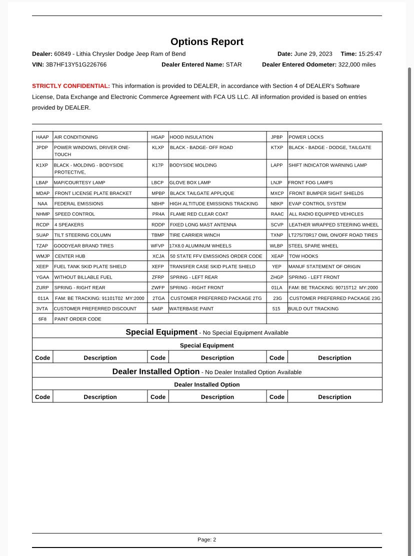

i dont have the off road package, i know that. i have the 3.55 gear ratio that was in the bulid sheet. i have the hd service group, just not the off road package. i was just is your spec sheet suppose to be prvite? or can you share it?

i just wonderin on how close my truck was to one thats all. i figured out i can add spacers in the front to raise it to level it out right? i just wanted to compare my spec sheet to somebodys elses that had the off road package thats all. thanks for you help i apprecate it!
