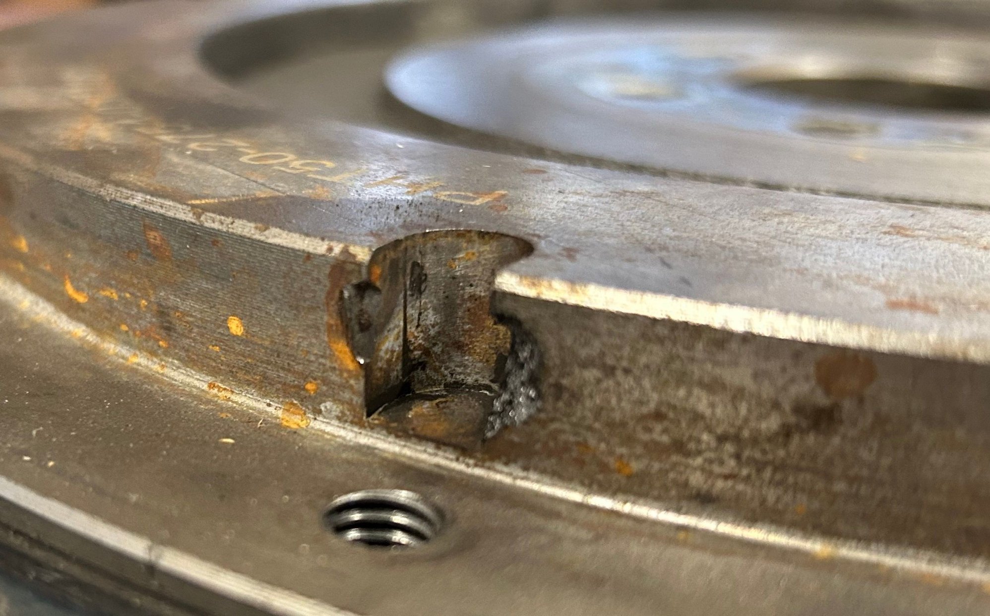

Been chasing a rough idle on my 98 ram 5.9L for the past month. Installed a stroker kit over the summer and was in the process of tuning the engine through FRP when the problem started. Thought it was related to the tune but found out otherwise. Pulled the timing cover multiple times to verify marks and installed 2 different timing sets. Replaced fuel pump and verified no vacuum leaks. Replaced MAP and IAC sensors, replaced crankshaft sensor twice and camshaft sensor 3 times thinking the aftermarket sensors were defective. Changed coil, wires, plugs, new distributor, intermediate shaft and bushing. Replaced computer and still had fuel sync signal jumping between -5 and +20 with rough idle. Replaced the K13 personality key on my MT2500 scanner. Ordered an entirely different engine wiring harness and was in the process of installing when it dawned on me to check the flywheel.

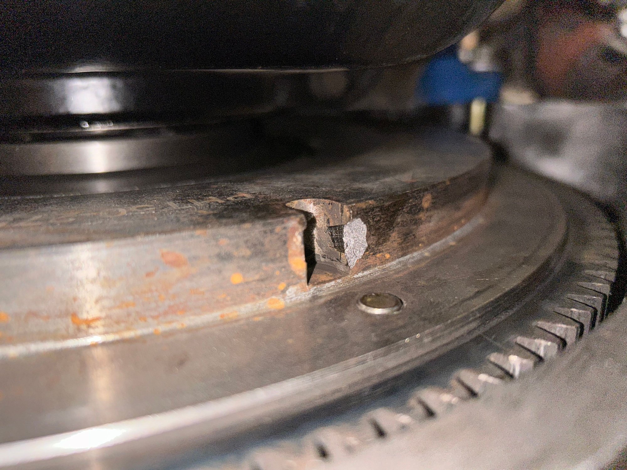

Prior to the rough idle, I stripped the crankshaft bolt and had to use a 3/4" drive with extension bar to remove the cross-thread bolt. This was a tremendous amount of torque on the crankshaft, and the only way I could brace the engine without damaging pistons was to lodge a steel pin in one of the tabs on the flywheel and let it catch on the transmission housing. Truck is manual, so it has a nice think flywheel. At one point I remember the pin kicking out as I was putting my full weight on the extension bar to turn the bolt. I didn't think much of it and rotated to the next tab to get a clean bite on bracing the engine. This is what I found when I dropped the dust cover.
Damaged flywheel where crank position sensor rides.
Closeup of most significant damage

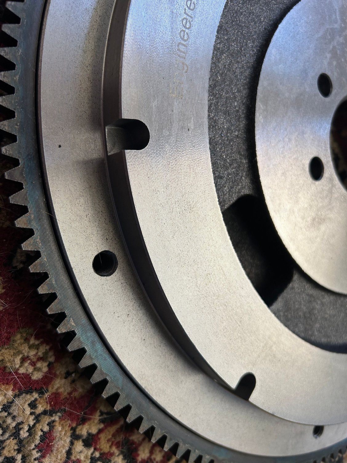

New flywheel and what the tabs should look like.
The tab damaged the most was widened by 30 - 40% keeping the crank position sensor confused at all times. With the new flywheel installed, engine fired up immediately and has never run better! Fuel sync is dead on and does not drift. Wanted to share this scenario for others dealing with idle issues to consider.
